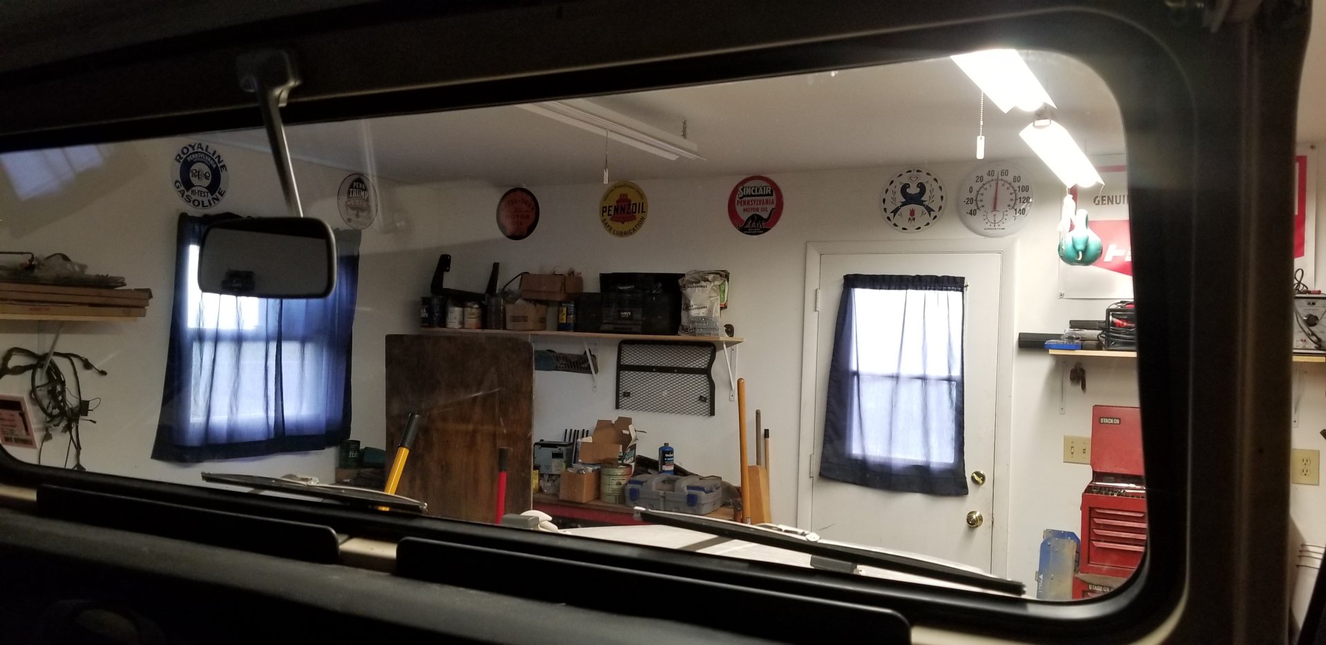

had a weekend unexpectedly show up, so decided to stop procrastinating on a long standing complaint....fogged windshield needed some attention, and so it received it...now its clear as ....well, glass.
So did you put in a whole new windshield or is there some way to actually defog the glass?
Remove & replace
Where did you find the windshield? Didn’t know if there was some magical way to defog but mine is cracked and foggy as well. It is somewhere on the priority list.
a local glass and mirror place cut it for me. i gave them another windshield to use as a template. paid $120 or something like that 1.5-2 years ago for it, ive been sitting on the project for while.

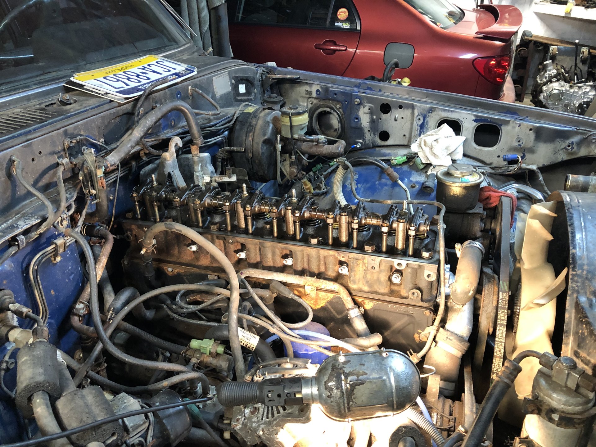

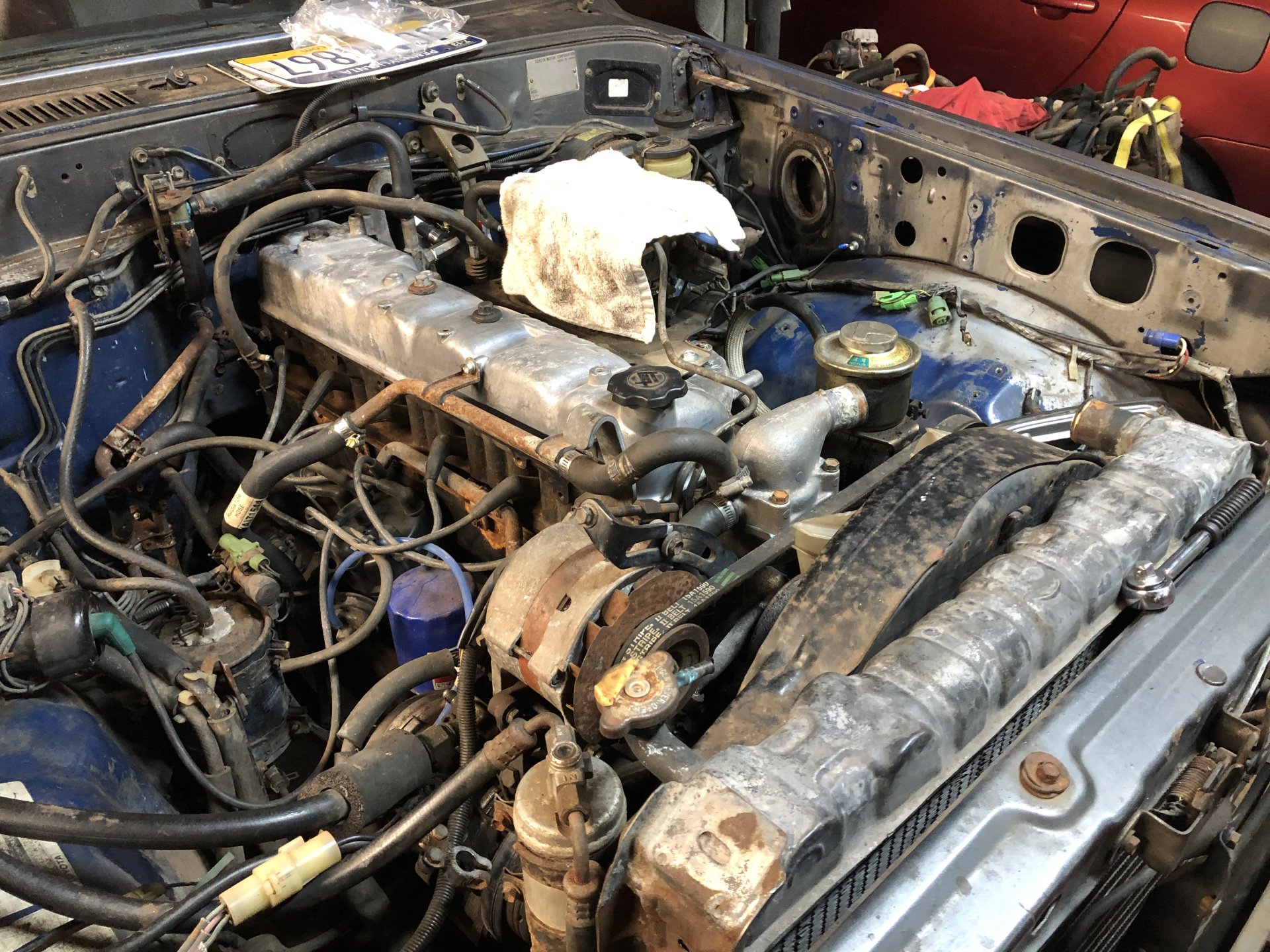

Been working on an 86 FJ60 I bought a few months ago from a post here on Mud and a referral from one of the club members. It was a two for one deal. I parted the rusty 60 and it is long gone. The one I've been working on came from California, was shipped here without a carburetor and sat for 15 years untouched. It was full of junk and took me awhile to get it all cleaned out. Body and frame are virtually rust free except for the front floors just inside the door openings- the front windows were left down slightly and water that got in there rusted the floor areas. No rust anywhere else except for the rear corners of the hood (????) and one small spot on the tailgate.

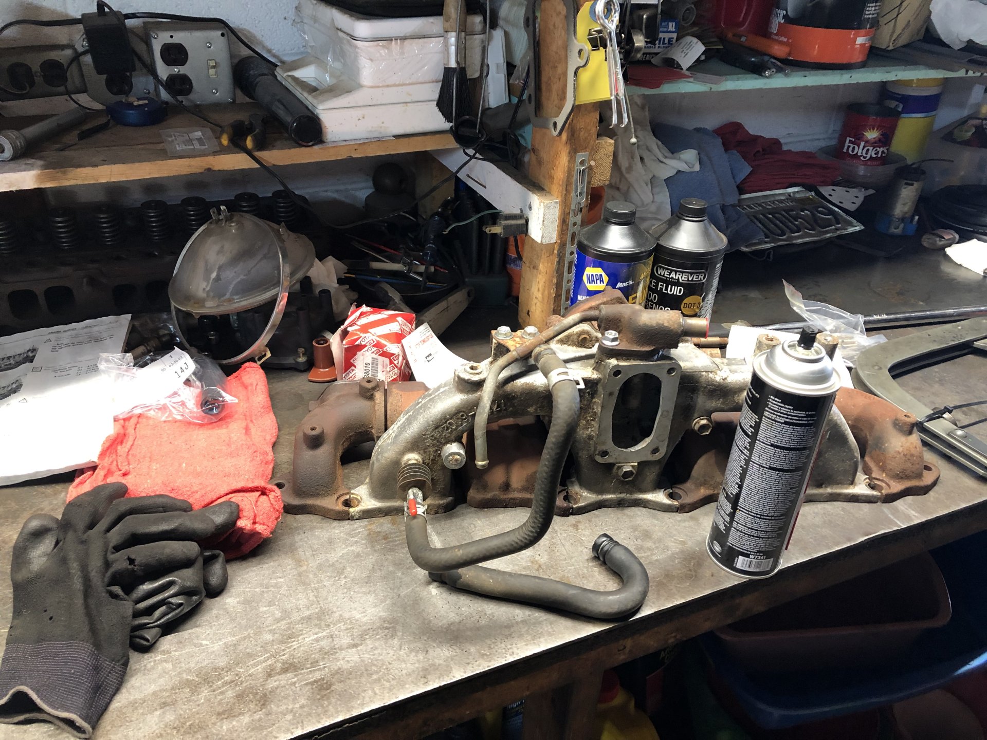

Anyway I cleaned out the intake manifold as good as could it was filled with twigs and vegetable matter. I considered removing the manifold to really clean it but decided not to as it is quite the pain in the ass on a fully smogged 60. Popped a known to be good carburetor on it and tried to start it- no go. Checked spark, has decent spark but won't light. poured some fresh gas in the carb and still no go. Checked compression and found two cylinders with ZERO! My worst fears realized I decided to remove the head and see what was going on, and I had my suspicions. Long story short(er) there was junk between several valves and their seats keeping the cylinders from building compression.
Drove down to John Merkey's place and borrowed his valve spring compressor (thanks John), removed the valves one at a time and cleaned out the seats and valve faces. Lotsa s*** in there. Yesterday I installed the head using an OEM gasket ($175.10 list price!) and got all the head bolts torqued, Today I installed the rocker assembly, manifold assembly (OEM gasket $54.03 list), carb and linkage, exhaust pipe, and valve cover and all the other shot I had removed. I was getting tired and decided to wait till tomorrow or Monday to see if she runs. Stay tuned!!!!!
Well some good news................. got the old girl fired up and running pretty smoothly today. I have no idea what is in the gas tank- gas, rust, whatever- so ran a line from the inlet of the (new) fuel filter down into a gas can than conveniently fit under the truck. Stil no gas to the carb, checked the fuel pump and no output. Looked around on my shelves and found a brand new 60 fuel pump there, an exact replacement. I even had a new small spacer and two new gaskets!!! Put that baby in and she ran on her own. The engine sounds great I'm really happy with it. There is a bad exhaust leak after the cat and before the muffler but overall it sounds and runs great.
