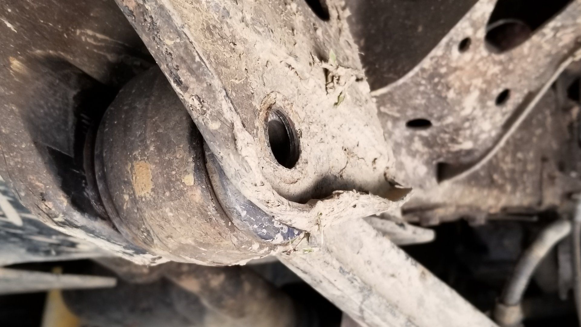

Heard some odd popping sounds from the pass side when wheeling on the 11th, but couldn't isolate the noise to find a cause. Continued happening the next couple of times I drove the truck. I checked the nuts for the knuckles and all was good. Took it on the highway today and got a bad rattle and truck left like it was wandering and pulling right, but it was breezy at the time so not sure. Pulled into work and got under it and found the source ...
This hasn't happened before:
Grabbed the pipe and it felt secure. Checked the bushings and all seemed ok other than the front steering link bushing is torn, but shouldn't cause that. Grabbed the sway bar and it moved by hand several inches ... found it. Not sure if this will need welding skill or is just a replaceable part?
The pass side front sway bar mount gave up. At least this explains the odd sounds I was hearing on the trail.

Edit: DANGER! DO NOT DRIVE AT HIGHWAY SPEED TILL RESOLVED!!!
Something else has broken. A sway bar will have no effect on your highway straight line drivability. The front wheel could only contact the exhaust pipe at full articulation with plus size tires like you have. Nothing should be rubbing or touching while driving straight down the road!
I couldn't see anything about a sway bar link in the photos you posted above.
@Pacer the mount for the sway bar at the very front on the pass side is broken off from where it secures to the axle.
The part I circled is supposed to be bolted flat to the axle. I'm pretty sure the exhaust happened either at work or home with the wheel at full lock when reversing on uneven ground, but I will look for other damage elsewhere.

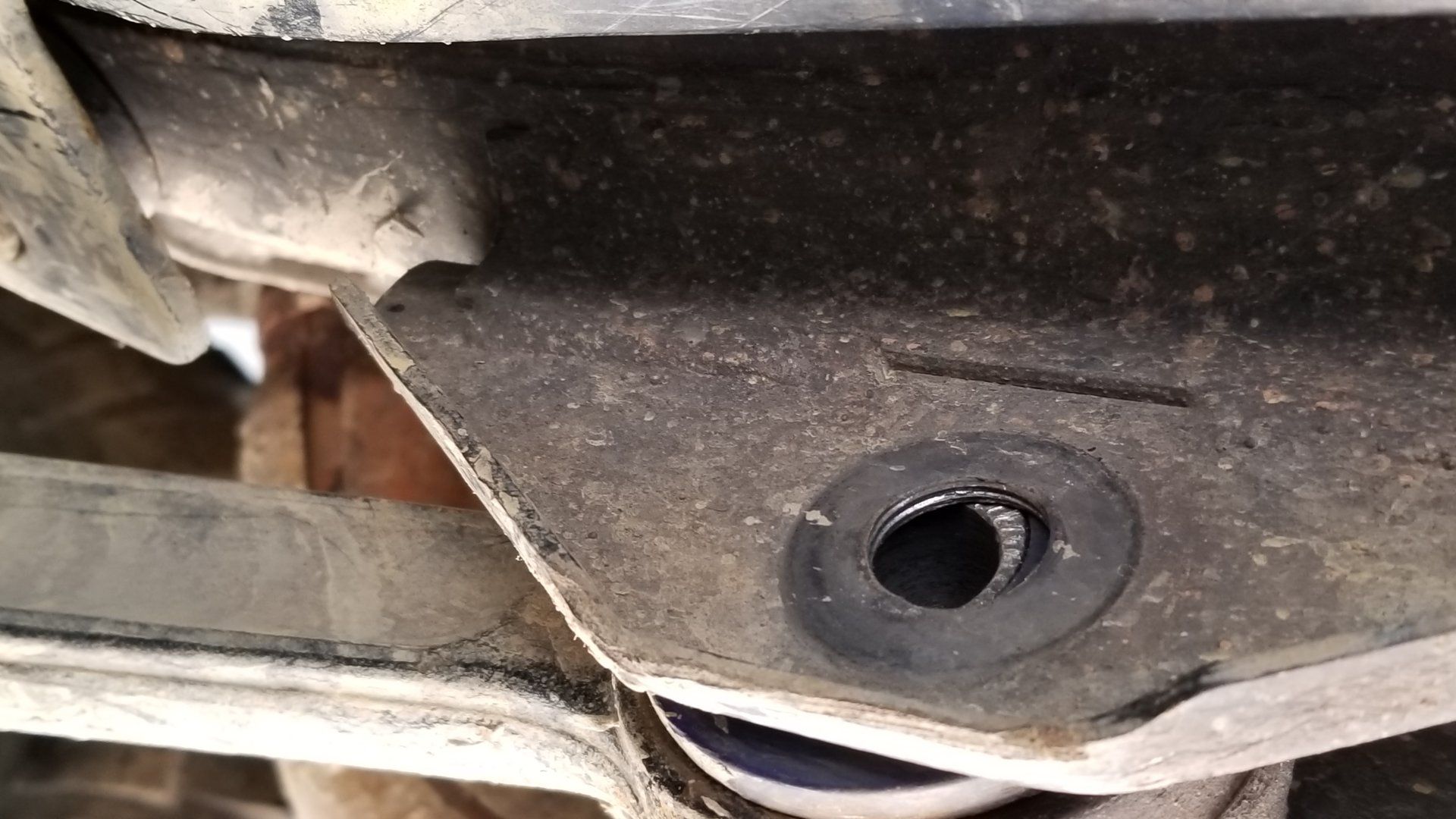

I ordered the overly expensive sway bar mounts from Wit's End, then decided to remove the sway bar so I could drive the truck in the coming rain and clean it off. Remembered what Pacer said and looked for other issues ... FOUND IT!!
The rear bolt on the pass side control arm is probably important.
How a bolt the size of my finger goes missing is beyond me, but now the truck is sidelined until I can get some replacement parts.
Not properly installed and torqued.
I lost one of my rear LCA bolts at Rausch a few years ago. Drove home without it, but took my time.
