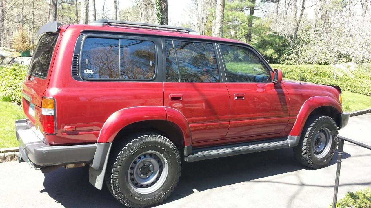

Installed OME 2.5" lift at local shop today. Stepped out for a minute then noticed they were trying to remove the control arm bushing bolts from the nut side as opposed to the proper bolt side. They followed through and turned the bolts. My question is whether the nuts or brackets may be compromised... Anyone?

by the way the suspension is great. thank you for all of your advice and tech support (and stickers : )
