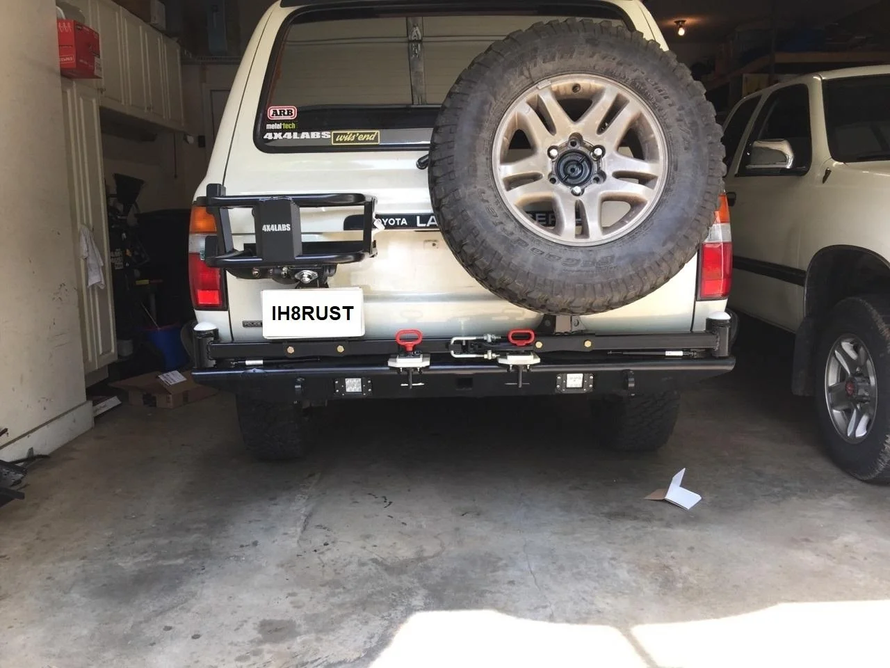

I got my 4x4 Labs bumper mounted and my license plate moved, but I need to add a light for the license plate to be legal. Looking for a simple LED light that I can wire in.

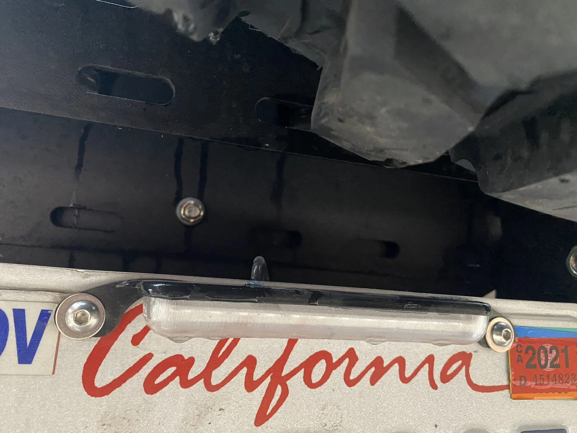

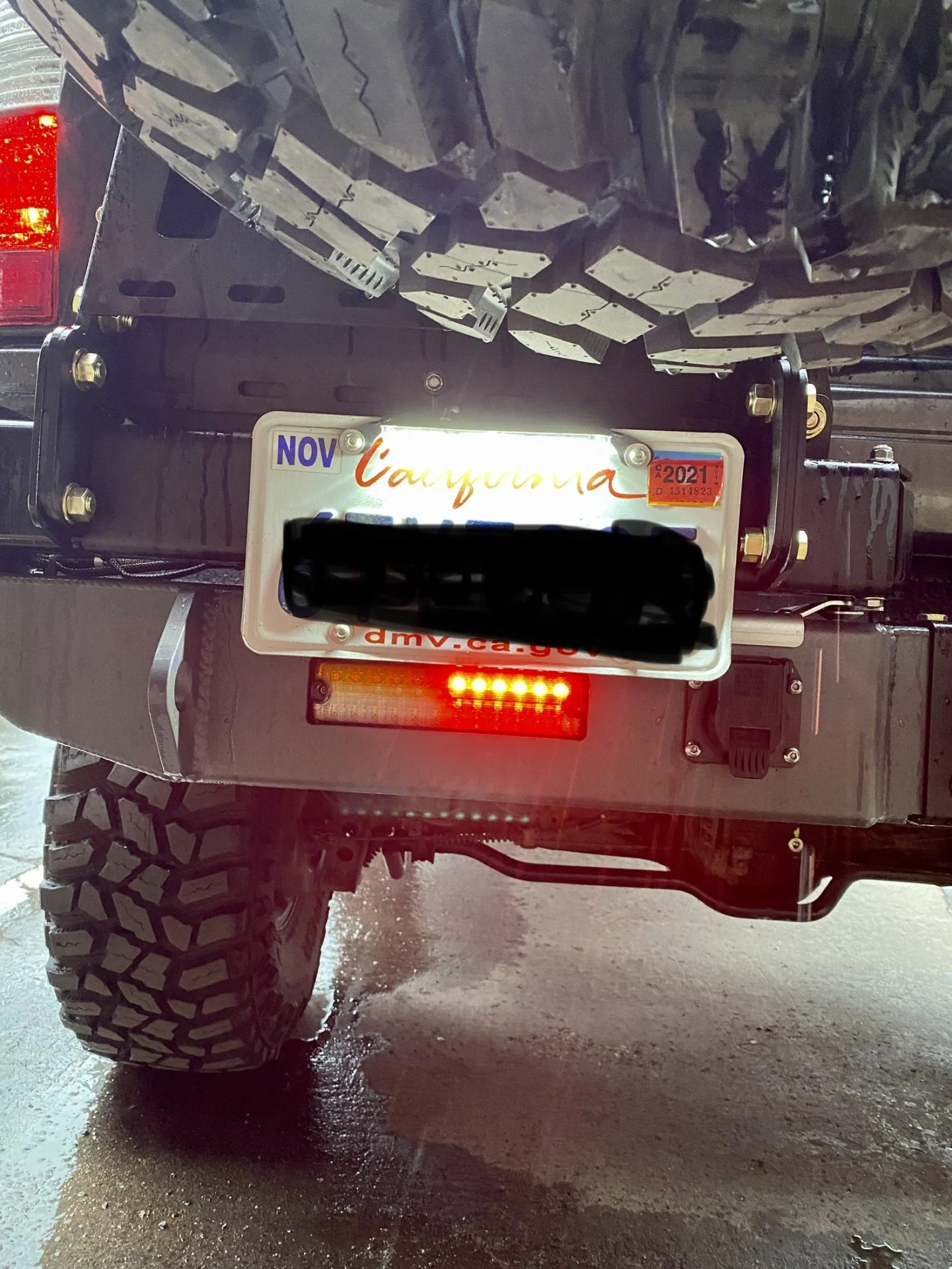

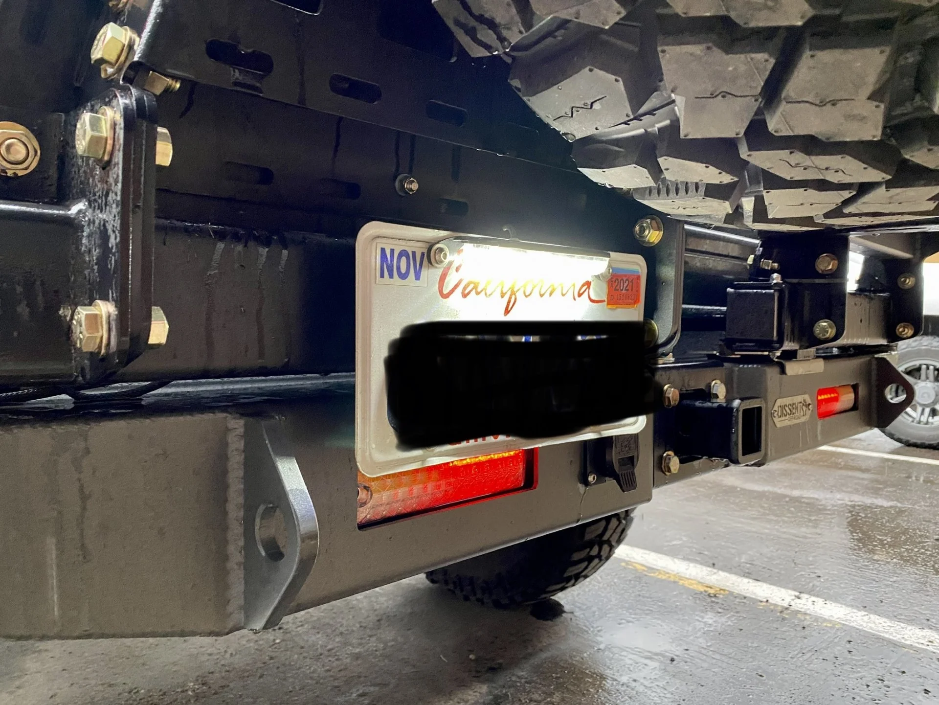

This LED is what Dissent Offroad is using on their bumpers. I can’t see a name brand in it though. It’s pretty damn bright though. A bit much for my taste.

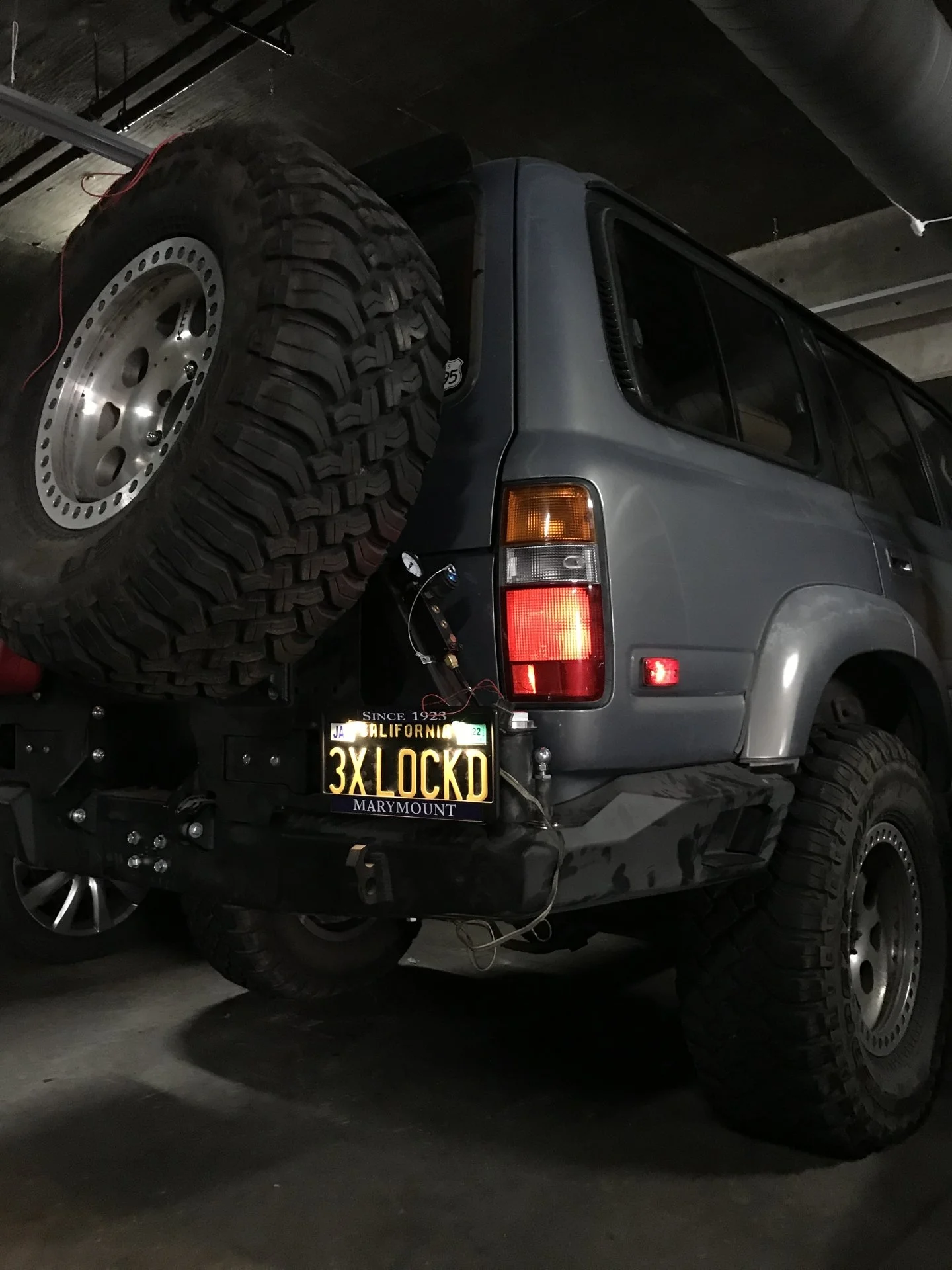

The LED bolts are hot. Still have to wire them up but a very nice solution IMO. I’m just being lazy waiting on the battery version lol

I also use the illuminated LED license plate bolts. Only complaint is they are a bit bright when you wire them direct. If you get the “Warm 3000k” color and put a little 12v dimmer in line, you can get the lighting signature almost exact to the rest of the vehicle lights. I also pulled power from the tow harness plug. Easy peazy lemon squeezy.
