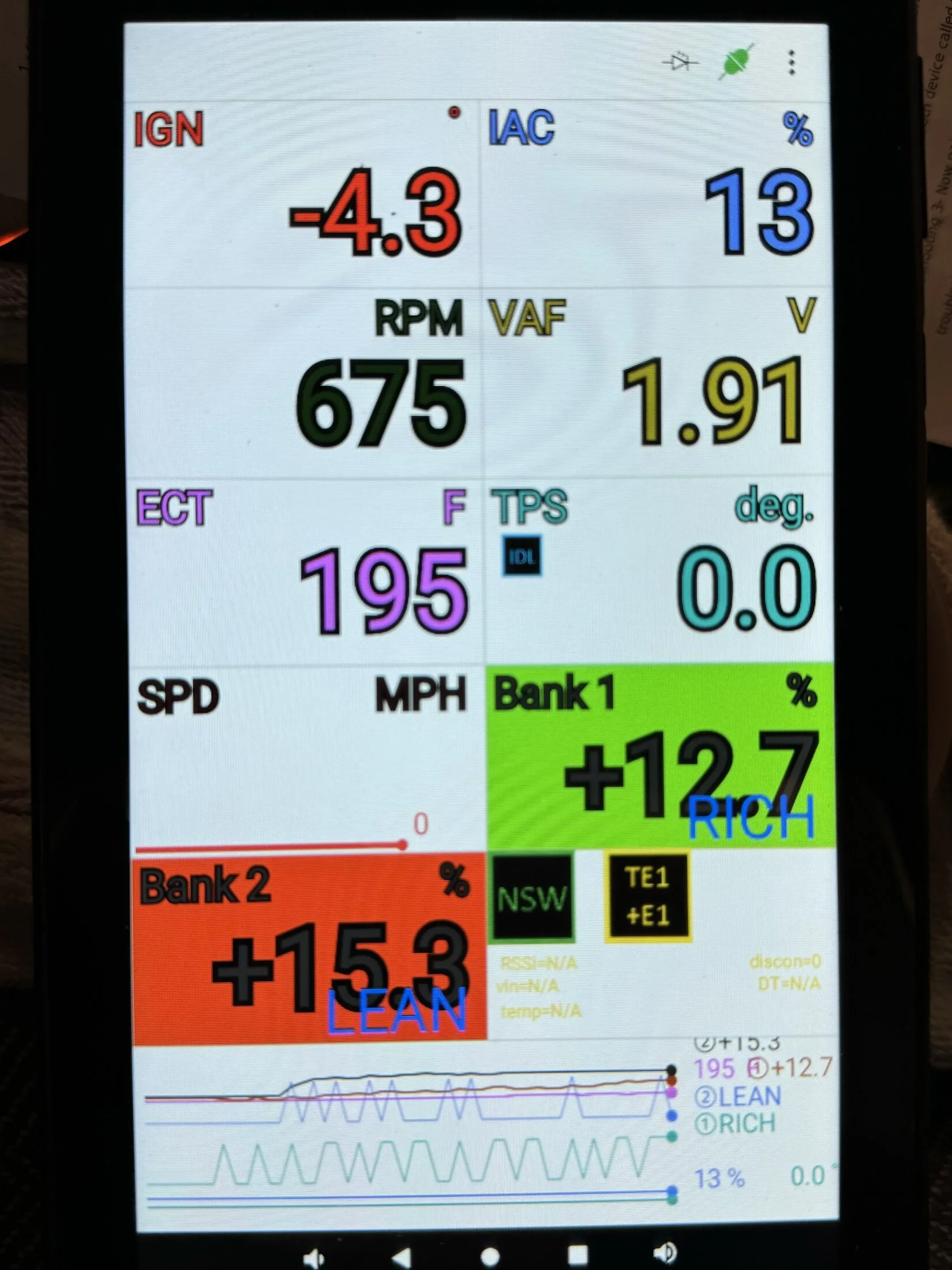

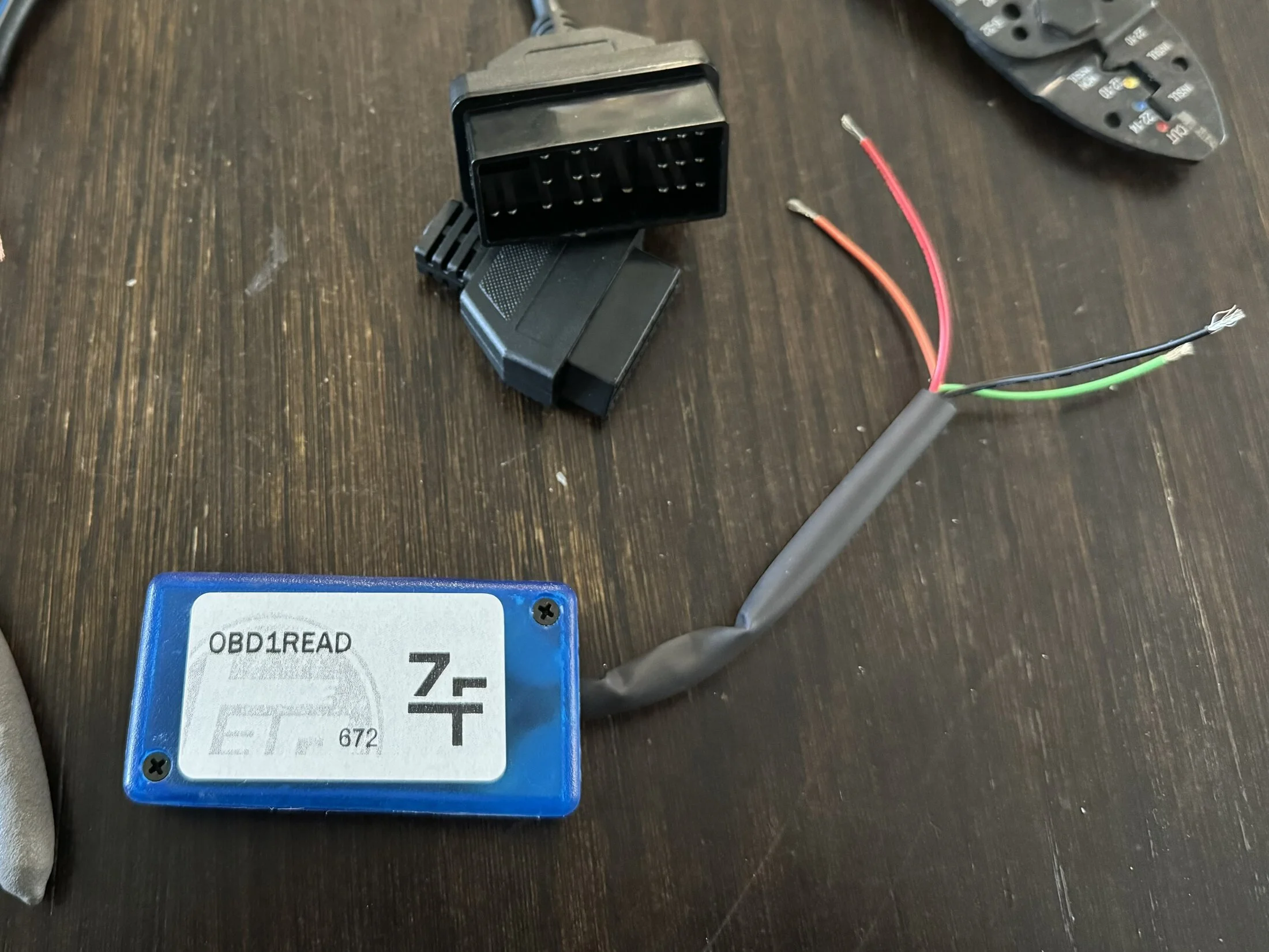

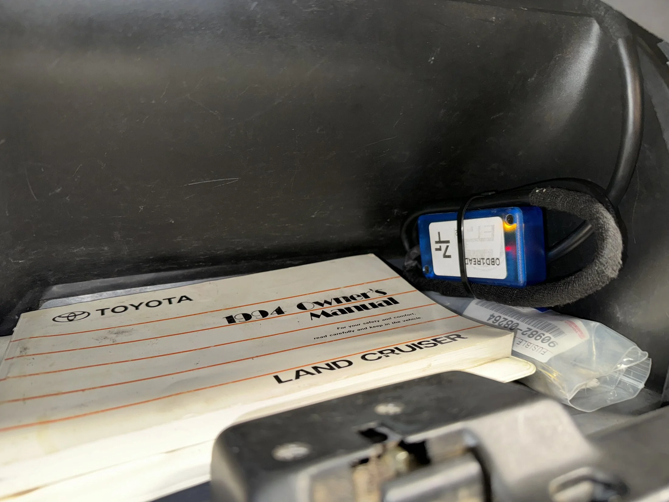

IMO, 95+ with OBDII is huge.
Orrrrr….get an OBD1 reader and app to have the same functionality. Got one for my ‘94 and it’s great to see all the codes and gauge readings right on my phone.
