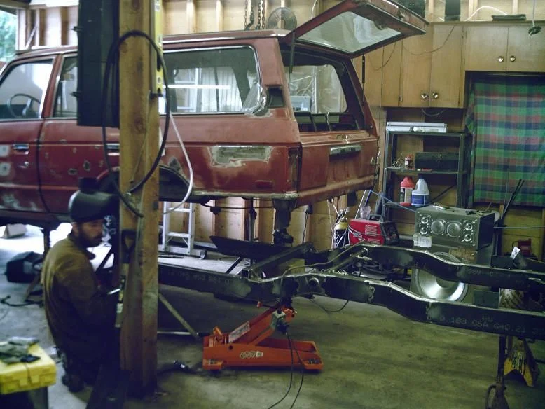

i got it, here some pics of the new back 1/2 frame and the old highend rust hole. notice the wicked shop sound system in the back.:D

gbcruiser I come to VI often would like to see the frame
I dont know where you live but if its in the metro victoria area hope you would not mind me stopping buy to see your custom made frame. Mine is going to and like how you made yours. Seems more robust then a regular built frame. Give me a msg and see if something could be aranged.

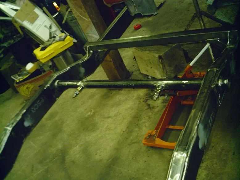

if you need help with your frame ... i am in Victoria.... i just did the rear half of my frame.... just bought this BJ60 a couple of weeks ago...
heres a pic of the new frame rails...
and before i put it in..
