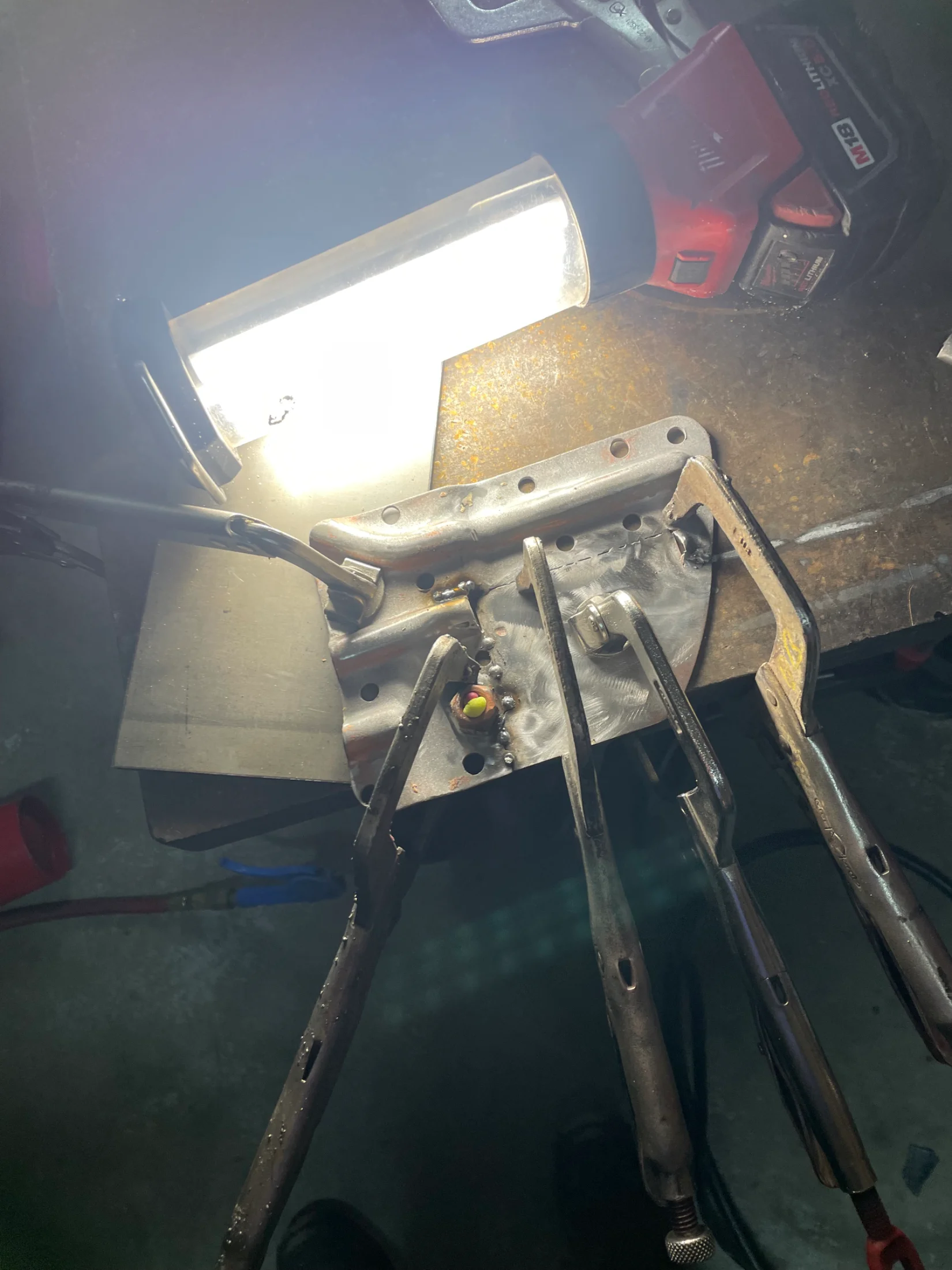

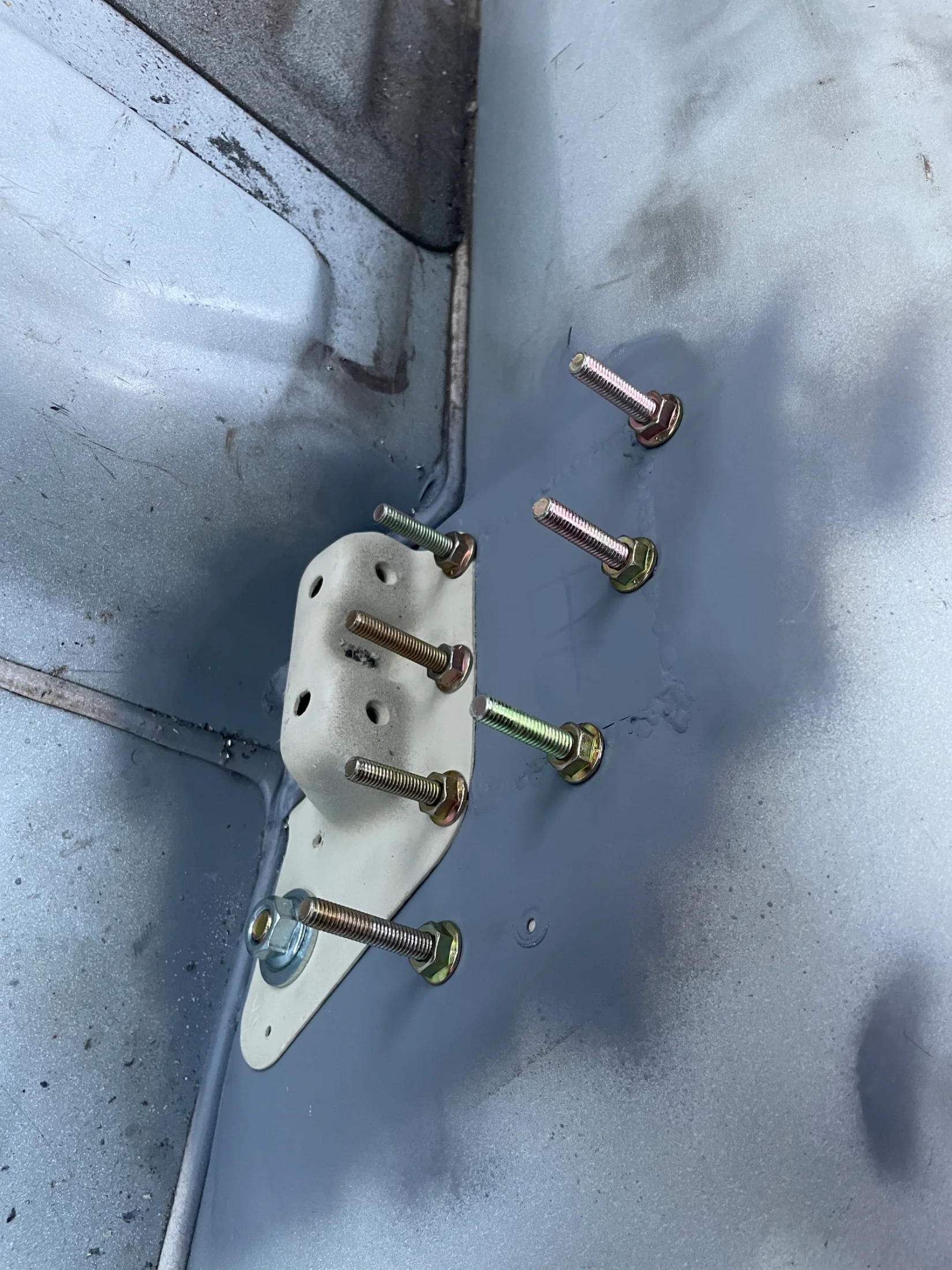

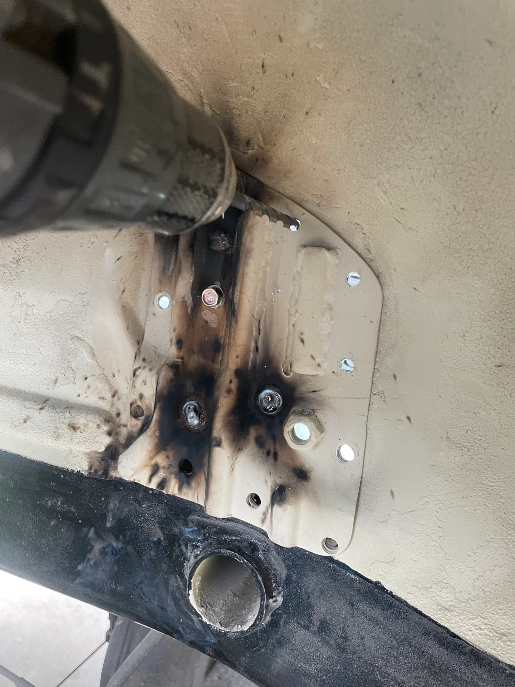

Not sure if this applies to your situation, but I drilled out any surviving spot welds for the seat stiffener/seat mount, and used the spot weld holes to guide the piece in place and clamp it down.

@bcolvin , if gimme's idea doesn't work, make up a jig to hold it in place. Bolt it to the seatbelt mount point n to the 2 bolts on the compromised bracket before you cut it out. Cut the portion that is covered by the jig before you mount it. Then fasten jig n then carve it loose. Best of fabbin' to ya
So... is there a place to get that plate? That plate looks stock. I was going to use a thick plate. Also that rear seat pivot cradle... is that new? Does someone make these or did you fab it? Looks great. What are the bolts for? Seems like overkill for positioning.
I had to fabricate part of the stiffener and the seat pivot.
The bolts aren’t overkill. They keep everything very tight and closes all gaps so you get a tight and accurate fitment.
Pull every bolt out one at a time. and plug weld the hole. Welding is much easier when it’s tight together.
Use and aluminum block behind each hole to plug weld.

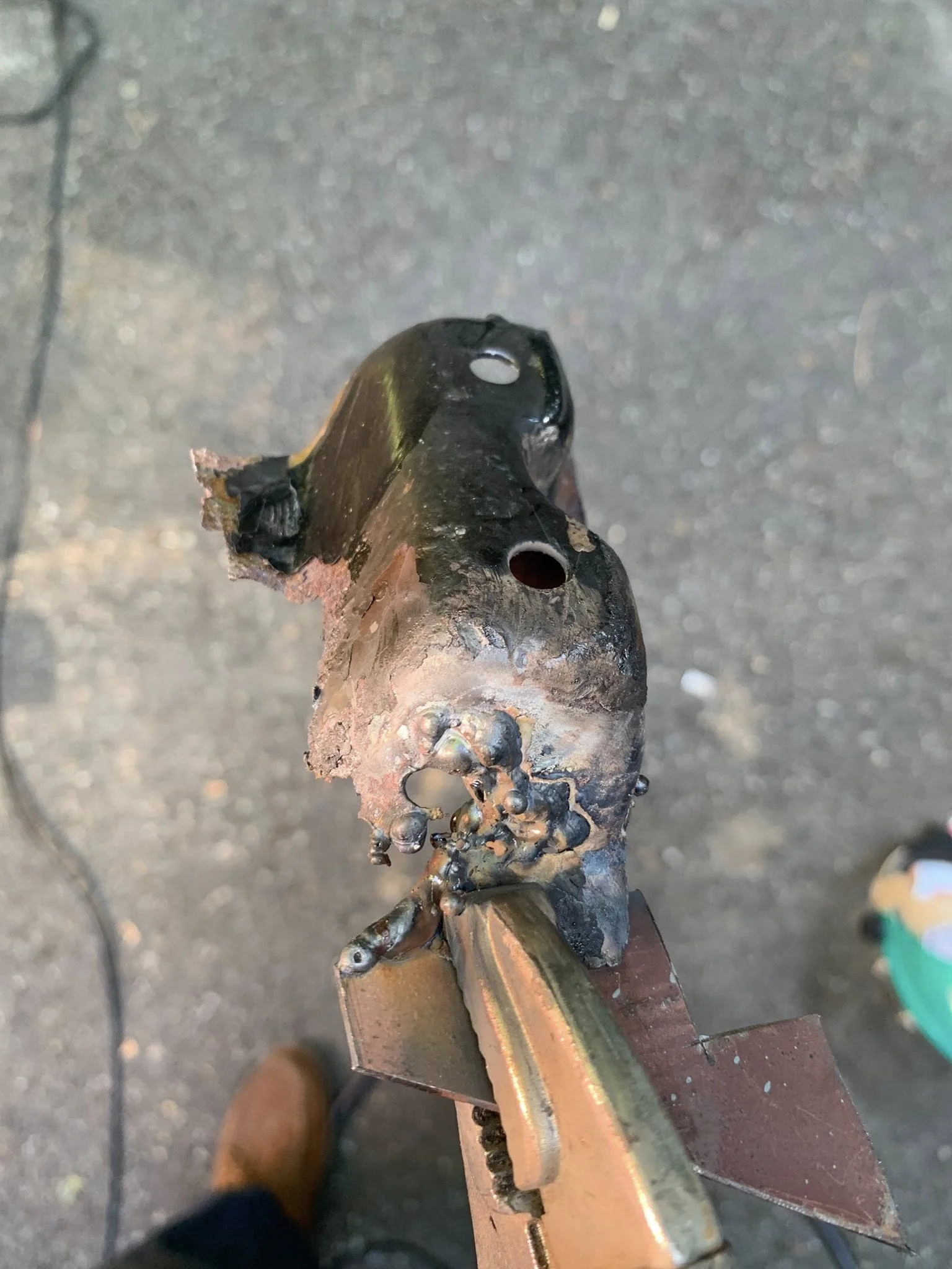

wELL I'm still plugging away at this. Of course if there's a little rust then there's more nearby. My seat pivot cradles are so thin and barely existing. I rebuilt them blob by blob with the mig.

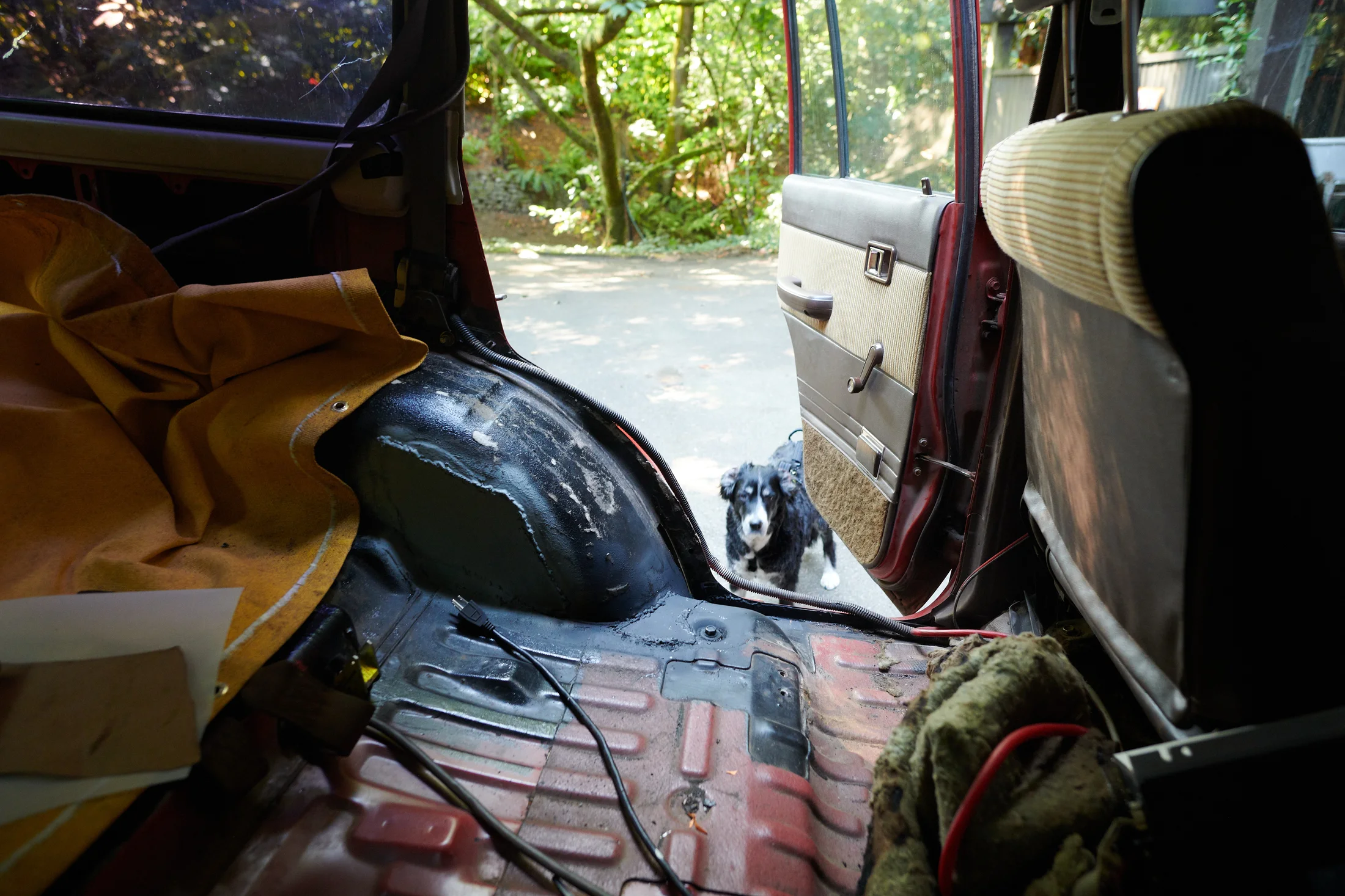

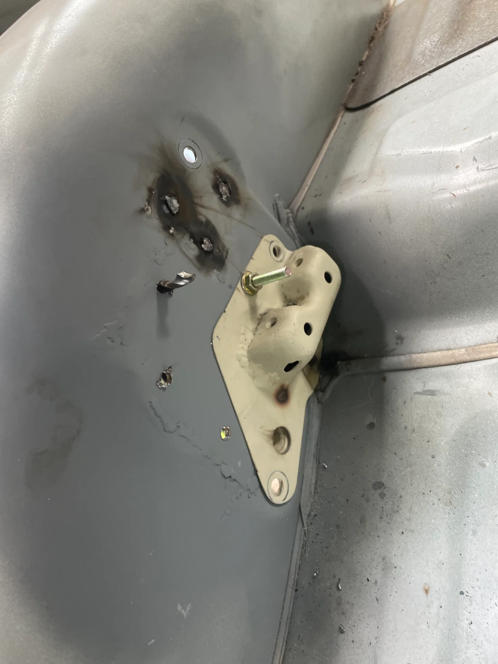

Put in the seat back pivot cradles yesterday. Key was determining that the cradle tops should be level with the rear deck. Wasn’t completely obvious because my cradles didn’t have a strong opinion about anything when I found them. I put tape markers down and measured to start of first fixing bolt using a caliper.
So then 5 days later I’m wondering where is the scrap of paper with the measurements!?! Happily found them.
Tacked cradles on and seat back test fit was perfect.

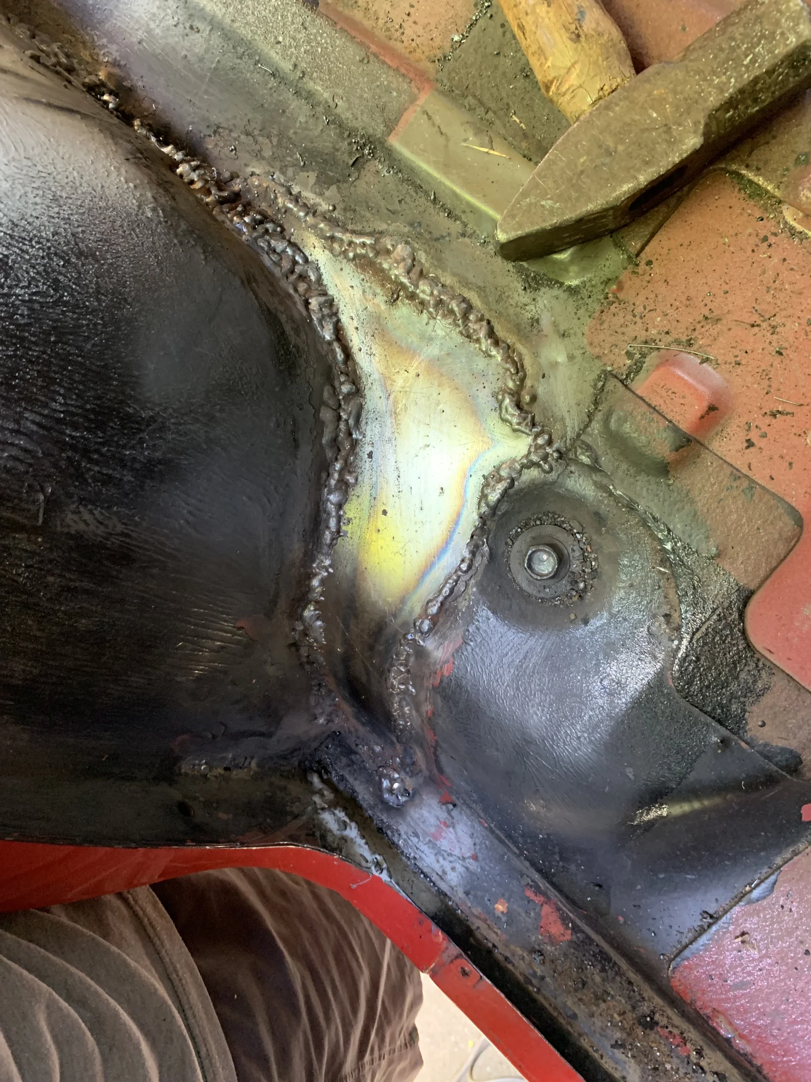

At the very end I cleaned and scrubbed with isopropyl then hosed it all down with spraymax 2k epoxy primer. I’ll need to do something about wheelwell covering but not rubber based, that’s for sure. I’ve also got some seams to fill, but happy with epoxy for now.
Added a view of a cradle from the wheelwell.

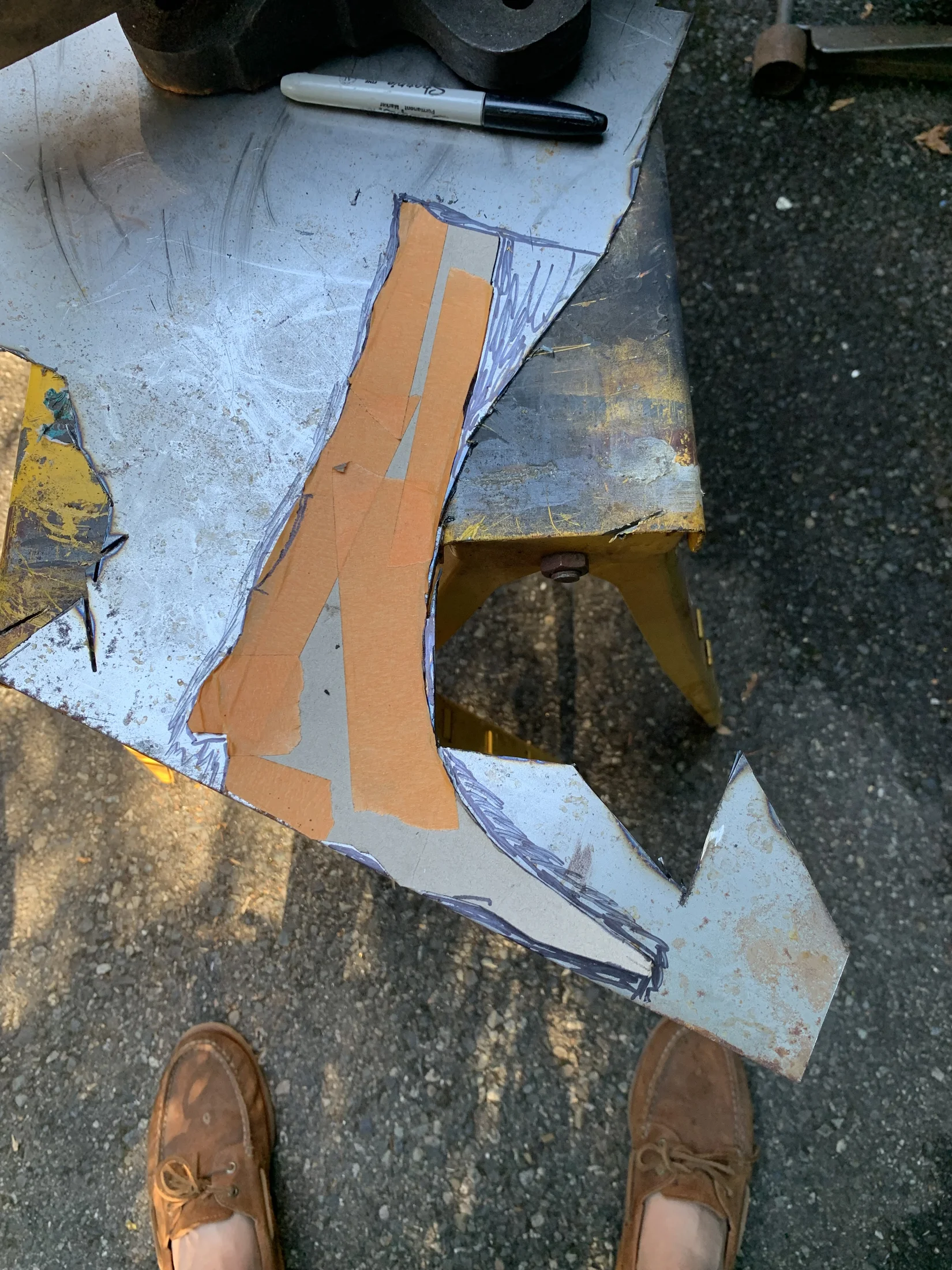

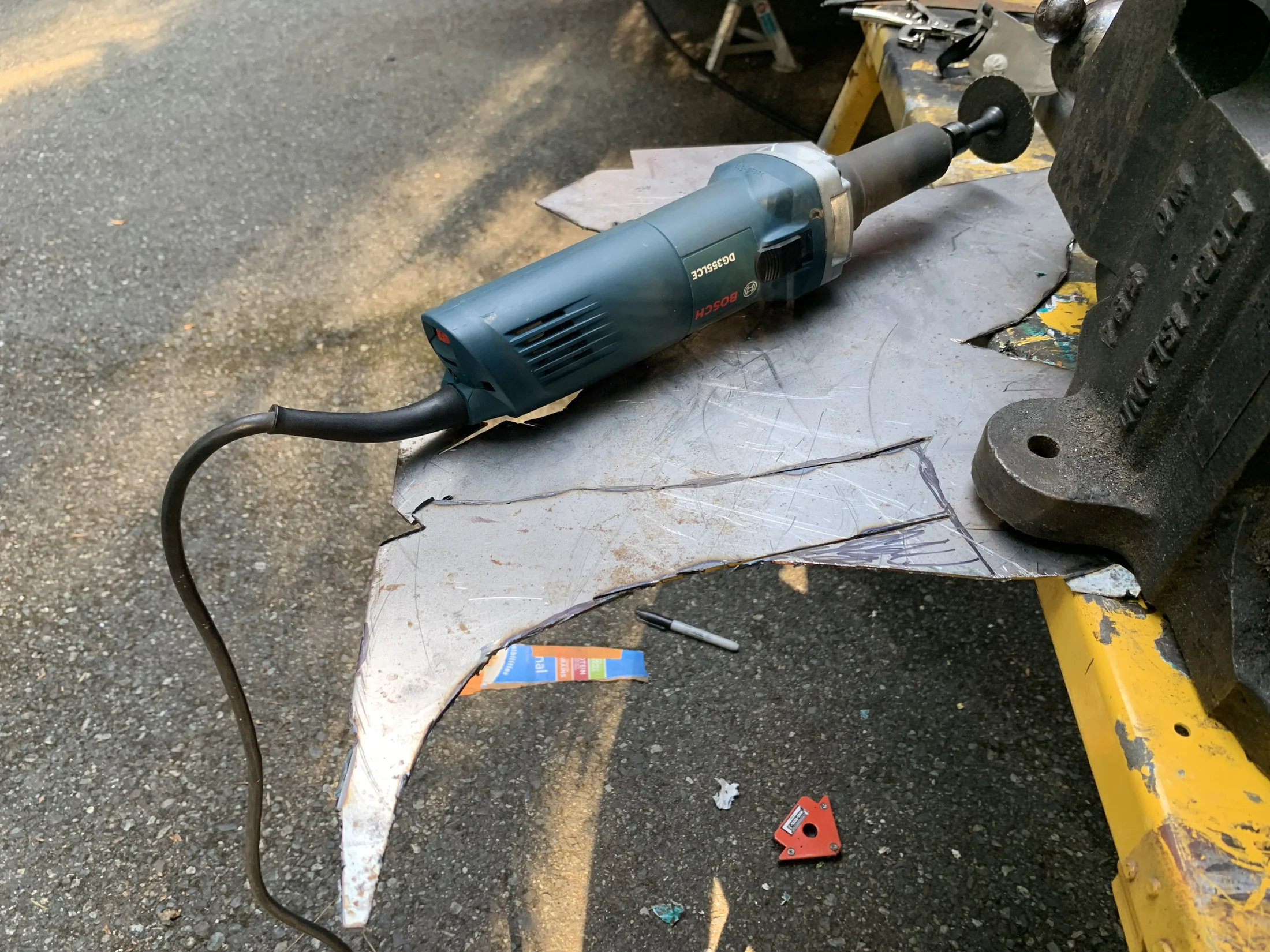

And here’s a view of the steps for the last piece I put in. Template took 45 minutes, the steel piece took an hour. The welding took an hour. I didn’t grind enough paint away before Welding so it got messy.
Anyway. It’s solid now and no rust, and coated. Sounds like an anvil when hit with hammer.
By far the most difficult piece was the wheelwell extension down from deck. it was a neat spiral form that took forever to curve properly and then a lot of grinding to match the edge.

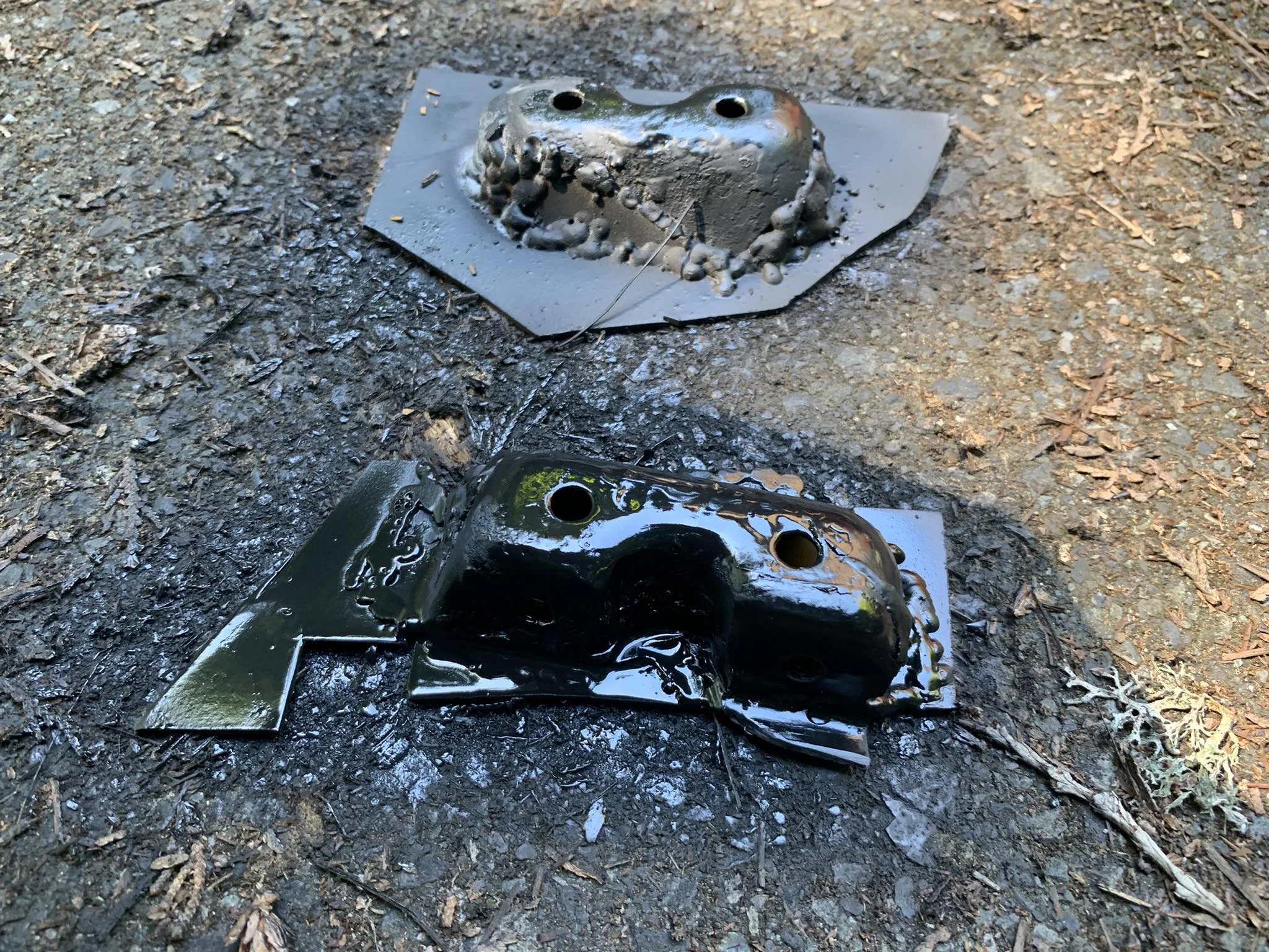

I built up the cradles onto scraps of 16g with blobs of mig, then I cut the edges down so they'd fit, finally cleaned it all well and soaked it in epoxy primer.
We did a test fit after tacking them into place and it was a joy to hear the seat tops go 'click'
Anyway heres my rotted cradles getting rebuilt. The straps and the bolts to hold the lower pivot went right back in.
So, key for positioning the cradles is that the tops of the cradle need to be level with the rear deck. Because the rear deck was intact we were successful just recording the distance from some stable place on the deck to the start of the first bolt hole. What was dicey for us is that the cradles correct position was ambiguous because they were hanging from a thread of rusty sheet. The cradles are 'real close' to the wall below the deck, too close for the torch.
