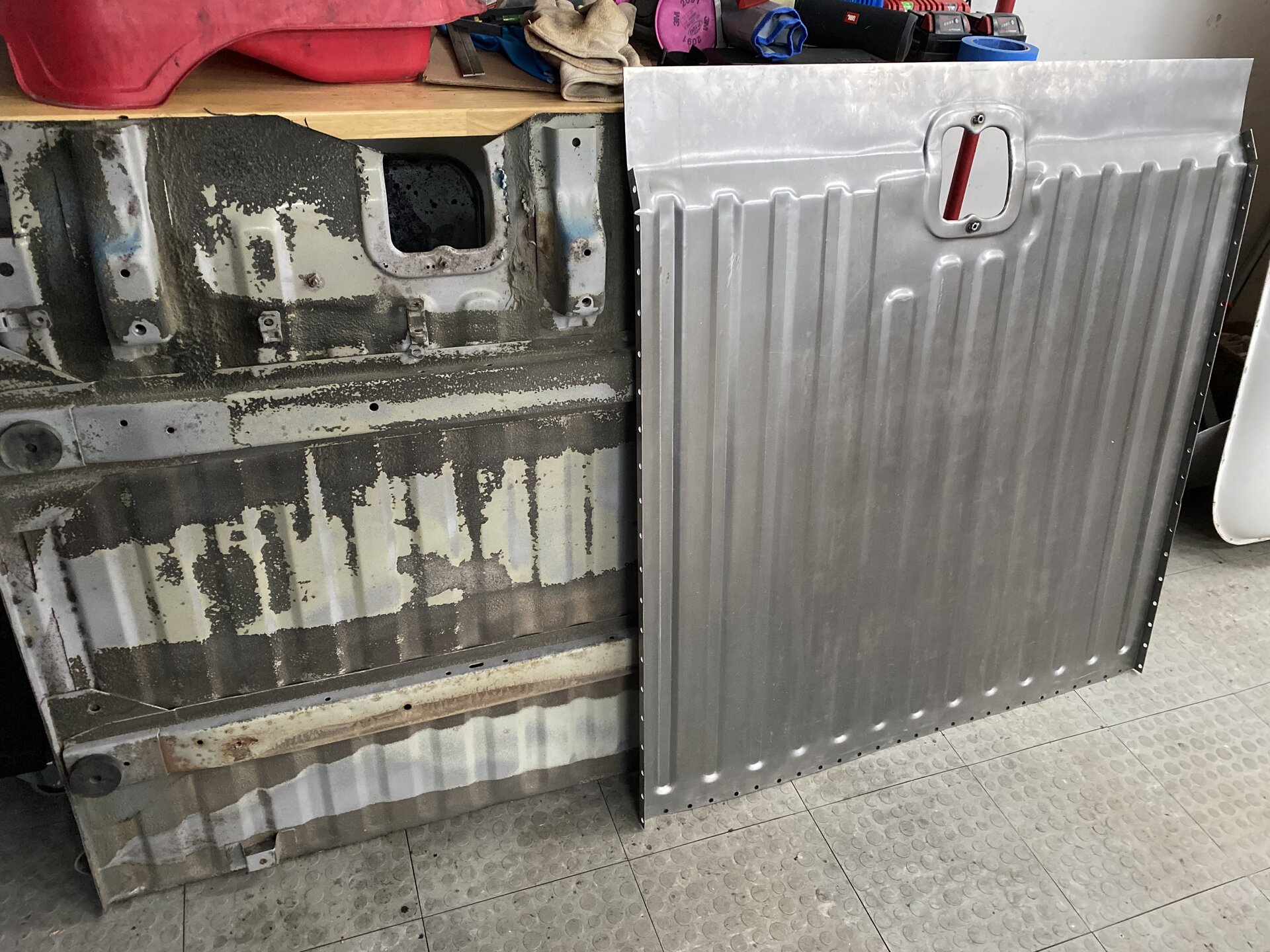

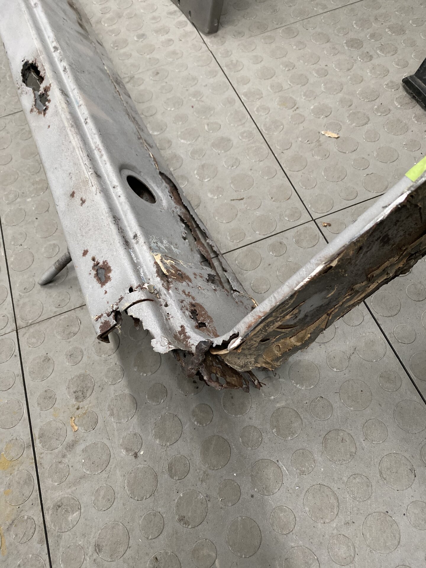

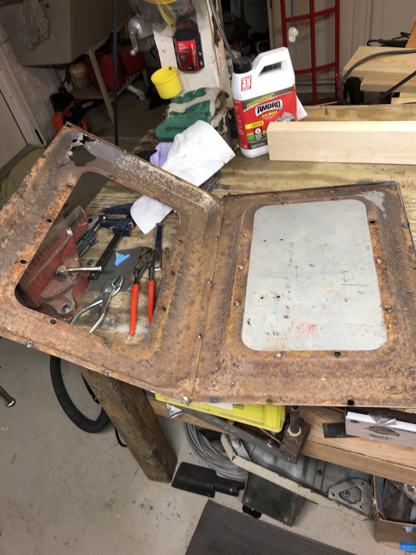

And we all love pics so here’s some for the wall of rust shame.

Thats a beautiful bed panel BTW. Where did that come from? Looks primo.
It’s the Real Steel bed. Overall their products are pretty good but not wonderful. Still lots of modification that needs to happen but… I’m super thankful these exist. This would be an almost impossible project without these panels.
