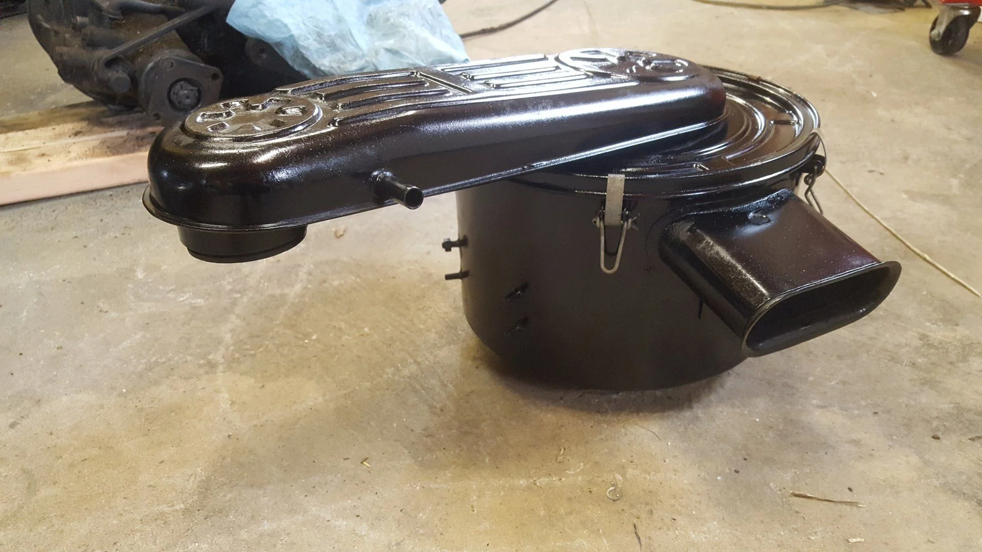

what does the oil bath air cleaner look like? the early ones were for the single barrel sd40 carb, which would not work on a later 2 barrel carb.
Will take a picture and post..You may be right, can always modify!
Attached is the Air cleaner I found. 2.25 inch diameter (5.7CM) for the carb opening. Will check the dimensions of the 2 barrel 38 / 38.

negative on it being an oil bath.
Thanks Brian,
Not sure what you mean. I open up the cleaner, no paper element and oil in the bath, with a re-usable filter. Is there something I'm missing? Pretty sure it's an oil filter, I could be wrong, it's happened before. But with oil in the filter with a re-usable element? Let me know. Just want to understand factory vs.Weber.
Boaf
