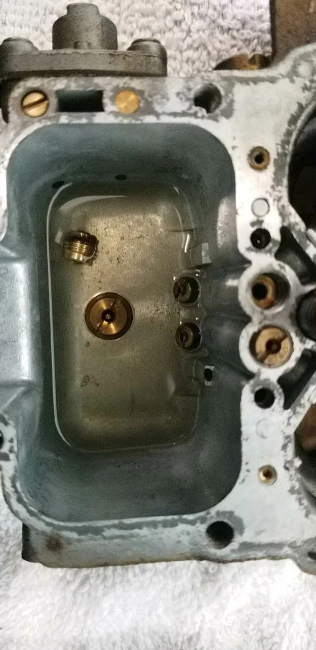

My Weber did the same thing, stumbled then backfired through the carb when climbing a hill at highway speed. Removed the old gas lines and filters, three, removed the old fuel pump and added a new filter, electric pump and regulator. The gas tank is a new one I installed three years ago from BTB Products. The original tank was suspect at best so I removed it. (The instructions with the fuel pump stated Weber carbs need no more than 3 psi.) It ran pretty good for a little while then started to flood out at idle and was near impossible to restart. Found that one of the jets at the top of the fuel bowl had backed out and was laying in the bottom of the bowl, the other was loose and even one of the jets in the bottom of the bowl was about 3/4 turn loose. We have adjusted it and adjusted and adjusted, still idles rough and stumbles momentarily at highway speed when given additional pedal to climb a hill.
Timing is correct, vacuum lines are in place but the carb is still stumbling. The rebuild kit/tune-up kit I purchased was installed by the instructions with a new float. The inlet needle set was entirely different than what was in the carb originally and the new set would not allow the bowl to fill so the old one was reinstalled. I did call the Redline technical line who handles Weber and the call hasn't been returned yet.

I'll pull the top and clean out the jets. Any particular method you recommend? A sewing needle or drill bit, or something along those lines?

I use a magnifying glass to check for obstruction and use nylon monofilament line to clean and carb spray cleaner to clean them out.
Thanks! I have both on hand. I'll take care of that this afternoon.
