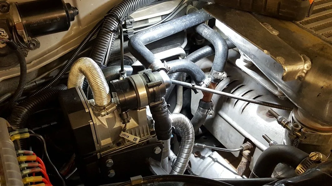

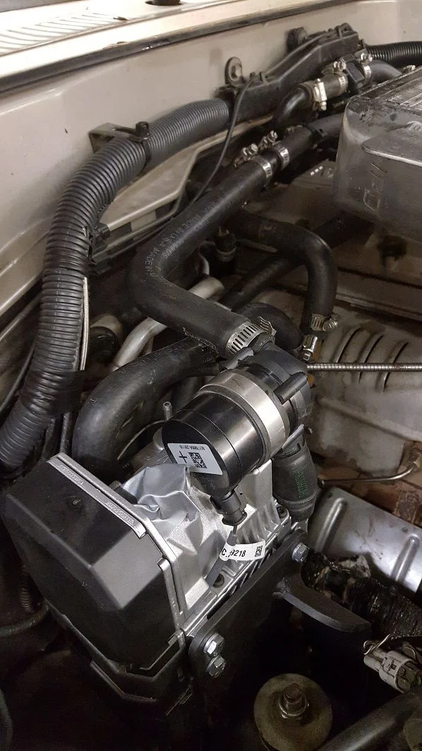

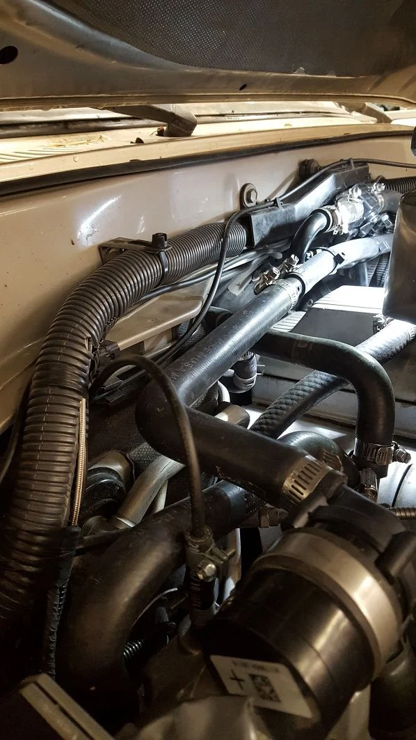

Update! This afternoon I got my coolant lines plumbed. I went into Lordco and picked random hoses that were the correct sizes and had the angles I wanted off their wall. I think I confused their parts guy, lol. I used a couple AC Delco hoses 18155L and 16136M.
I had THOUGHT the Webasto had 5/8 barbs for the coolant lines but I was wrong. They are 3/4. One of the pre-made hoses I picked has a 3/4 inch take-off that changes to 5/8 about an inch into the line, so that was perfect. The other is 3/4 all the way, then I used a 3/4 to 5/8 hose joiner where it connected to my bulk 5/8 line. I used all stainless hose clamps.
It was convenient that one section only a few inches long that I had cut off the end of one of the hoses was a perfect 45 degree and exactly the correct length for fixing the section of hose immediately before the heater core (where the 110v percolating heater was installed previously)
The end result is as close to a factory/oem look as I could manage. The formed hoses helped with that I think.

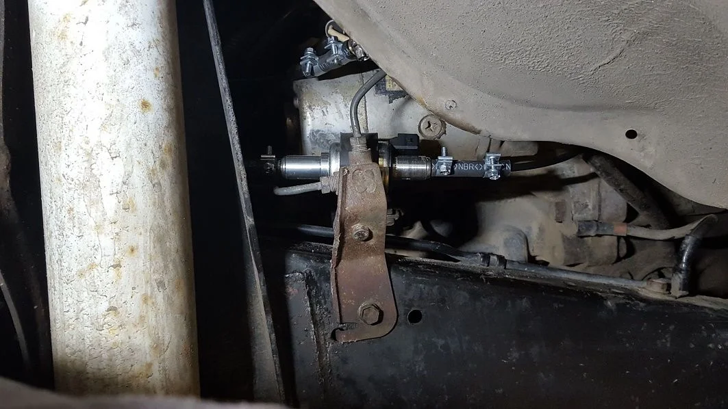

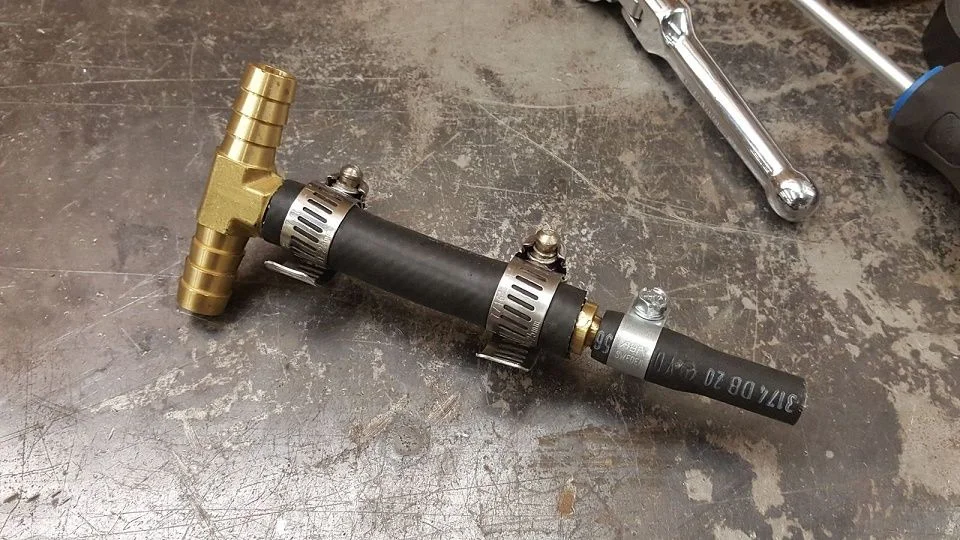

Friday morning my bits from Newline Hose and fitting will be here so I will hook up the diesel fuel line. @dan1554 I ended up ordering a brass barb'd 1/2 inch tee with a 3/8 barbed take-off, and a brass barbed 3/8 to 1/4 hose coupler/reducer.
I am having a hell of a time finding a branch tee for the fuel line. In the newer HDJ81's the fuel line is 12mm, close to 1/2 inch, not 3/8.
RHD was tee'd before the fuel filter and worked great for 4 years. This time around on a LHD, I put a seperate in-tank pick-up which was cut short. Was already swapping in a larger capacity tank, but in hindsight it only took 30 mins and is much cleaner without risking air leaks in the main line. Nice install btw.
Got my fuel line tee'd in, doesn't have a shut-off like I had hoped to do but is as simple of a take-off as I could do. @dan1554

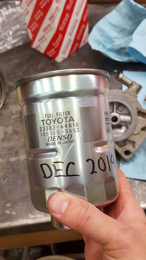

Changed my fuel filter while I was in there, as it was due anyway.
Mounted the pump nice and LOW along the top of the frame rail. Totally isolated by the rubber mount and all lines are kink-free and nicely routed. Filter mounted before the pump. Ran the 5mm plastic hardline up and across the firewall using the oem clips and a free brake line clip to support at the end.

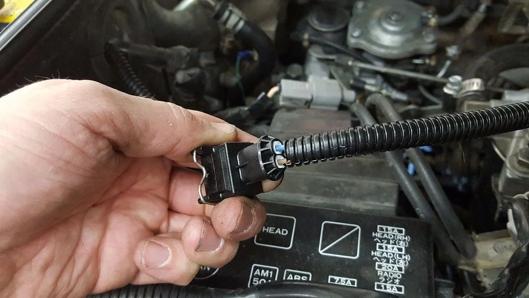

Finished the wiring, including the little fuel pump.

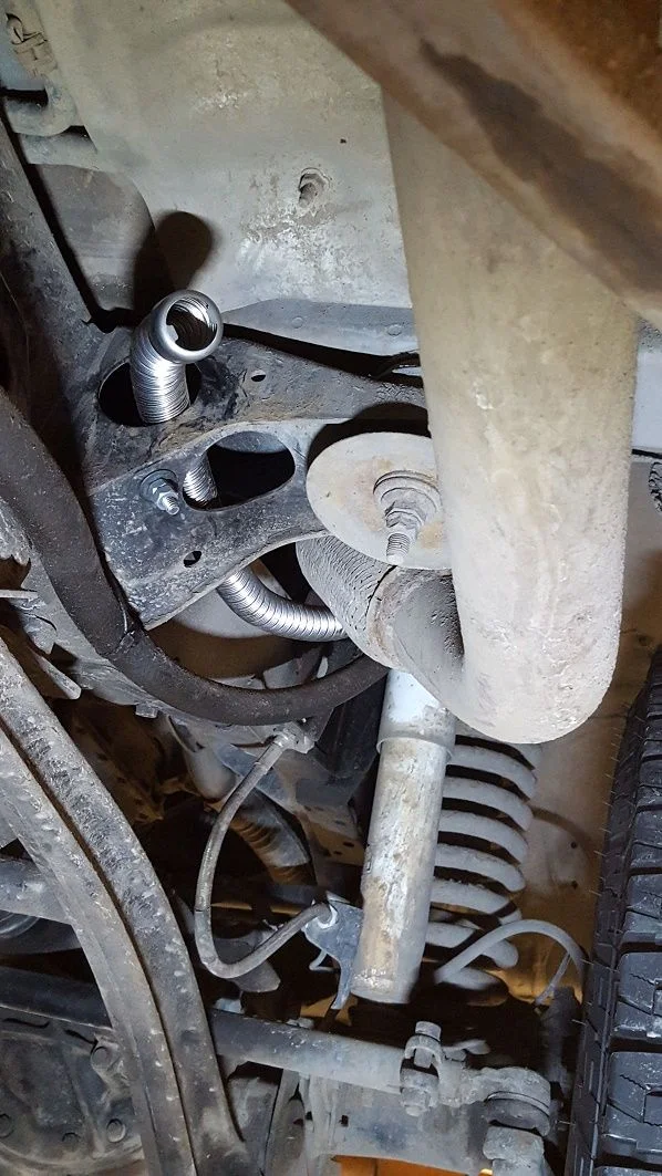

Routed the exhaust down along the truck's exhaust, away from anything burnable and held without touching anything using a couple metal P-clamps. There is also a heat shield along that side (for the truck exhaust) which is awesome.
Finished the wiring and connected it to the Blue Sea distribution fuse block. Attached the intake, used the hand-prime to fill the system as much as I could... started the truck up for a few moments to fully prime everything, then turned the Webasto on!

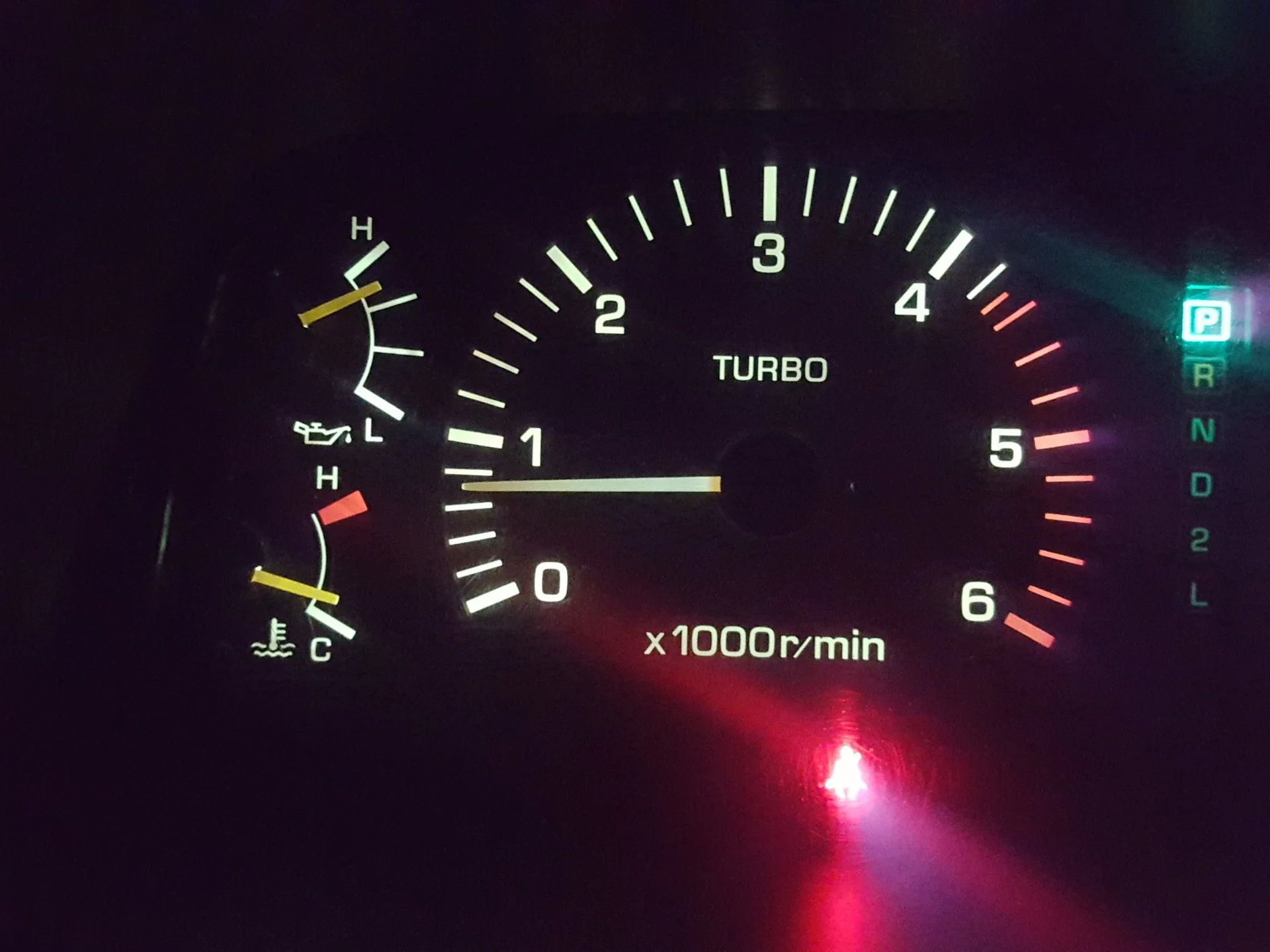

I set the timer last night and came out this morning to find it running away... it's just below zero (C) currently, it ran for about 25 minutes and the temp needle was half way up when I started the truck. I haven't done the high-temp mod yet. Going to see how it runs in the factory state first when in actually cold weather.

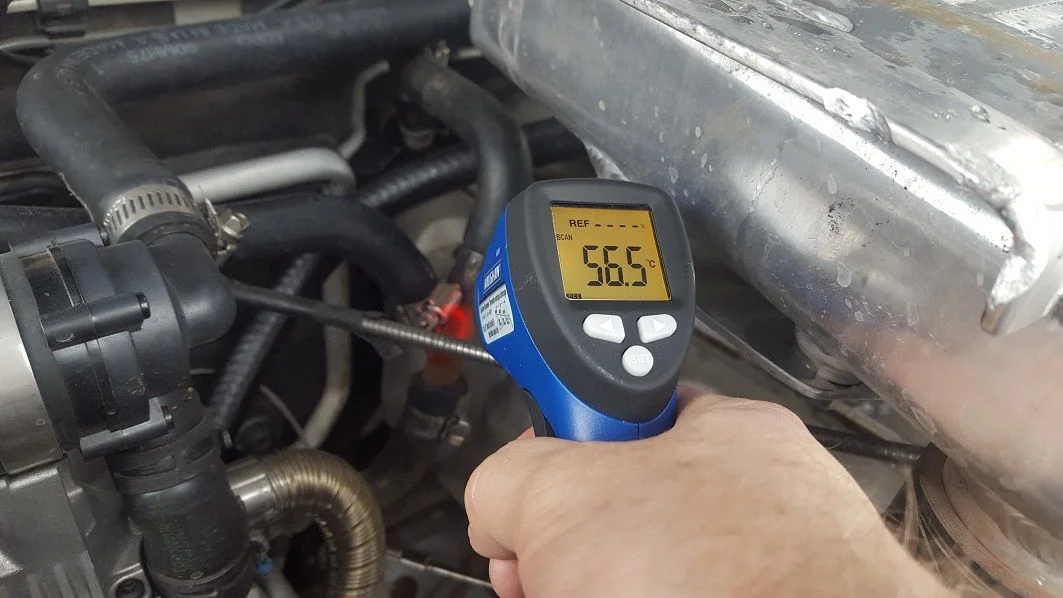

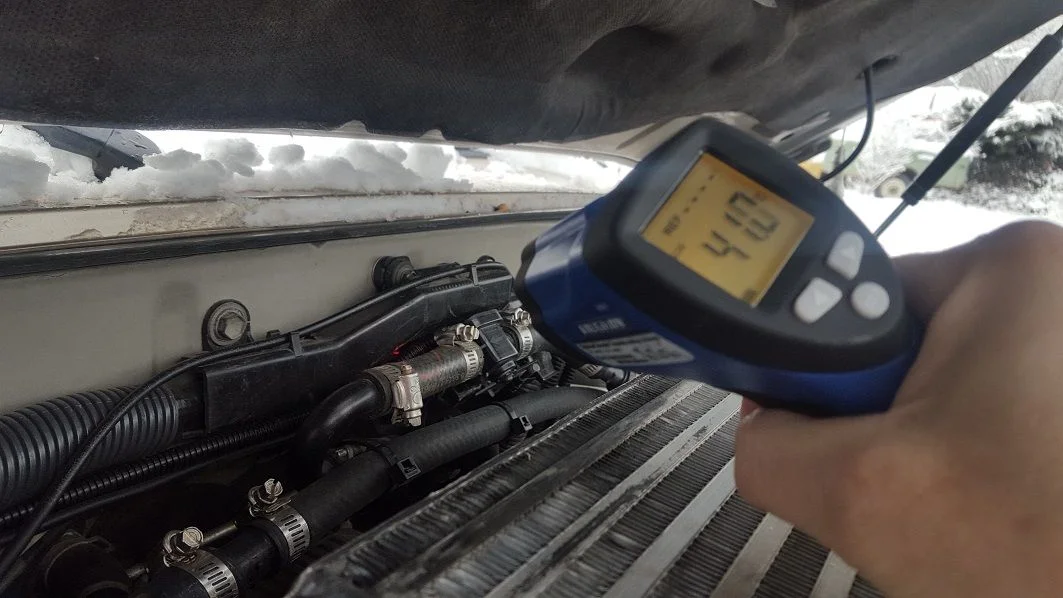

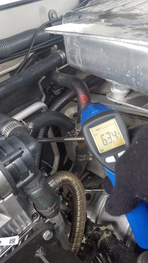

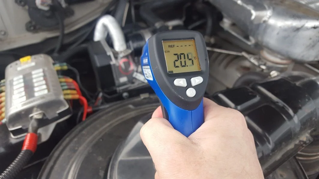

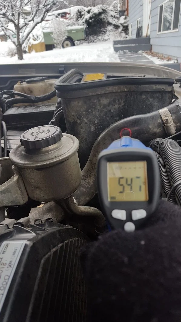

Yesterday (before the cold snap) I decided to get some baseline numbers on the Webasto before the cold settled in. Outside temp was around -1C. Truck hadn't been turned on since 5pm the night before. I turned the Webasto on and shovelled the driveway.
Note the following measurements are in degrees C
After 25 minutes runtime:
Webasto body
Exhaust (Note: I did see this reach 110 degrees C at one point)
Water outlet
Upper radiator hose
Going into heater core

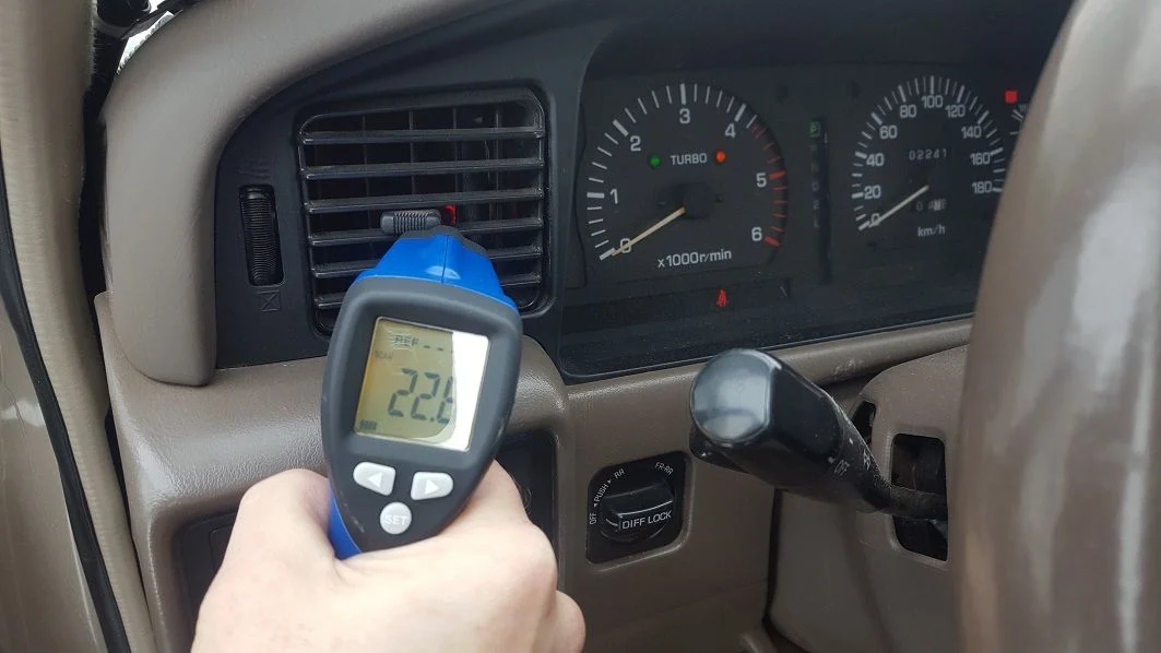

ROUGH temperature of fan blowing. I think it was probably warmer than this. Note the truck was not running at any point during these tests.
THIS BEING SHOWN... does anyone know how many amps the HVAC fan takes, and the best way to "trick" it into coming on with a 12v signal? It would be excellent to stick it on recirc. and let the Webasto pre-warm the interior / defrost the windows ;)

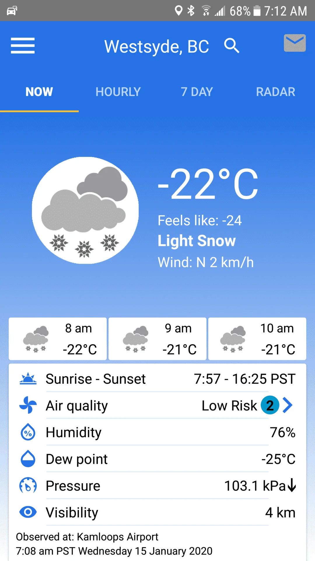

Report on the Webasto this morning! It was negative 22 C. It started like it was a warm summers day. The engine temp showed dead cold though immediately after starting, compared to Saturday at negative 1.
But by the time in had reached my kids school (less than 2 blocks away) the temp was up to normal operating level and heat was coming out the vents! Talk about a night and day difference of not having it.
This was 50 minutes of runtime before I came outside. On the "low level" on the Webasto.

I'm interested in what the temp gauge will get up to on hot mode! Full operating temp is around 190F I think, so 165F still isn't full hot.
