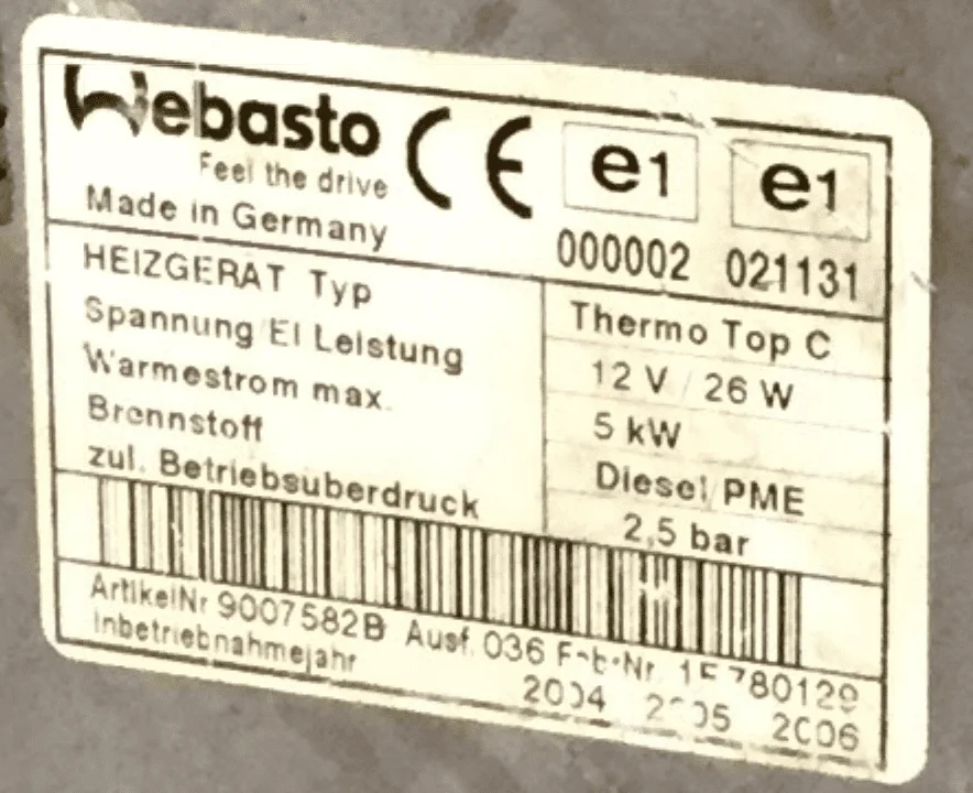

You actually repaired your Webasto with this? how old is your Webasto and which model is it?
I cobbled my whole setup together from a bare unit. Here's a link to that post with a picture of the pump attached:
Webasto install HDJ81
Nameplate is attached to this post.
