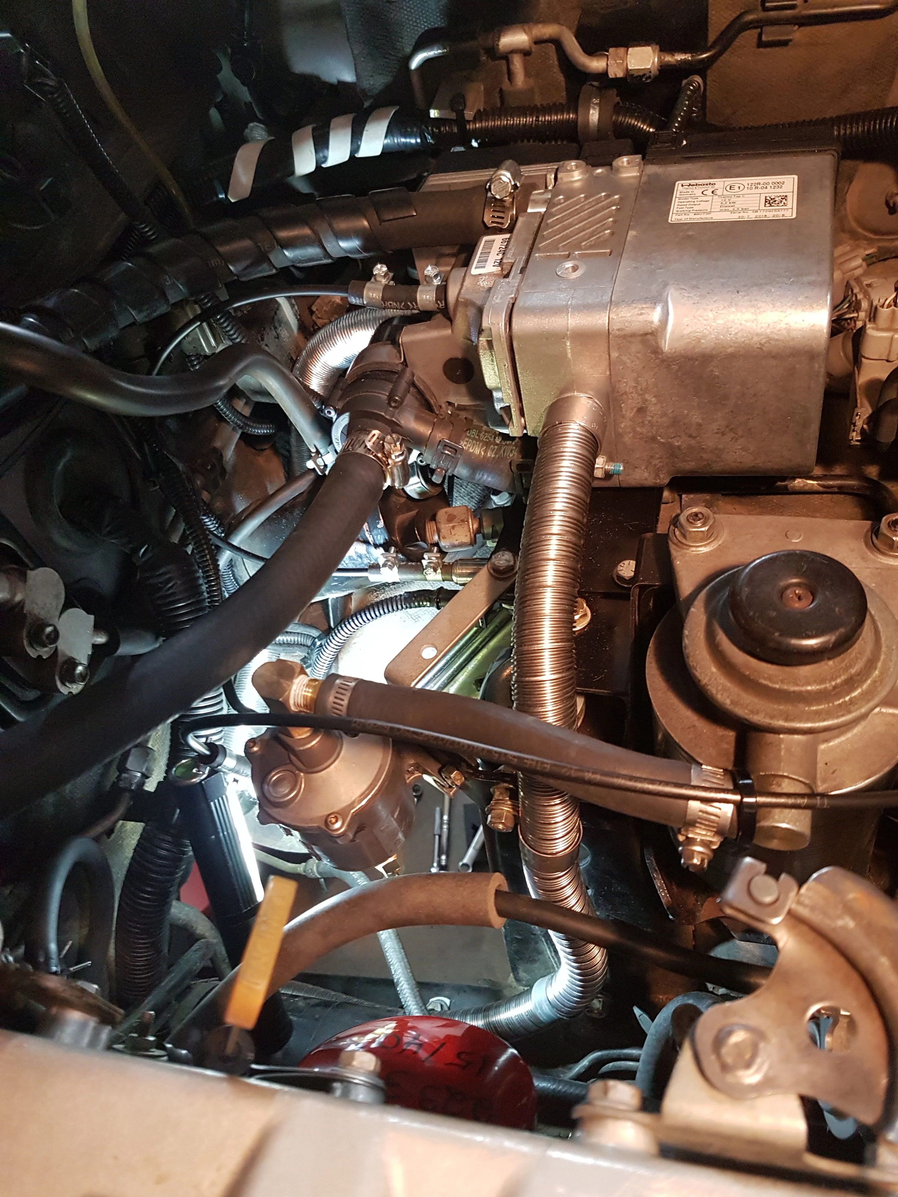

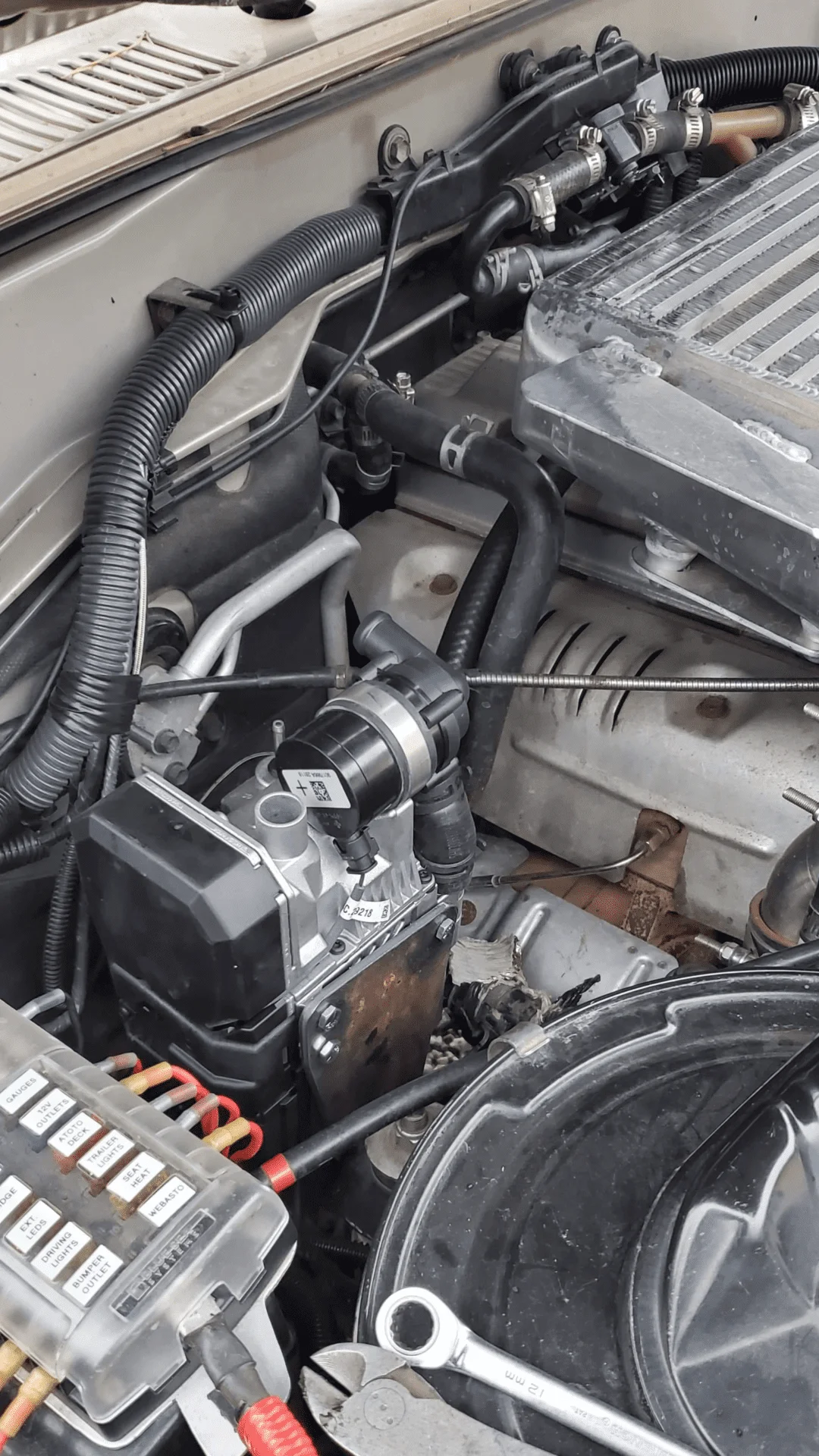

Just finished mounting a Webasto on my HDJ81. This is my second install of a Webasto, the first one can be seen here:
Webasto Install BJ74 13BT
I chose to do it a bit different then other people in this thread and mount the Webasto on its side. Honestly I dont love the location on top of the fender and would have preferred to mount it a lot lower but there really isnt any other good spots. I spoke to a Webasto tech and he said as long as the circulating pump is 6" below the rad cap it will be ok.

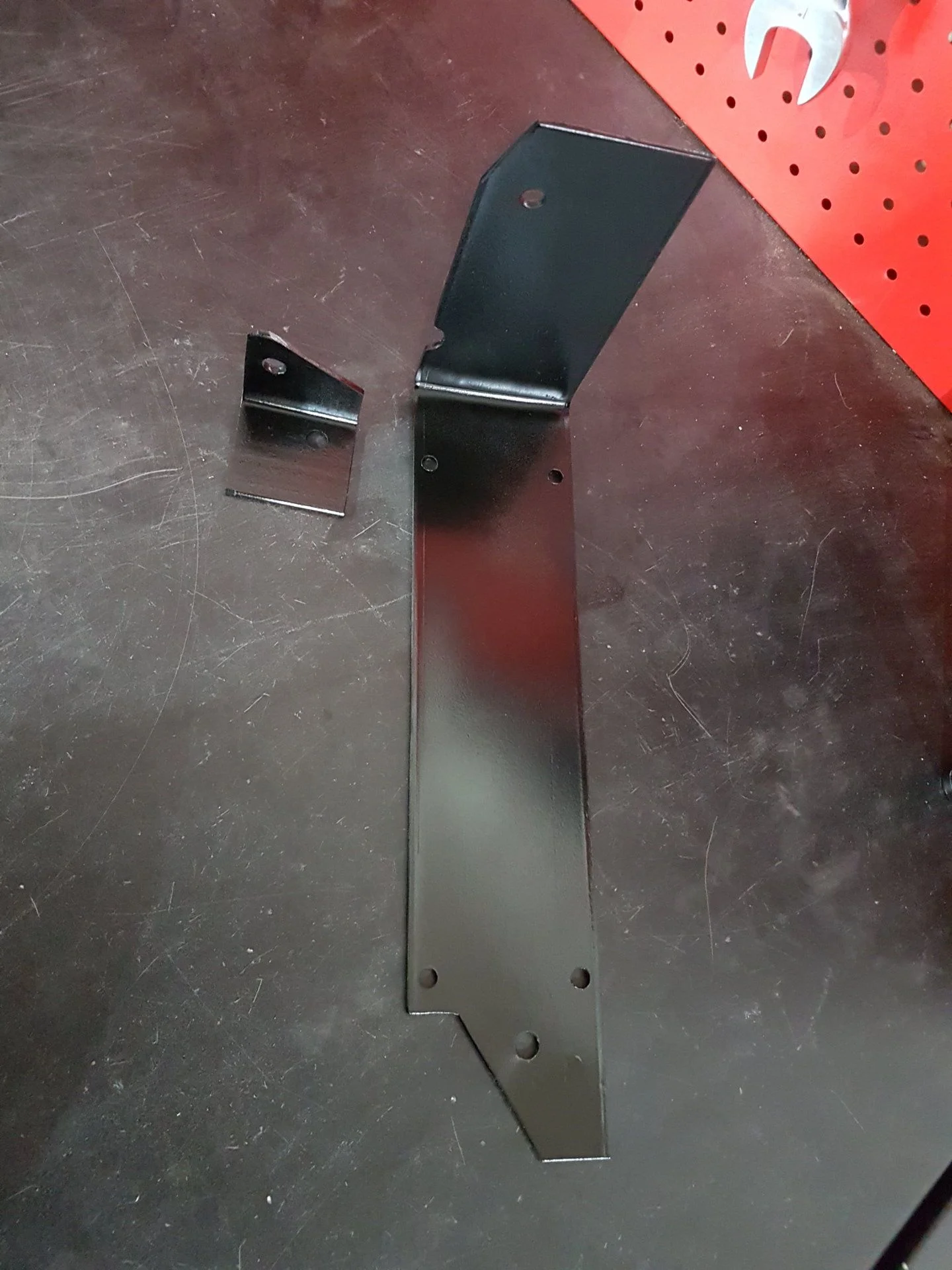

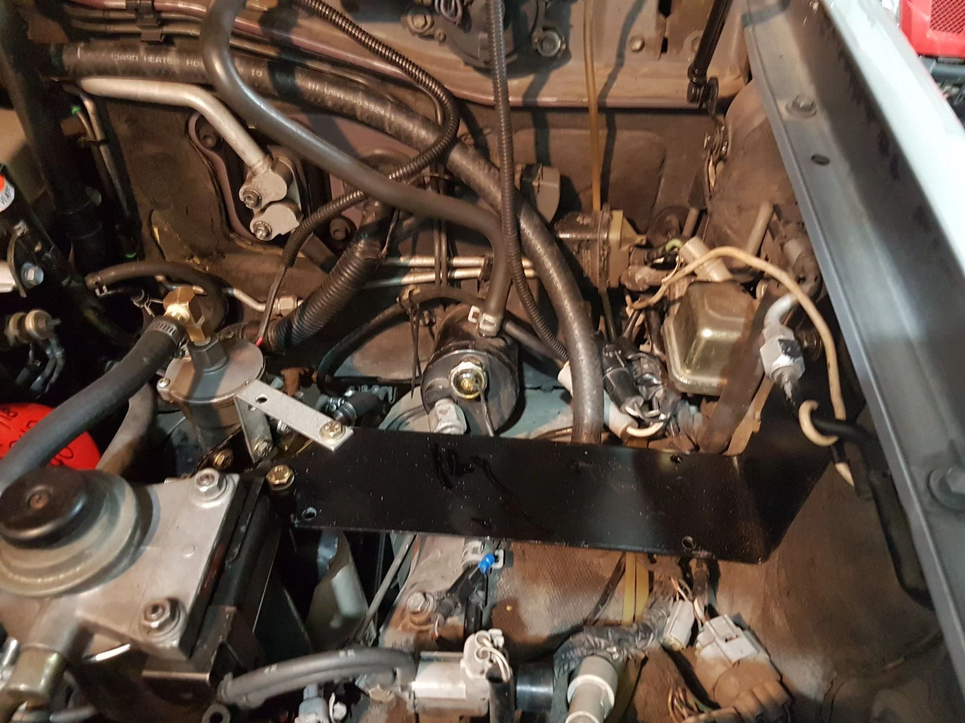

First step was making a simple bracket that allowed me to utilize existing the threaded holes above the fender and on the fuel filter mount
The white wire in the pic is for pulling the wiring harness for the switch through the firewall later
(yes I have an auxiliary fuel pump added, ignore that or discuss it over on this thread:
Electric fuel pumps on diesel Injection Pumps)

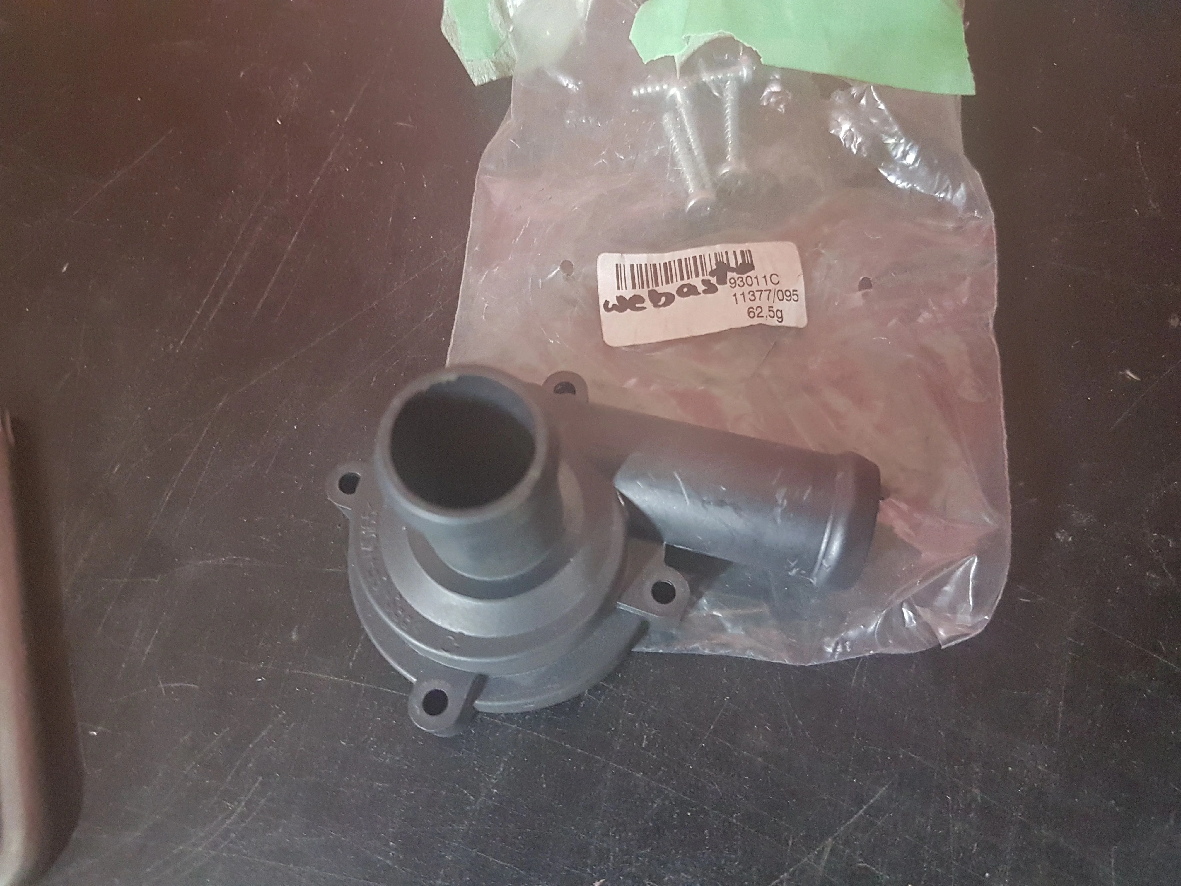

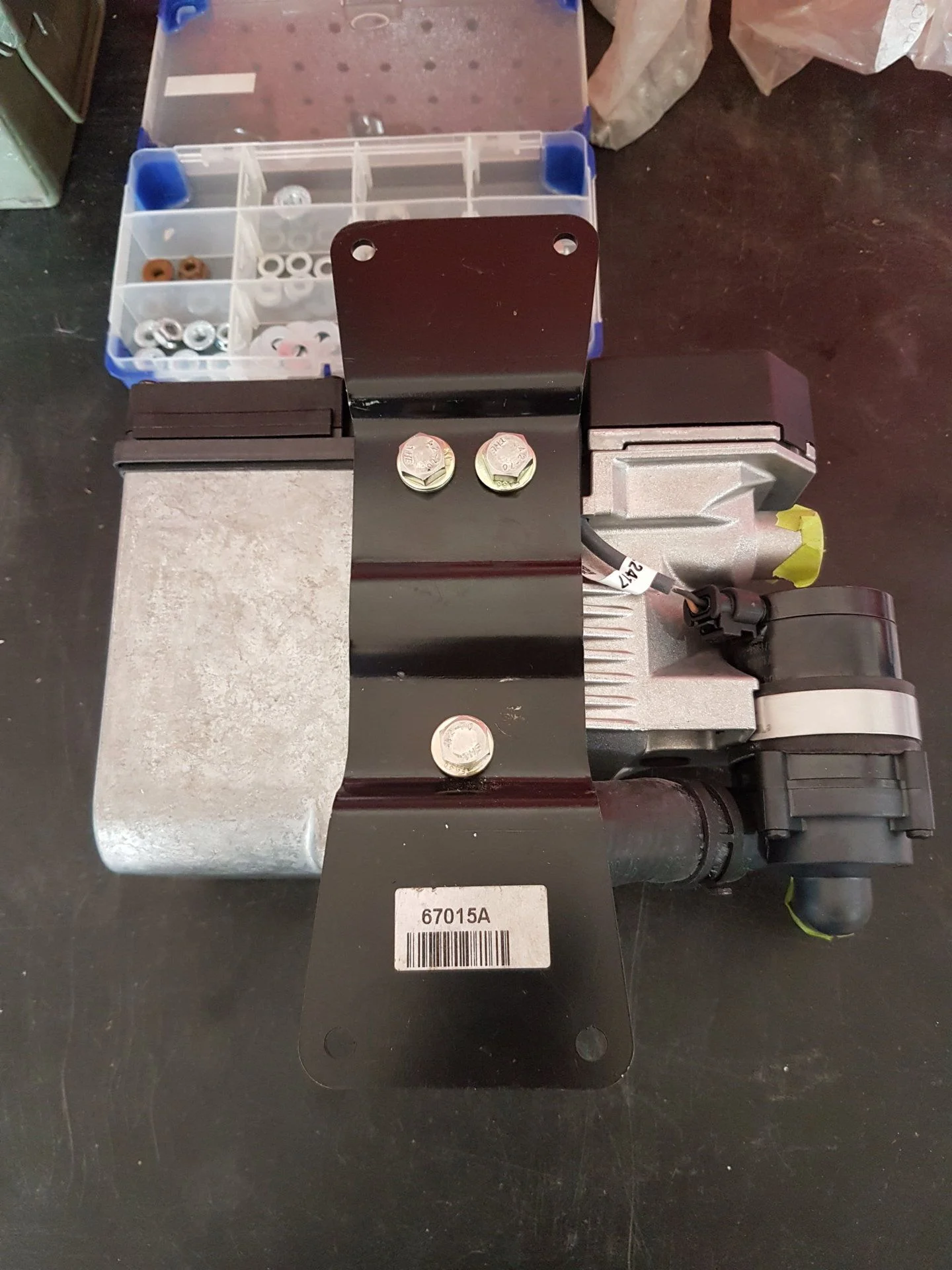

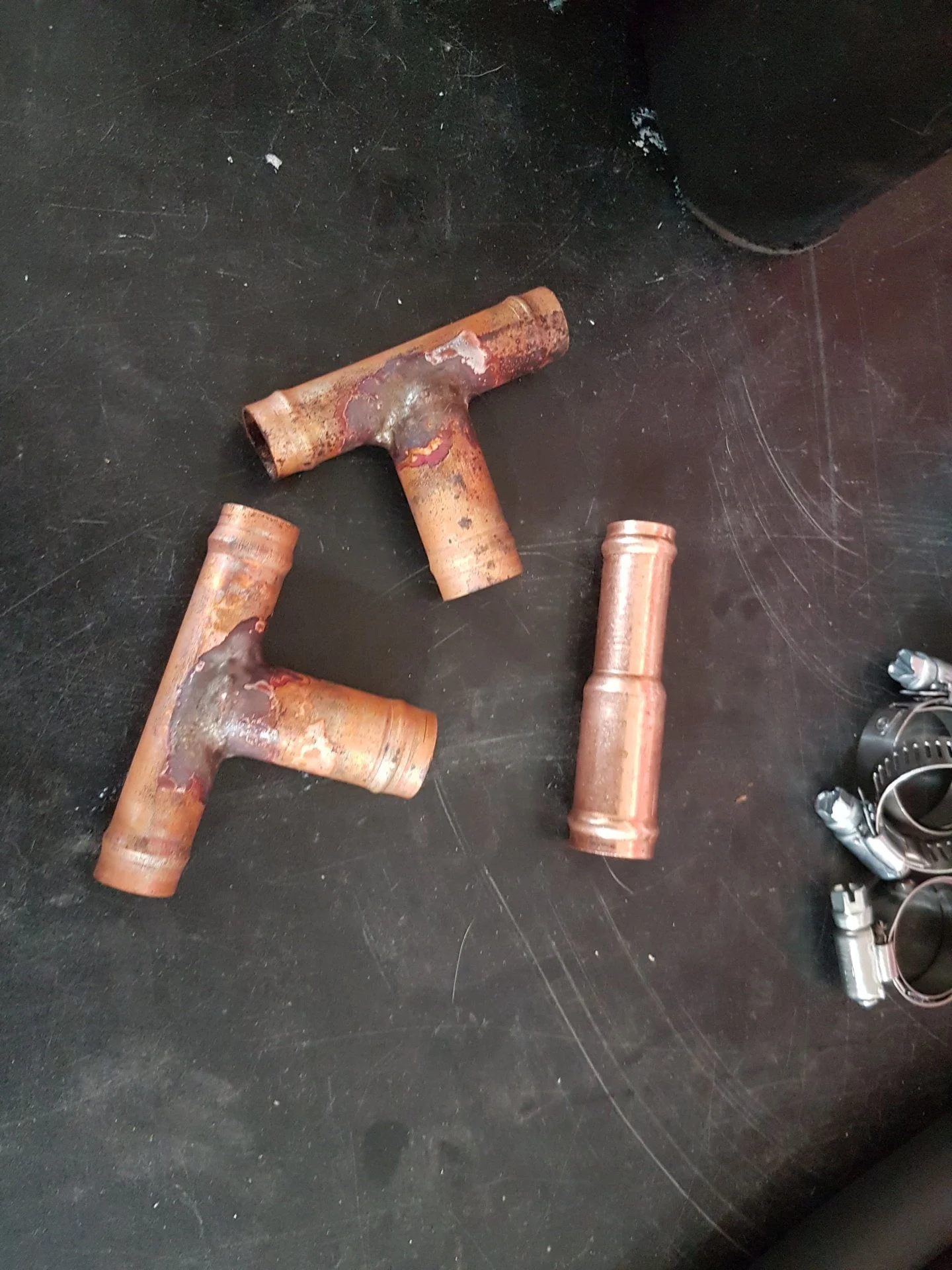

Next I mounted the Webasto to the heavy duty frame bracket I had ordered and didnt use on my first install. I didnt really need it here either but it makes installation and removal easier. I also ordered the optional fitting for the bottom of the circulating pump to change the direction the hose nipple points. As well as getting some 5/8" x 3/4" coolant T's made at a local rad shop to eliminate the need for the reducer hose barbs supplied in the kit

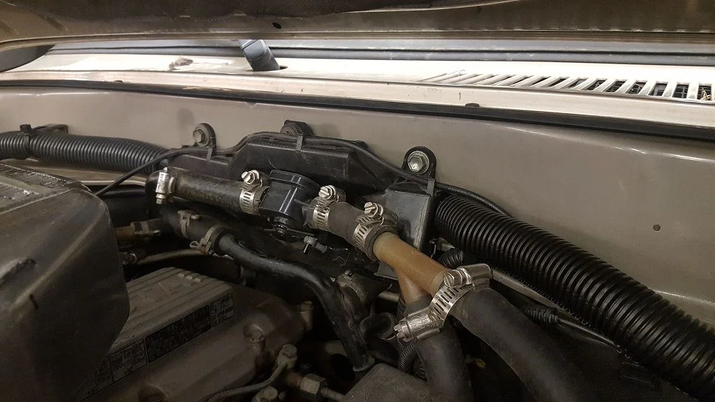

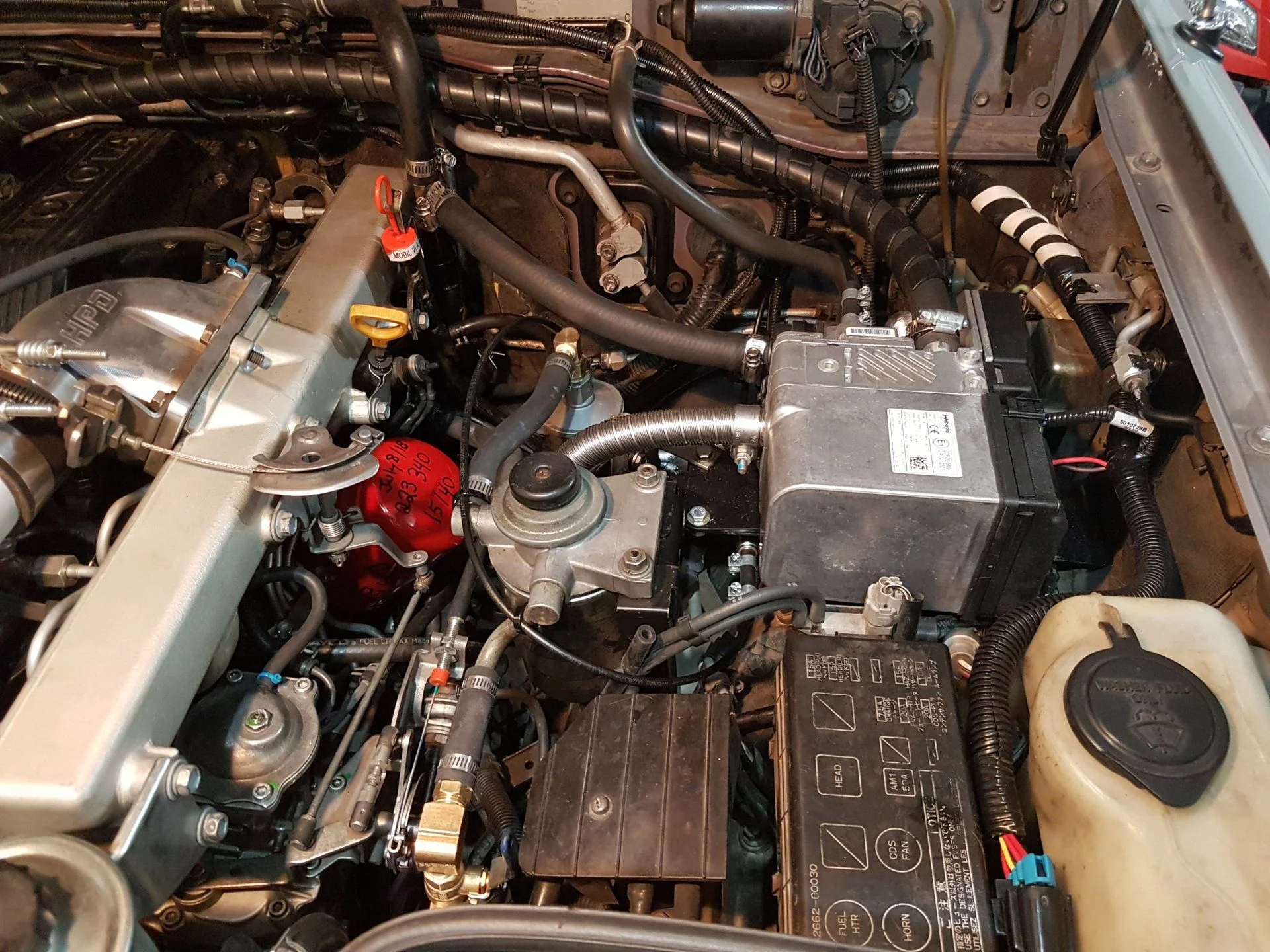

For final install I chose to T in the coolant lines before and after the cab heater core. This way I never have to remember to leave the heater on hot when I shut off the vehicle to avoid dead heading the Webasto circulating pump. Also as you can see by laying the unit on it side it made routing for all the connections very clean. I am especially happy with how simple the exhaust comes off and goes down along the frame.

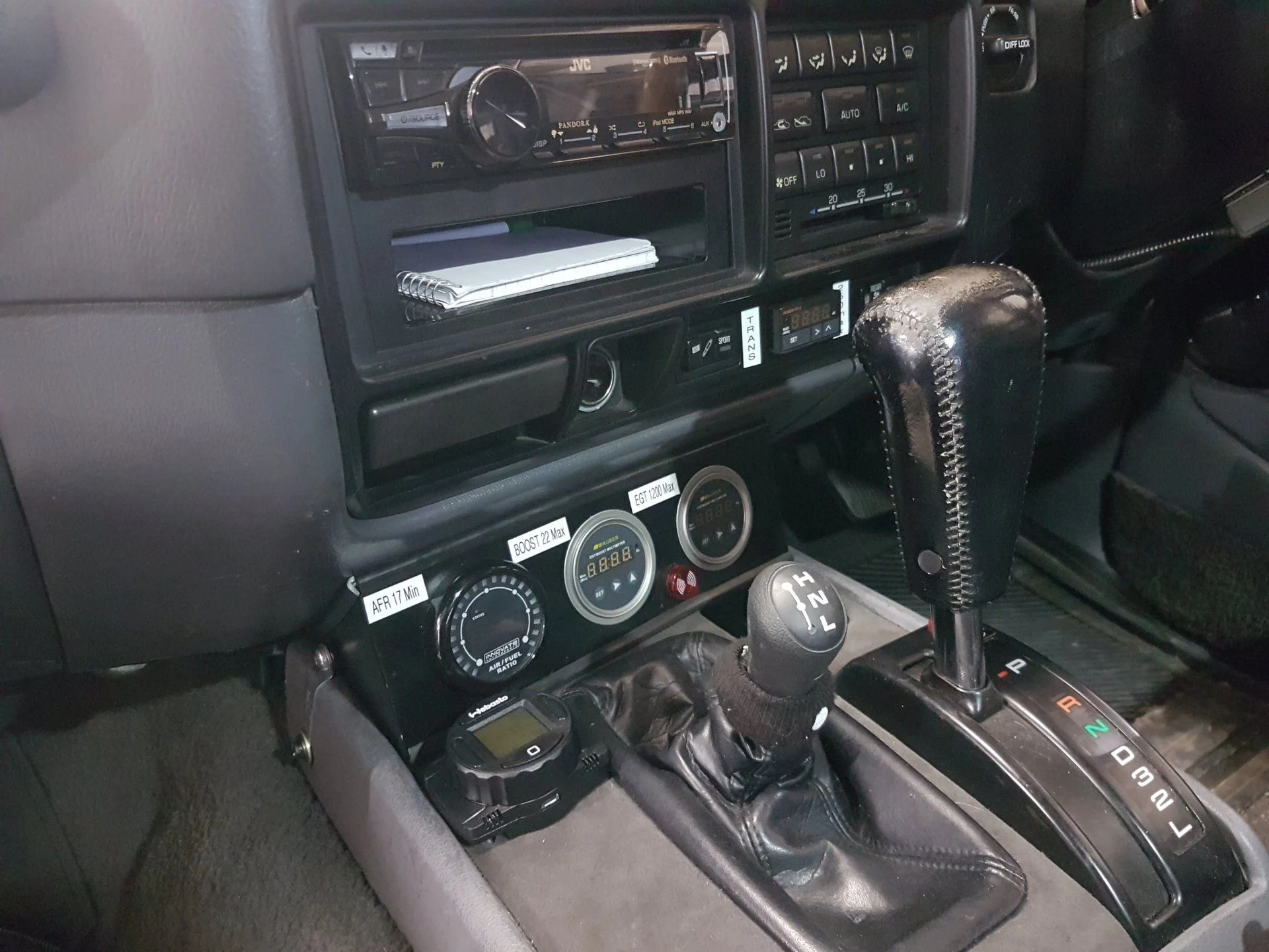

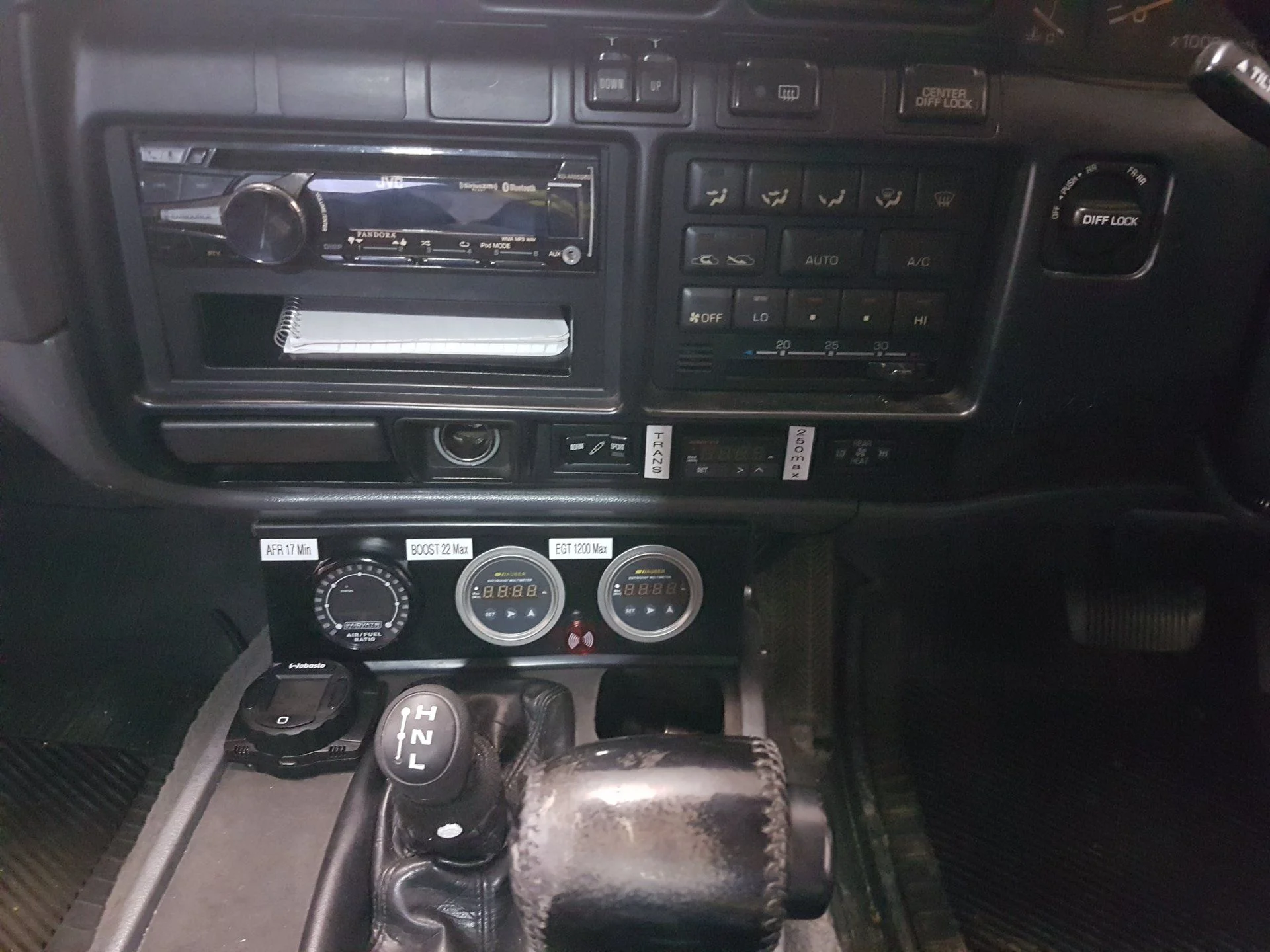

All thats left to do is mount my timer. I'll add a pic or two of that later
If I was to do it over again, I'd mount the Webasto sideways with the exhaust firing towards the engine block, it would make for a much easier run for the exhaust.

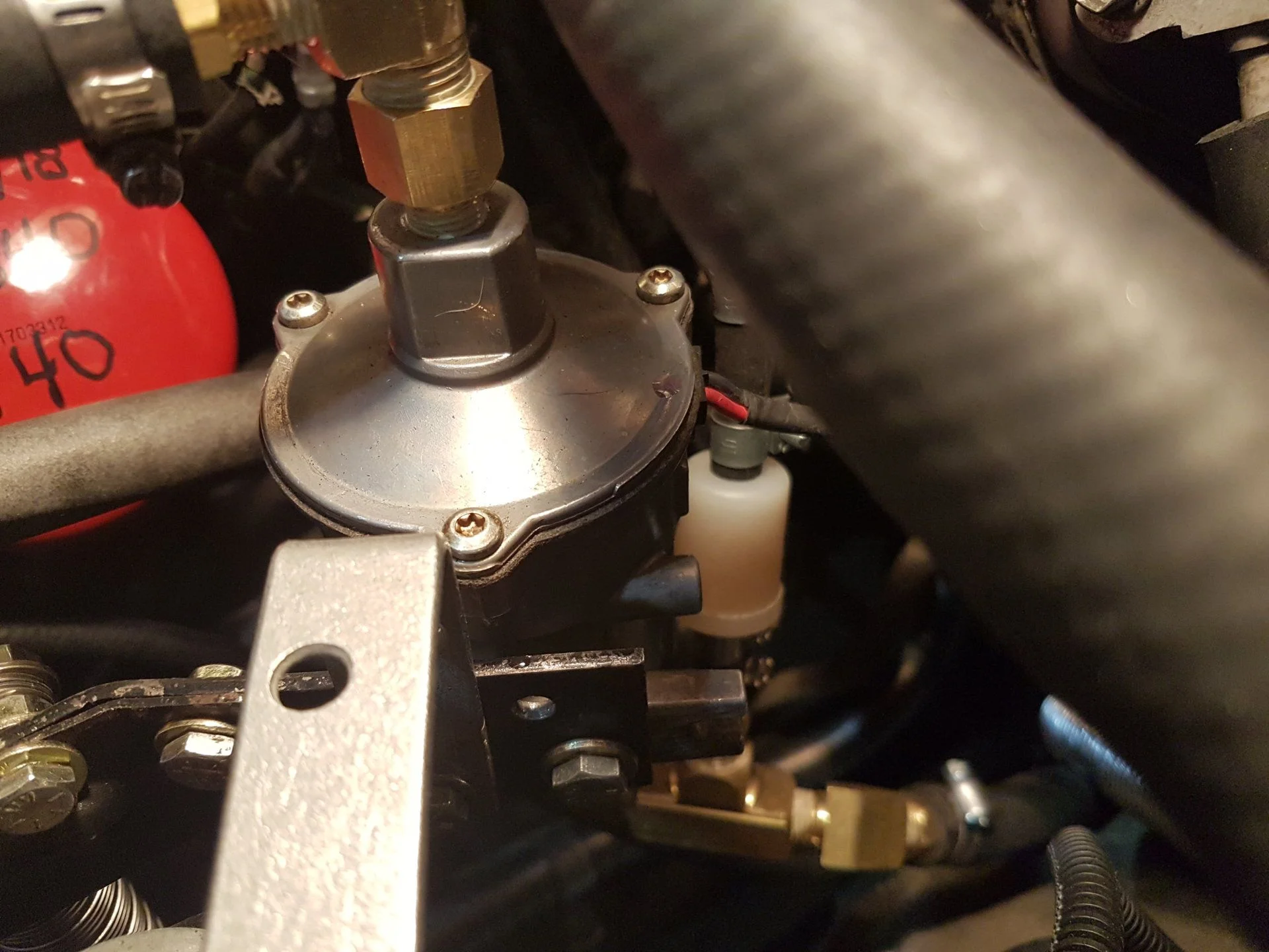

@Malahki That is very clean. Out of curiosity, whats with all the plumbing between your fuel filter and IP?
edit- Curious about before your filter too.
Between the IP and filter i have a manual fuel shut off valve. For security and in case of a IP shut off switch failure or a diesel runaway when playing with the max fuel screw.
Before the filter I have an auxilary electric fuel pmp and before that is the T for the webasto fuel supply
EDIT: Just noticed in the pic my webasto fuel filter is upside down. Doh!
i have the same timer and agree it’s awesome. only thing i wish i could get was the smart phone controlled module. it runs off gms sim card though and the only company that sells them in canada had crappy coverage so anywhere i could use it i would have block heater plug in access. i’m still playing with the idea of a sim card controlled relay but don’t really have time to monkey with it for now so i’ll just use the timer

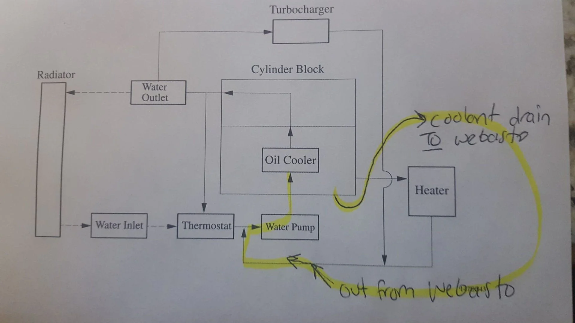

I'm installing my new Thermo Top C into my 1HD-T powered LX450 (LHD), it's going to be mounted off the right side shock tower, kind of beside the Cruise control motor. I have a blue sea distribution panel right there so power sourcing will be easy. I have zero room on the left hand side due to the ABS module, LHD brake booster/cyl, steering shaft, etc...
Previously I had installed a percolating style 110v block heater, it sourced coolant from the block drain, nice and low... just under the IP. So my plan is to re-use that coolant line as the source for the Webasto... run the input line up and across the engine kind of like how @Malahki did (except his is the output line, of course).... to the Webasto, then from the Webasto directly into a Y connected to the heater core return line back into the engine. This, like @Malahki 's setup, would bypass having to run it through the heater core first before it reached the engine.
The only downside I guess is that the coolant line has to go up and cross the top of the engine near the firewall. Would be better to keep it less in the way, but... not sure how to accomplish that. Perhaps a custom 5/8 hardline as it crosses the engine? Maybe as simple as zip ties... LOL damn rednecks.
