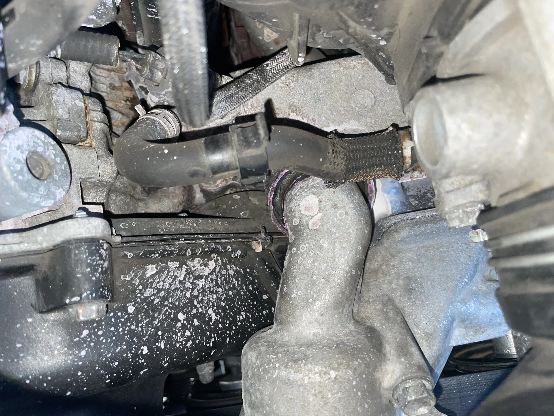

Just finished the timing belt on my newly purchased 07 470. Everything went fine and I’ve driven for about 150 miles but I don’t drive very long trips, 10-15 minutes each trip never in traffic. First long drive I took it out, and while sitting in bumper-to-bumper traffic I noticed my AC quit blowing cold. I looked down and saw my thermostat approaching/touching red. I turned the heat all the way up and the temp dropped back down, probably in less than a minute. I got it home, added water and tried to burp the system but kept getting a tiny bubble every 2 minutes or so.
I found what I think is a rolled gasket on the inlet hose. I’m going to try and find a replacement local tomorrow, I think a Fel Pro 35555 looks close.
What are the odds I blew the head gasket from running it hot, even for such a short period? Will the rolled gasket cause bubbles in the burping? Still trying to trouble shoot but I can’t get back out to look at it until tomorrow evening and I’m stressing.
That o-ring needs replaced. If done with every timing belt job it isn't a problem. The factory Toyota part is cheap, just get that.

I did replace it during the TB job, I think I rolled it when shoving the inlet tubing inside. I’m worried the local Toyota won’t have it.
I had the same problem when I did my TB/WP. Mine got deformed when I installed it, when I did it again I applied dielectric grease on that o-ring seal and that fixed it.

Gotcha. A little lube helps next time. These things tend to chew up and spit out aftermarket parts, personally I’d get the real deal even if it takes a few more days.

I always try to run OEM and will probably end up having to wait, I just hate the fact it’s spewing coolant all over my engine. Underneath is already a mess. Brake parts cleaner isn’t doing a good job cleaning.

That’s more reassuring than not, thank you. I found a gasket local to me and I’ll be replacing this afternoon. I hope after I replace and burp again I don’t have any bubbles, that’ll be the sign.

I replaced the gasket and everything sealed up. I bled the air out and no bubbles at idle for 10 minues, but every 2 minutes or so at 2k RPM’s I’ll get a large bubble. Can this be from the coolant circulating?

Do you mean bubbles in the overflow tank, or the radiator with the cap off? I would just put it back together with a new radiator cap, and drive and see what symptoms arise (if any). A blown head gasket (if the problem) should show up more dramatically.

Bubbles from the radiator with the cap off. I bought a new OEM radiator cap and have been driving it. There’s a very small amount of coolant that’s come out of the radiator cap. I guess I have another leak causing air to get in the system or blown HG. Gonna buy a lisle combustion leak detector today and rule out or confirm HG
