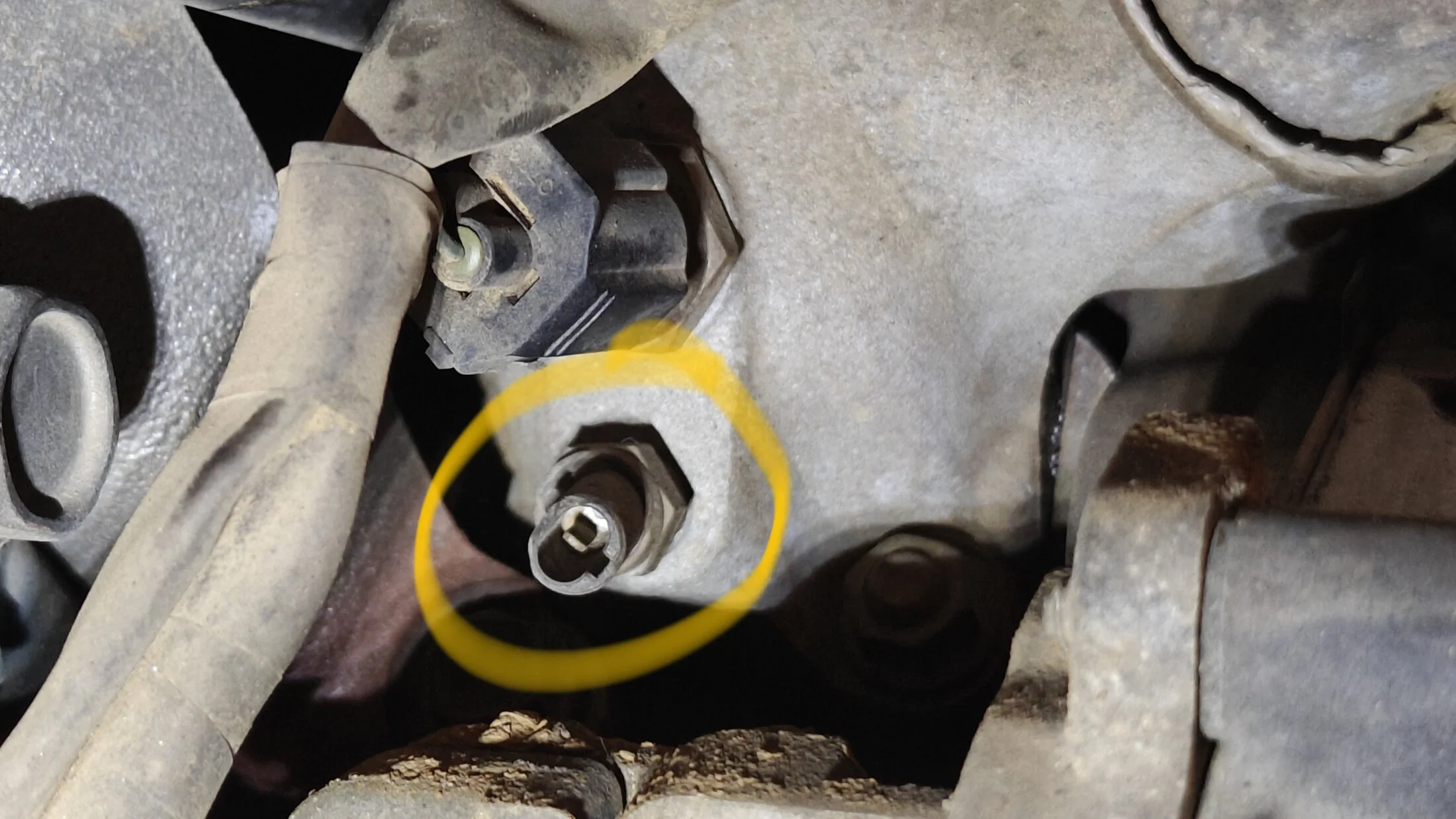

Hey all I'm relatively new here I've searched the thread but I can't seem to find an answer for this.
I just bought a 2003 lx470 recently and I'm looking to restore some things. Does anybody know what this fitting on the water inlet bypass on the front passenger side of the 2uzfe is for it looks to be metal and there's something inside it's sealed but I'm not sure if they're supposed to be something connected here or not?
I've circled the part of the component in question I would appreciate if anybody has any info and what this is or if I should be concerned that it looks like this.
That looks like the coolant temp sensor, also someone hacked this truck up, using RTV on the thermostat housing and water inlet.
Ok so is it normal to be open like that? There is another plug to the right plugged in so is this exposed one normal for ambient temp? If something is missing that goes here. I can't find any good diagram for it online as far as I can tell.

Coolant temp sensor. Is the gauge on your dash working?
Guage on dash does appear to be working yes. Is it possible the connection to the right is temp sensor which is plugged in? Or is that something else?

The other sensor plugged in next to it is indeed the temp sensor. I have no idea why this sensor (that you posted about) is there and left unconnected, but it's like that in any 2UZ I've worked on (LC/LX/Sequoia/Tundra/4Runner). The 100 series was the first vehicle to use the 2UZ, so it's not something that Toyota started off using and then ditched later on - it just never was used. I don't know if the 1UZ engine in the LS400 used this same part and that sensor was connected?

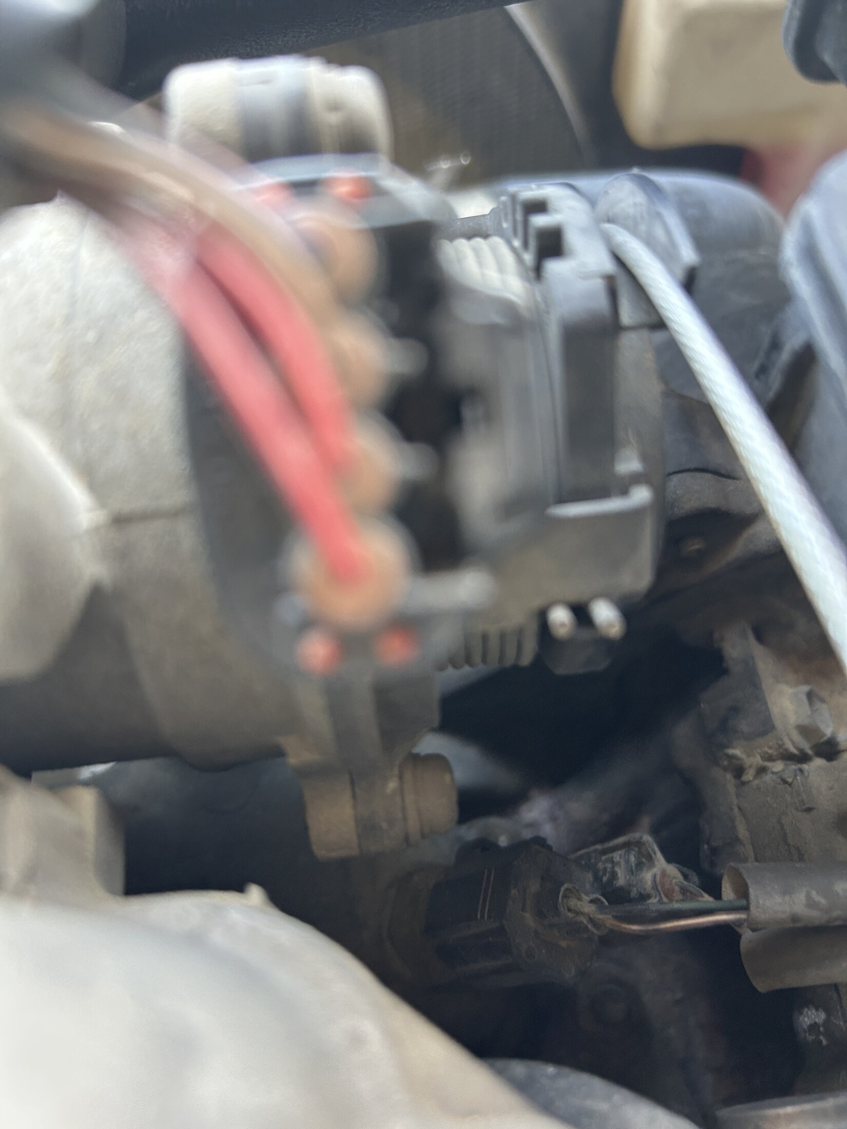

I have a connection to that sensor so apparently I may have a unicorn if I’m understanding correctly. Looks like a single wire connection

Interesting. Good to know it's probably normal and since the temp gauge works it must be the one to the right of this one.
Interesting. What year is yours? I see the cable for throttle in your photo which I understand as of 2003(my yr) was changed to electric. Perhaps the 2002 and prior models used it as both connectors in your photo come from a harness but I only have one connection. Maybe Toyota made a change in 2003 and left the part as to nod reconfigure it? It's seems to be a mystery at the moment.
