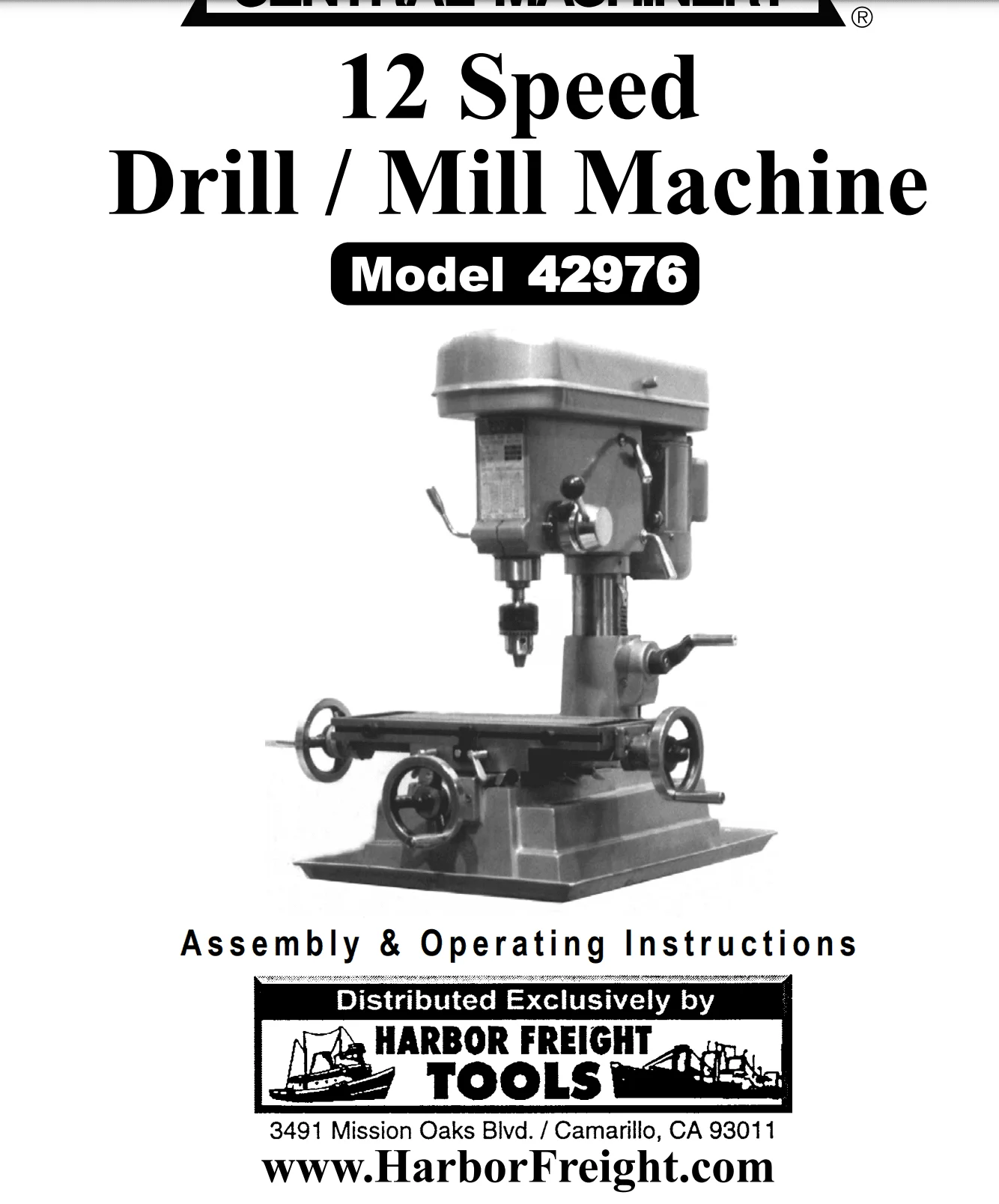

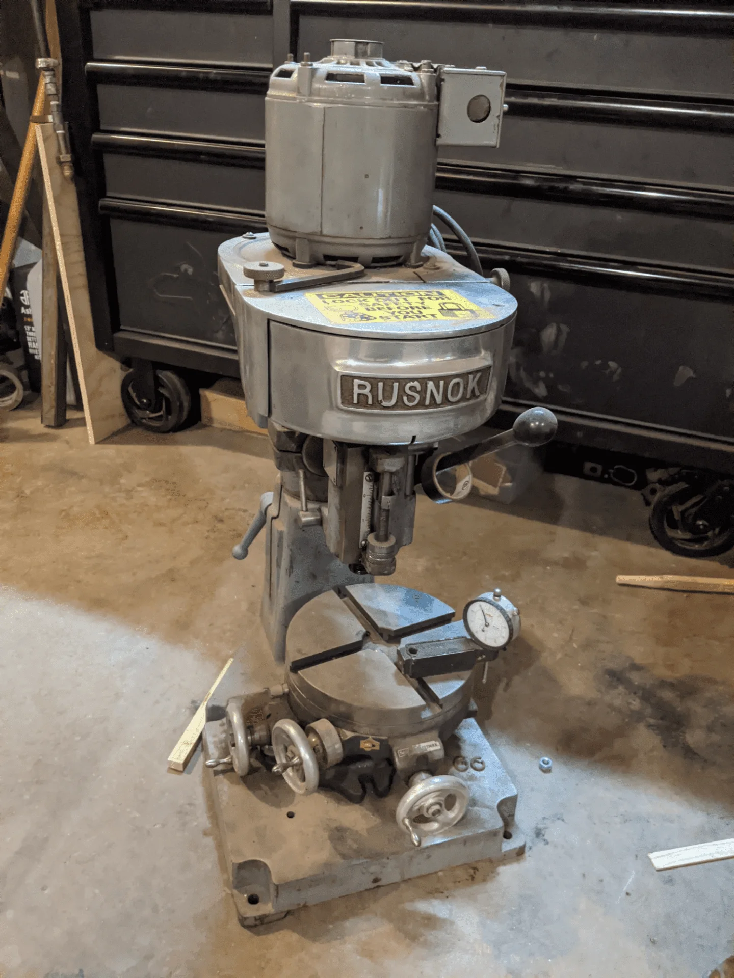

As I'm looking at cross slide vises, I quickly went down the rabbit hole of drill/mill machines. Given that I'm going to be needing a XY plate to mount a cross slide vise, I was curious what kind of price an actual drill/mill machines are fetching. So far it looks around $800 and up for a bench top machine and quite a few vendors are selling the same unit with different branding, similar to this one. I'll keep an eye out for an used machine as I just learned a local buddy recently acquired one of these bad boys so I'll be heading over to his place to slot some holes in some brackets I just finished building.
just be realistic as to what you can expect with a level of machine like the HF one. This is likely not going to be sufficient for some serious machining. Sure it'll be better than a drill press but I think it is unrealistic to expect good thou-level work with those unless you go to excruciating manual measuring etc. They are just simply in a different class than your typical pro Bridgeport and the like. Having said that, I would have (and may well) have great fun with a 3 in one little benchtop guy for my not so demanding wishes/needs.
But as to your question, why do you need a cross slide vise if you are going to have a milling machine? These normally come with a table and you can use a regular mill vise. Are you thinking about using an xy vise on a drill press? That would not work very well, typically, they are just not built for side loads.

The older HF units seem to garner a decent reputation vs the newer units. I'm going to look at the buddy who just acquired the beautiful bench top mill above as he has an older HF mill/drill machine. On second thought, who am I kidding? I'm not going to be looking at it, I'm just going to buy it I know me. :bang:

The machine is now at my place and it's a heavy sumbitch :oops:
Thanks for the info Eric, very helpful. This $150 purchase was gonna happen no matter what so I'll deal with whatever comes my way as there're plenty of online machining geeks who thrive on improving HF junk. This is an older unit that my buddy has never used as he doesn't know how and he got it on a trade, years ago , so it's been collecting dust for a while.

$150 is not much, and you got some bits, you can't go too wrong with that. And if you got that green vise, too, well then it comes awfully close to errrr.... not possible to resist territory... :) It does look a lot like a regular drill press besides the table. Does it have some sort of heavy duty quill built for milling? Morse taper?

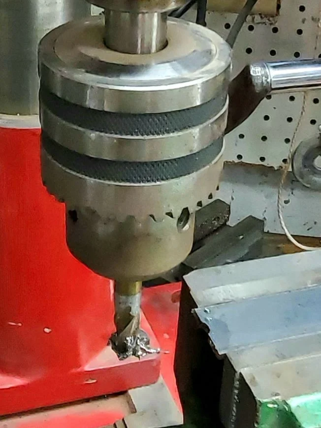

I bought that HF machine new about 5 years ago. No complaints except what is known....the round column. One of the first things I did was put an 8" or so long piece of 1" aluminum into a 4" Chinese Kurt vise knockoff and ran an endmill across the top end to end. All I did was clean the cosmolene off everything no indicating of anything. That aluminum piece was parallel to within a thou end to end.
Maybe I got lucky. But its heavy stout and powerful. Mine lets me work as accurate as I'm willing to put the time into.

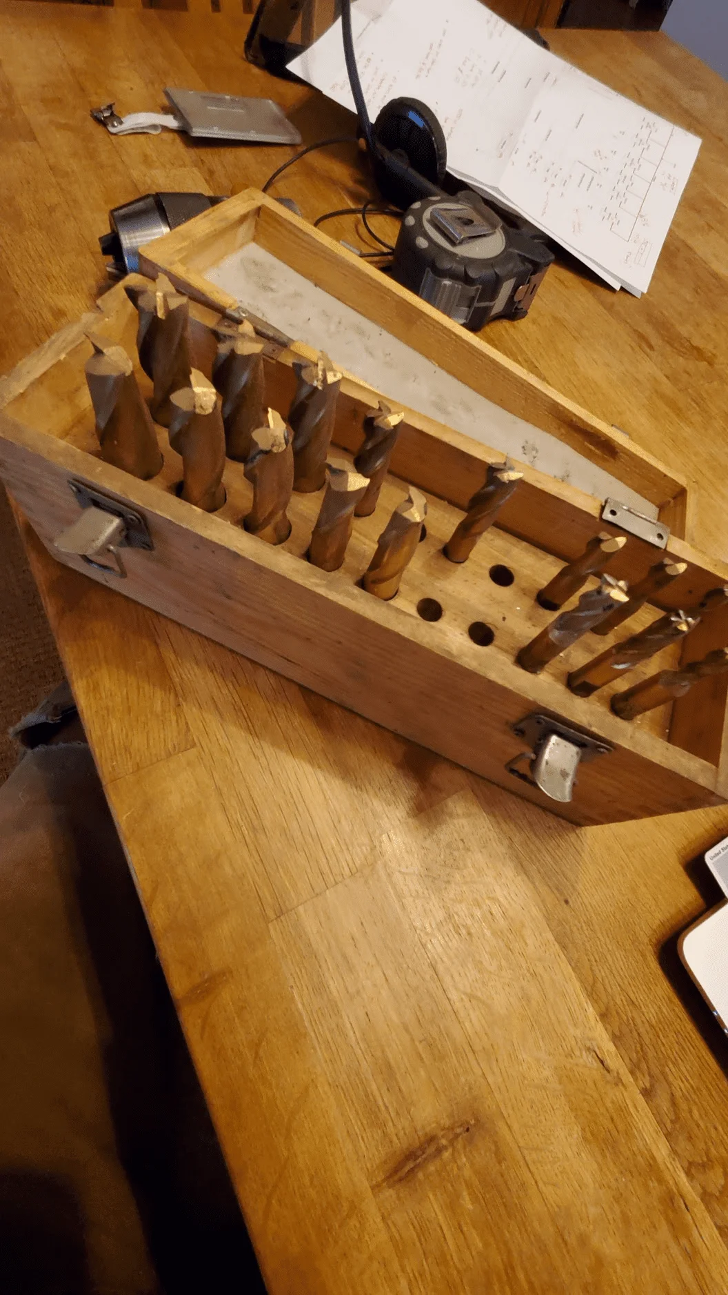

I do have some bits so it'll get me started. Mind you, I have NO idea what I'm doing but I have a project where I need to slot some 3/8" holes on 1/8" thick steel.

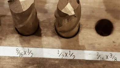

Can someone please tell me what does 1/2" x 1/2" marking mean? I figured the diam of the bit is 1/2" but not sure what the second 1/2" number means!

Pretty sure the first number is the cutter size and the second is the shank size.
ahhhhh, that helps. Thanks bud.

Did any R8 collets come with it? Or just the drill chuck? Cheap on eBay and worthwhile if you're going to use it much.
Can you please share a link so that I know what you're talking about! I'm a total newb 🙄
R8 Collet Set
Each one is sized to the specific mill or drill you are going to use. I assume there's a drill chuck in the spindle of your mill. To use a 3/8" end mill to make your slots for example you would use the 3/8" collet (unless you have a 1/2" shank on your 3/8" end mill).
Anyway for the money they are a lot stronger and more accurate than the drill chuck. But the drill chuck will work.
^ it does not look to me like this machine is set up for an R8 system.
