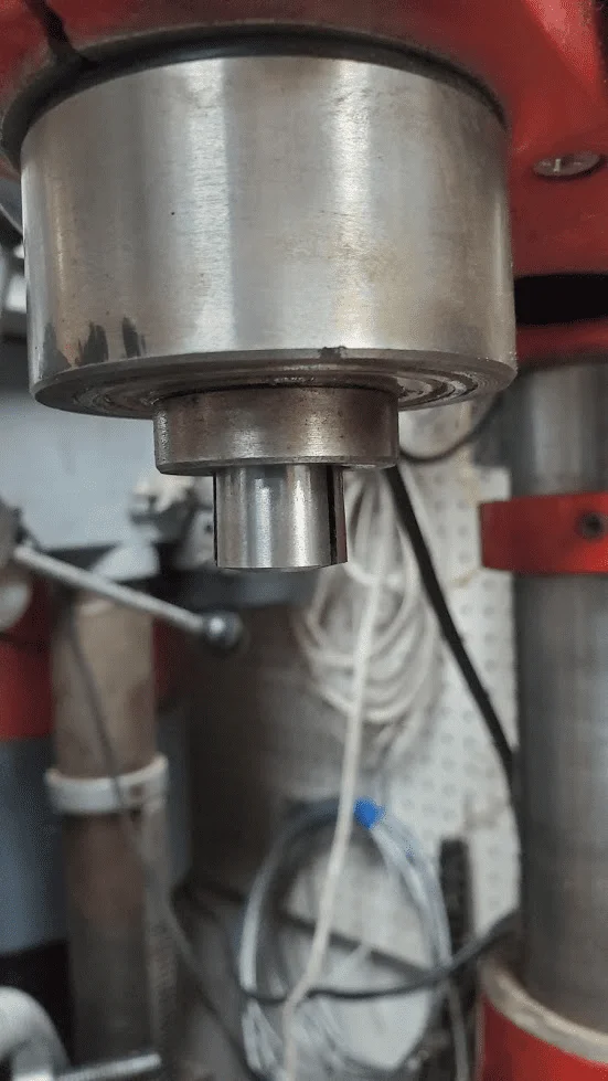

Was looking for a Cross slide vise, but found an older HF mill/drill machine instead!!
The M2 collets are in and ready to go. Ebay purchase, nothing too crazy expensive but will get me going in the right direction. :bounce:

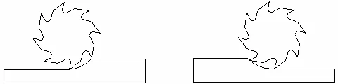

So now that you have a better and safer way to hold cutters (end mills). You might consider conventional milling. I highly recommend this for small bench mill/drill. The lack of rigidity and possible backlash in your table screws can result in a poor quality cut (vibration) or worse tool breakage. On your final pass of say 1-2 thousands, you can Climb mill for a better finish.
For slots, I recommend Plunge milling to produce the main slot, then finish the clean up using Conventional milling pass. Start your slot by plunging, then overlap 1/3 and rinse and repeat until you have the profile you're after.
Climb milling vs. Conventional milling
page24image1385535136
Climb milling vs Conventional milling
Depending on the direction in which you move the workpiece against the end mill you are either climb milling or conventional milling. As shown in the illustration above, you are climb milling when the end mill turns as to climb the slope made by cutting.
Climb milling has several advantages, and is often recommended for modern milling machines. The flutes dig in to material with a climbing action, and the workpiece and rotation of the cutter are going in the same direction. With this forward stroke the tooth starts with a full chip and pushes the workpiece down against the table or holding device. This requires less machine power, the cutter does not dull as soon, and a better surface finish is produced.
However, climb milling requires a very rigid milling machine with virtually no backlash. Because the workpiece and the milling cutter are moving in the same direction, the milling cutter tends to pull the workpiece away from the driving device if there is any backlash. This can overload the cutter and stall the machine. Or it can simply leave a poor surface finish.
