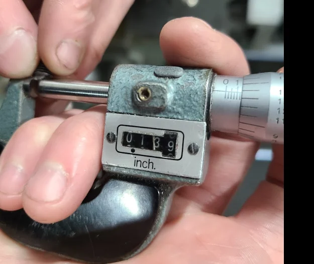

The young machinist at my work walked up to my desk and showed me this collet alignment screw. He said it fell out when he was changing out a collet and has been racking his brain on how to screw it back on to the quil assembly. The thing has a square head and it sticks out for locating the collet and gets screwed horizontally. It has an allen head on the other end but that doesn't do us any good without seriously disassembling the quill assembly.
What special tool do I need to use here or purchase? The square head is 0.139" x 0.139".
