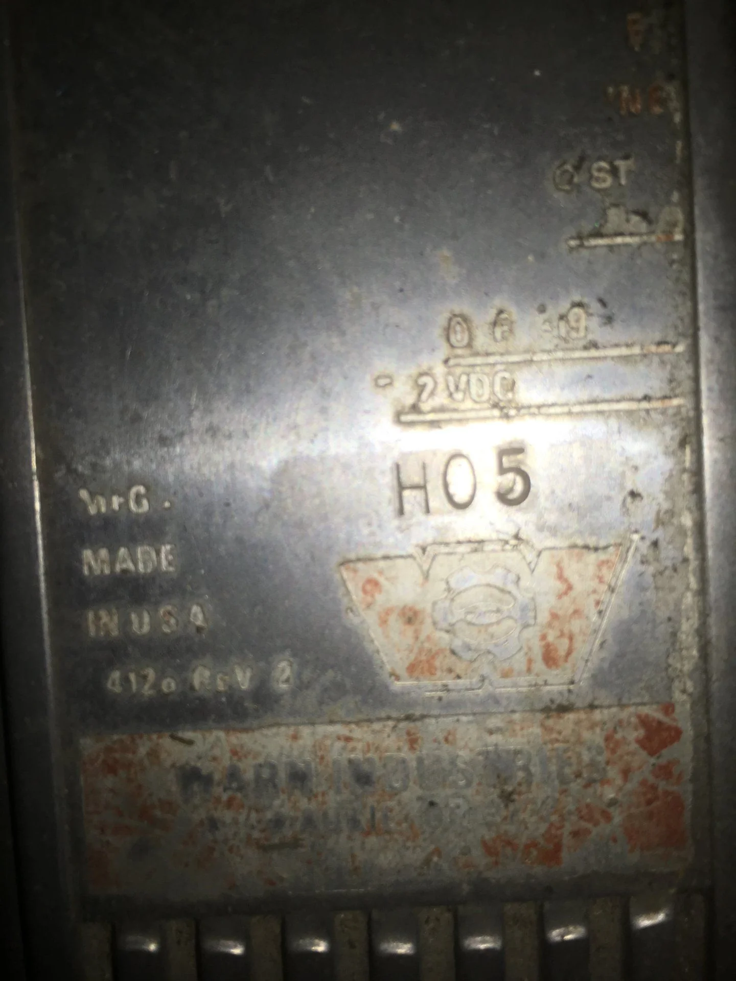

Anyone know what the date codes stamped into the label translates to ?

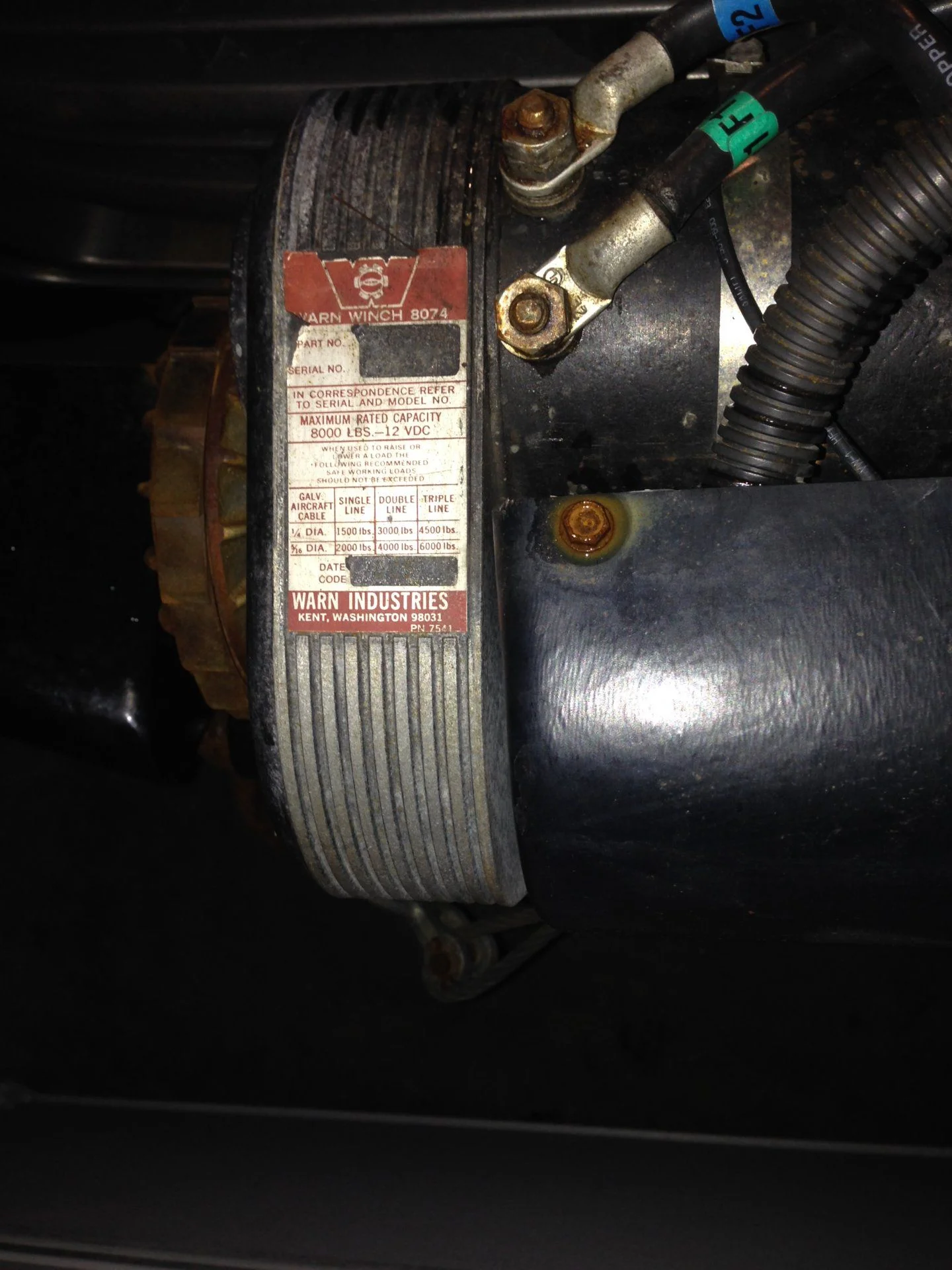

OK so GC5 sounds like 7/3/75 or 7/3/85
It never had any Jeep tag on it, this Warn 8074 tag is original, have always just put tape on it when re-coating the casing in black every few years.
thanks guys, very interesting!
Yours is a '75.
They quit making the 8074 in '76 when Warn contracted to rebadge the 8274 with the Jeep Special Equipment badge. Prior to that, the 8074 was a spec contract with Warn that didn't include rebadging. All 8074's out there came from a Jeep dealer.

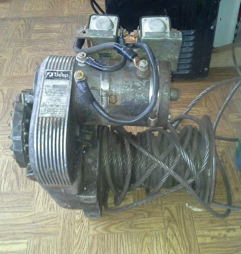

Here's my 8074 without any Jeep badging. Thoughts? Was it originally on a Jeep, just without the badging?
Yes. All 8074s were sold through Jeep. It was a specially built winch only for Jeep and was Warn badged. The 1976 and up 8274 Jeep Special Equipment winches have the Jeep badges. They are tough to fake since the serial numbers on the Jeep SE 8274s are in a different spot than the Warn badged winches, so if someone tried to just slap a repop Jeep SE decal on a non SE winch, the window won't line up correctly.

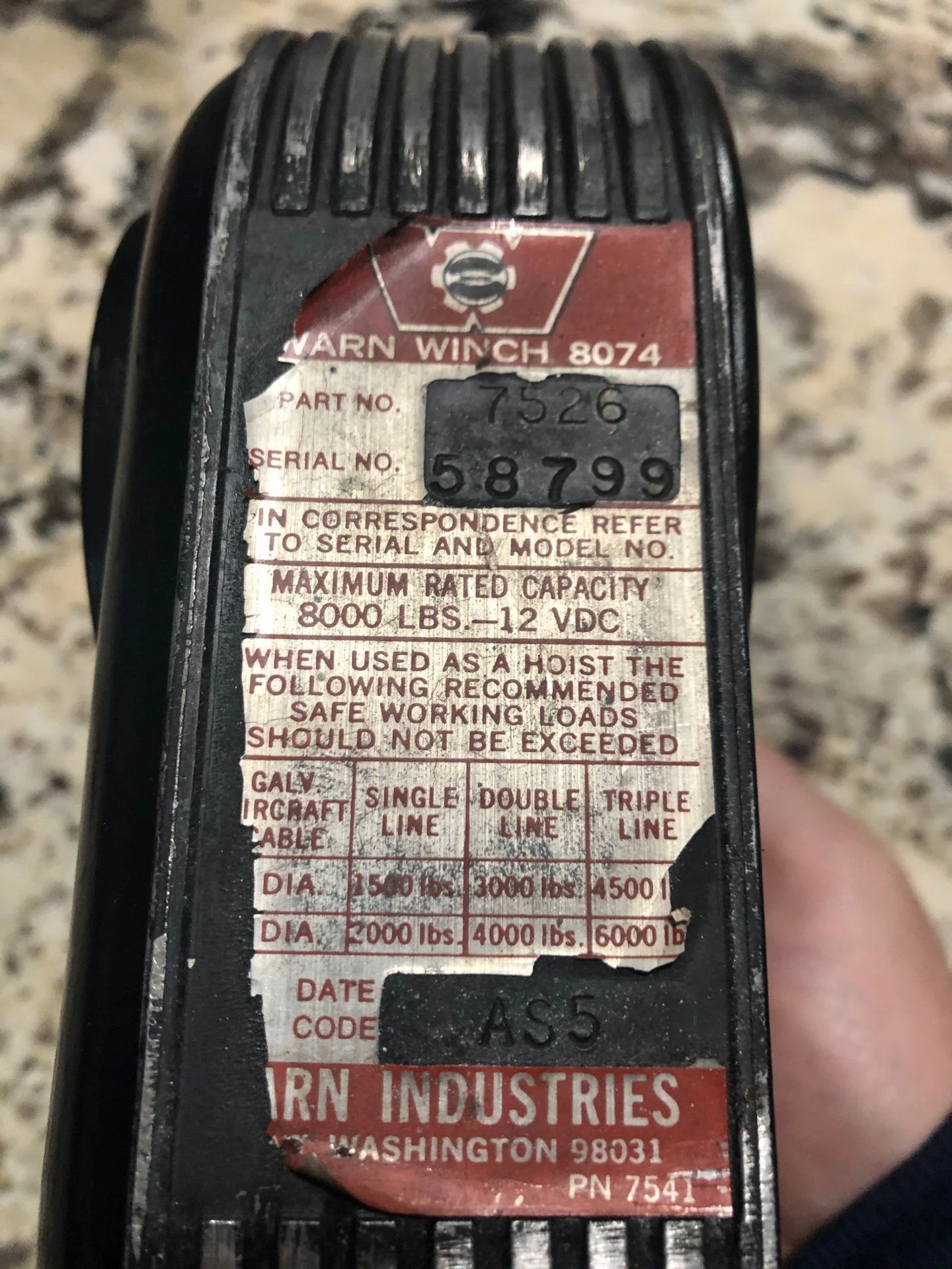

Hey guys, I've locked down a cheap 8274. Date code is CS8. It has a plastic socket, but the PO says the box was replaced at some point. Are there any other ways for me to tell if it's a 78 or 88? Serial number is 98801.
If it's a plastic socket, it's likely an '88. The '88s also had the W on the control pack painted red; the '78s had the W embossed and was unpainted.

Andy - check this pic. Unpainted W and plastic socket. I'm buying it regardless, would just like to know which year it is. Thanks.
Looks like a 78' with that style cover
They could have...looks like older cover for sure...
