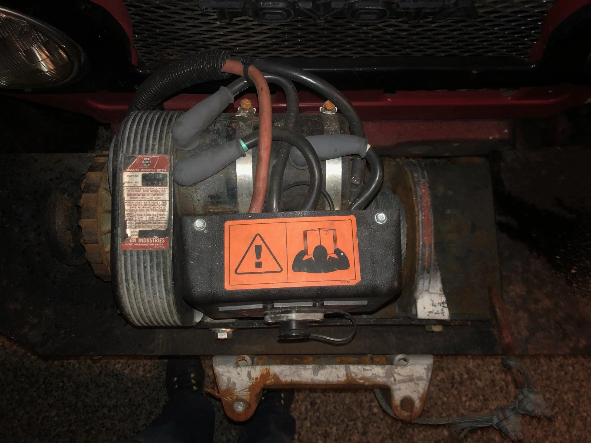

Hey everyone. I just bought a '71 FJ40 that came with a Warn 8074 winch. I've decided to restore the winch but I've hit a snag pretty early that I'm hoping someone can help me with. I've removed the circlip holding the brake assembly to the shaft but the assembly will not come off! I've tried everything but it just won't budge. I've decided to soak the hell out of it overnight with some PB Blaster. Maybe tomorrow will be different. I'm sure I'm missing something and hope you can help me out. Thanks a lot!
I had to put mine in a vice and use a air chisel. Don’t beat on the end of the shaft with a hammer, you don’t want to mushroom the end. If you don’t have a air chisel try a punch and hammer. Place the punch in the dimple on the end of the shaft and hit it hard. I used emery cloth to clean the shaft before re-assembly.
Or get a puller on it and whack it from the side while under pressure. Common challenge.
Nice clean truck, I too have an 8074 for my '73 FJ40. Time correct for restoring. Post up
some pics as you go along.
I fought with the brake on mine for a few days.
IIRC I had the plates resting in an open vice and pounded the center shaft out.
Wd40 penetrating oil for a few days. 3 jaw puller. Tap it with a hammer and add pressure.

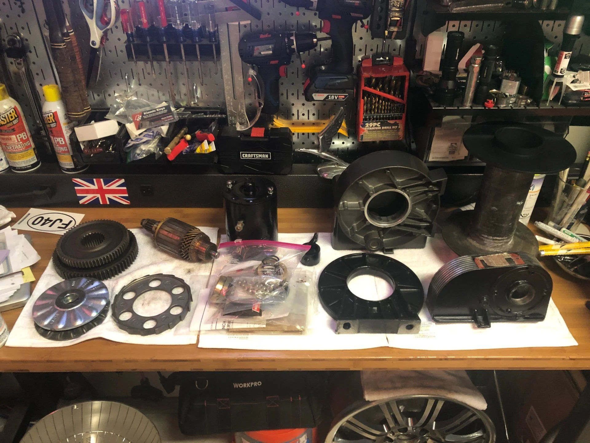

Restoration is coming along. I had to buy another pinion and splined cam which will be arriving at the end of the week. Here's a pic of the winch parts on my bench before reassembly.
Does anyone have a favorite/recommended lube and gear oil? This is my first winch resto.
The oil in my 8274's: Straight 30 non detergent. But I really don't think it matters that much. Just be sure there's no rust inside and that the oil is clean.
