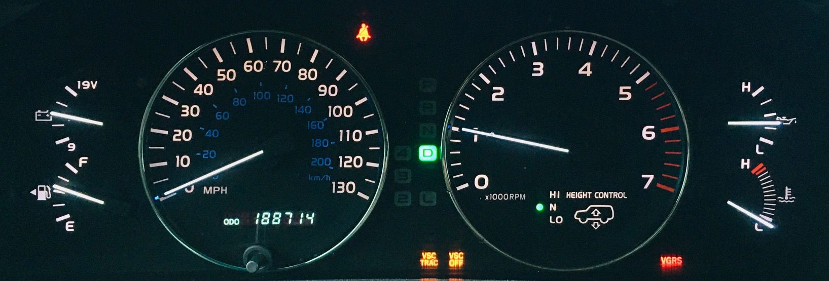

I have a 05 lx 470 with about 111k on it. I had no issues until driving it home from the hospital (the initial part of the "rain it pours") . In the middle of my drive (sitting in traffic) the vsc trac, vsc off, and vgrs lights came on. I just attempted to turn the car on and off but nothing. When I arrived home I also notice the the keyless entry stopped working as well.
This morning :
nothing popping up on my generic code reader.
keyless not working
guages flicker
vsc trac on
vsc off on
vgrs on
battery at 12.4
A quick search with similiar symptoms revealed possilby ecu problems that may require replacement. Any assistance to help troubleshoot this would be great. I haven't had chance to use my techstream and wouldn't know what to do with it anyhow. I have a kid in the hospital so I'll be attending to those matters prior. Thank ahead.

Check your 10A ECU B2 fuse in ps fuse box, it’s top row most fwd. When it goes it takes lots of things out due to the multiplexed nature of the system - affects AHC (from N to H in my experience), remote mirrors and seat memories, immobilizer stops flashing (but still starts) VGRS,VSC, remote locking and probably other things I haven’t found yet.

It was a fuse as mentioned. Vgrs goes on after a battery switch or unplugging it. But I don’t think the other lights go on that you mentioned.
Took it to the dealer and they said the VGRS Actuator (45220-60202) needs to be replaced. I was reading on mud that 'Grego' did a 'VGRS Delete' and swapped in an intermediate shaft from the 98-02 lx470 - looks like that part# would be 45220-60110.

It is the flat multicore core in the actuator that is cut
I had exactly tha same fault and i was able to tepair after welding cable in n several places

Had the same issue. I just changed the fuse and everything works. All lights are now off

What a pain it was to access the passenger side foot well fuse box!
Was also difficult to pull the fuse as well. Argh.
Nevertheless, the fuse was blown.
I replaced the blown fuse, truck started up properly, but shortly after starting…
Lights on cluster resurface, mirrors stopped while dipping, auto door locks stopped working.
Can someone please advise how I can figure out what the culprit is that’s blowing the fuse?
How am I to trace this back to the source of the problem?
Any / all help would be greatly appreciated.
My best.
I replaced the fuse again and made sure the mirror switch was in the center / neutral position.
The instrument cluster lights cleared and the door locks work again now.
Since these items work after stopping the mirrors from dipping automatically, I think I’ve narrowed it down to the mirror dip as the cause of the fuse blowing.
Can someone please assist from here; what should I do next?
If the mirror motor is the problem, how can I replace same myself? Any good instructions / videos to do so?

So I replaced the passenger side-view mirror motor, but the problem remains!
The top row, most forward (to the front of the truck) red fuse “10” blows.
After I replace the motor, I kept the switch in the center / neutral position and did not try to have the mirrors auto-dip while in reverse, but when I went to electrically adjust the front driver’s side-view mirror, the fuse blew and the slew of dashboard warning lights lit.
I thought the problem was emanating from the front passenger mirror, as its auto-dip functionality was not working smoothly in recent time, as it’d skip / hop, shutter on its way down.
Nevertheless, I guess this has been narrowed down to the mirror(s) being the problem.
What am I to do at this time? Can someone please assist and tell me if this means I should replace the driver’s side-view mirror motor now, or can is be something else altogether?
I’d rather not buy the driver’s side-view mirror, only for the problem to remain. Argh. :(

I have the same isssue and was told I have to do a Zero Point calibration.

Does the fuse I circled above blow out in your truck? And do your mirrors not work thereafter?
I ask because if not, and all you're dealing with are the VSC / TRAC / VGRS lights, I believe the recalibration will work.
That doesn't seem to be my case, however, unfortunately. :(

Diagnosis from Stealership is that Steering Angle Sensor malfunction is reason for issue and needs to be replaced to the tune of $1137.86 and oh by the way, your CV Axle boots and valve cover gasket all need replacing for another $2k+......no thanks, just fix what I brought it in for.

No. I don't have any fuses blown. Everything works great as a matter of fact.
