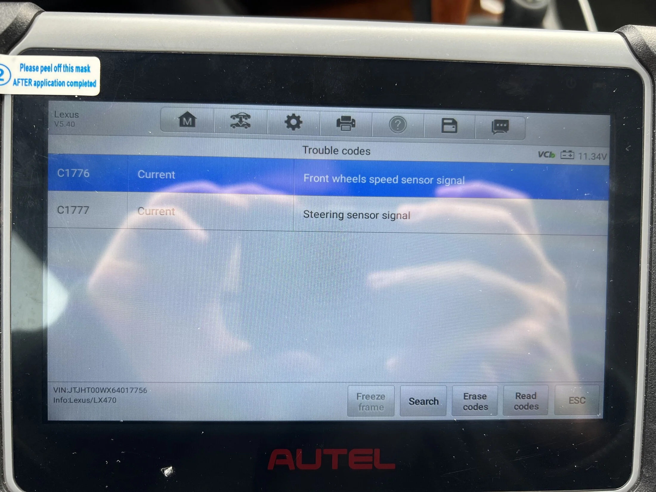

Hi everyone, I have a lx470 bought a few months ago. It had the CEL, VSC Trac, VSC Off lights on and I ran the OBD. It said the O2 sensor (bank 2 sensor 1) was off so I replaced all 4 O2 sensors. But just a few days after the replacement, I got the CEL back on dash again and same error code. I've tried to erase the error code several times with OBD and sometimes it 1 day later or sometimes a week or so. I found that the CEL lights usually came on when I merge onto the freeway with a higher speed or when I floored it after I erased it. The codes are following:
P0171: System too lean (bank 1)
P0174: System too lean (bank 2)
P2197: Oxygen (air/fuel) sensor signal stuck lean (bank 2 sensor 1)
Also, I did found that my lx470 has a exhaust manifold leak (on the driver side I believe). The leak sound is pretty obvious when the car is cold and windows down but not so obvious when the car is hot and windows up. Is it possible that those O2 sensor error code is because of the manifold exhaust leak since it's bank 2 sensor 1, the O2 sensor before the cat? Due to the leak in manifold, more/less air is pulling into the exhaust thus giving a incorrect O2 sensor reading. Could there be any other possible reasons that throw those error codes?
For the new O2 sensors I used, I bought them from some ebay cheap brand. Should I try Denso instead?
Any advice will be appreciated! Thanks in advance!
