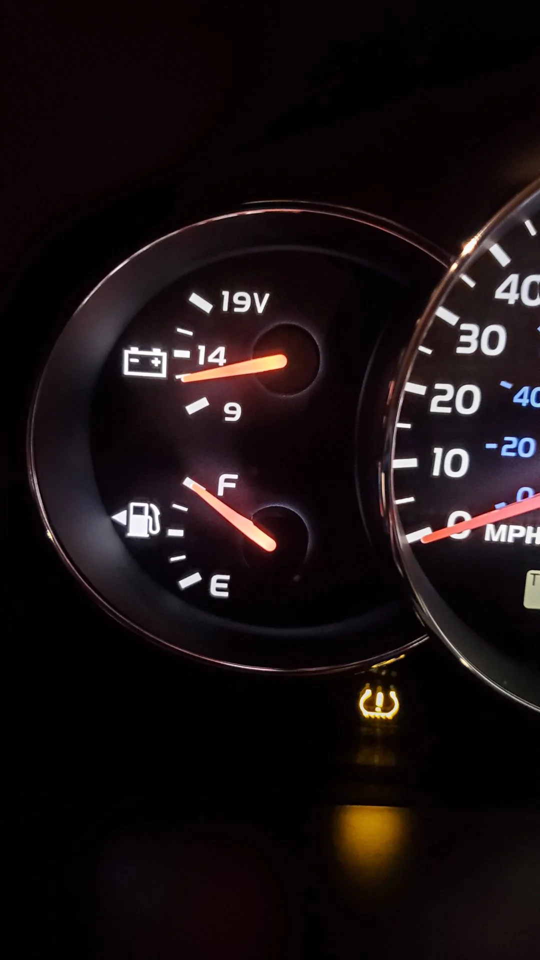

On the way back up to the US currently Nicaragua. I noticed that my voltage guage was reading lower than it should ... maybe 11 or so. No battery voltage light ... group 31 battery 5 years old. Headlights aren't dim or anything and she starts up fine ... I stopped, checked terminals etc. I don't have a voltage meter with me. Voltage indicates the same even under acceleration and a high rev blip on the throttle makes it move up a fraction but barely noticeable. I'm thinking windows are on a battery lead circuit and headlights off the alternator? Hunch is a bad cell in the battery. It's middle of the night here and not really any place to check it out at the moment. Had to hunt for a bit to find cell service. Thoughts ?? Maybe check the magnetic pull on the alternator... if that will tell me anything on these 100 series. Should I do the old school pull the negative battery lead off while she's running and see if she still runs? Shut her down before reconnecting and all? Or will this toast my electronics like in new BMWs? Checked the fuses and all look good to go. Strange the battery light isn't on, but maybe because that measures output from the alternator as d the batter is showing low voltage on the dash because a cell is toast?

if it's a bad cell, wouldn't the alternator still put out the 14+V which would show on the dash? And I think you'd see changes when rpms fluctuate, after starting etc.

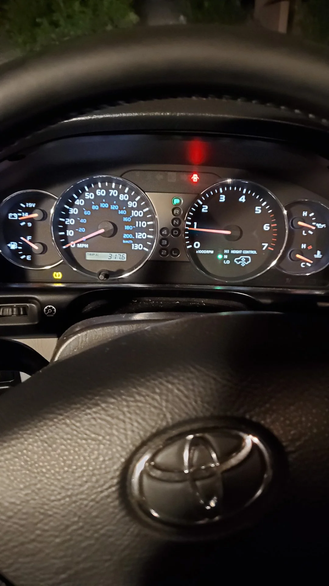

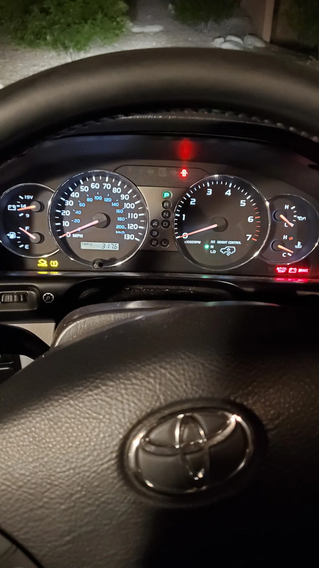

with the key in the "on" position, check to see if you have voltage on either side of the IG-FR fuse. Your picture above of the truck no running but ignition on, looks very similar to what my issue was.
if you don't have voltage on either side of the IG-FR fuse, it could be the relay I noted in the post above. I was able to diagnose it for myself as a result of the issue being intermittent. I went through 2 alternators in the process of determining that the alternator wasn't actually the problem.
My vote is a bad cell in the battery. Alternator is putting out fine most likely but with a bad cell you are not going to see 14 volts on the gauge.
The symptoms point to that instead of the alternator. Otherwise the voltage would quickly drop to 10 or below and it would no longer start or run.

Do you see the battery symbol light on when you turn the key on before starting the engine? (Don't recall for sure that it shows on the 100, but I would think so.)
Yes battery symbol illuminates before starting. It is "trying to charge" it seems intermittently ... I got another bump just right and voltage went up. I can not find any loose wires. Ground is good etc. At a shop now and they actually have a battery tester and telling me they think the battery is bad. However they only have a group 34 battery. Hahaha ... anyone try a GROUP 34 OPTIMA before? Wondering if it will work ...
