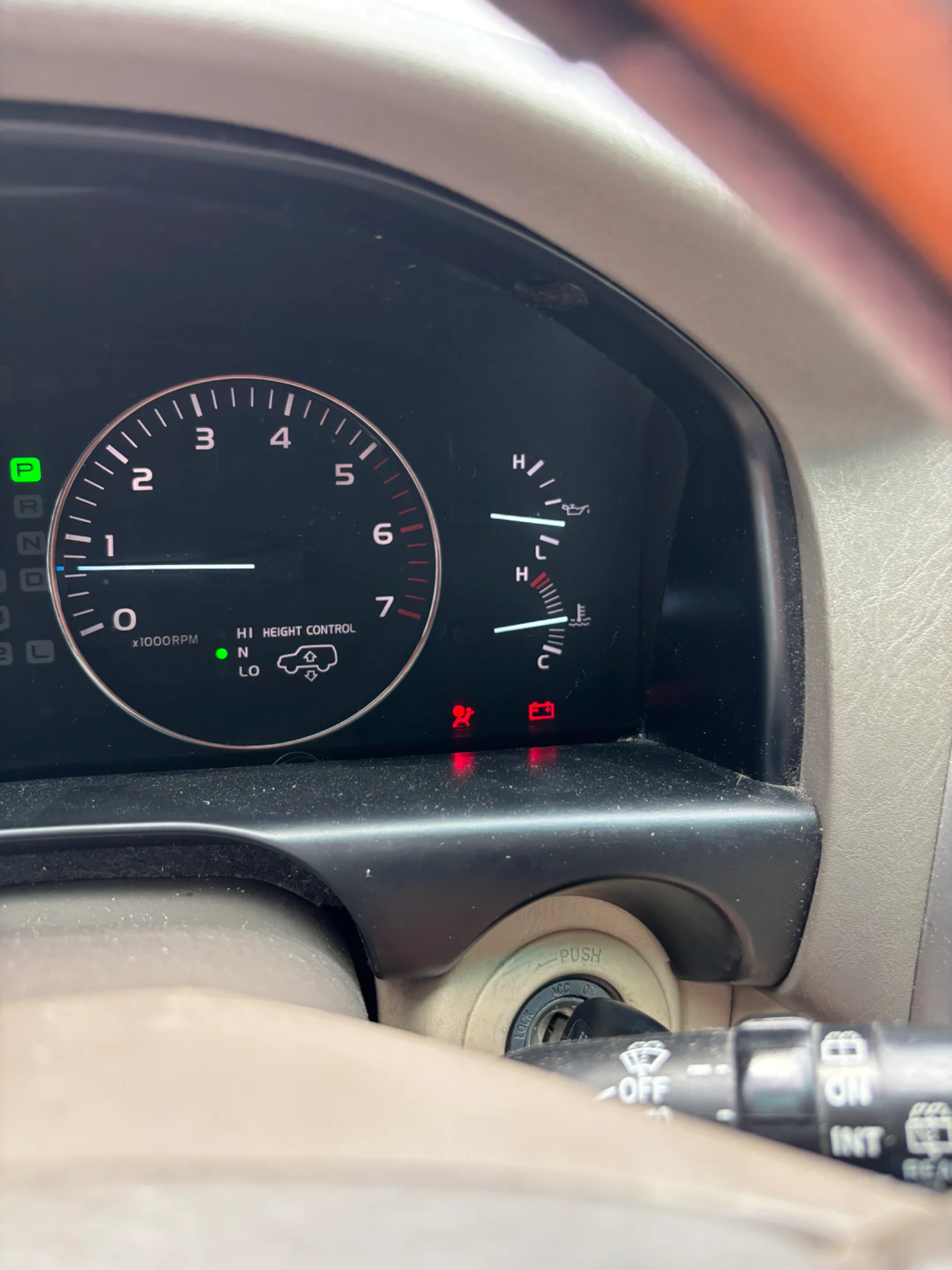

Can I assume my alternator is getting week?
Just noticed today that red battery light is coming on at at idle but goes out with just a touch of the accelerator petal. Also comes on when activating the AHC.
