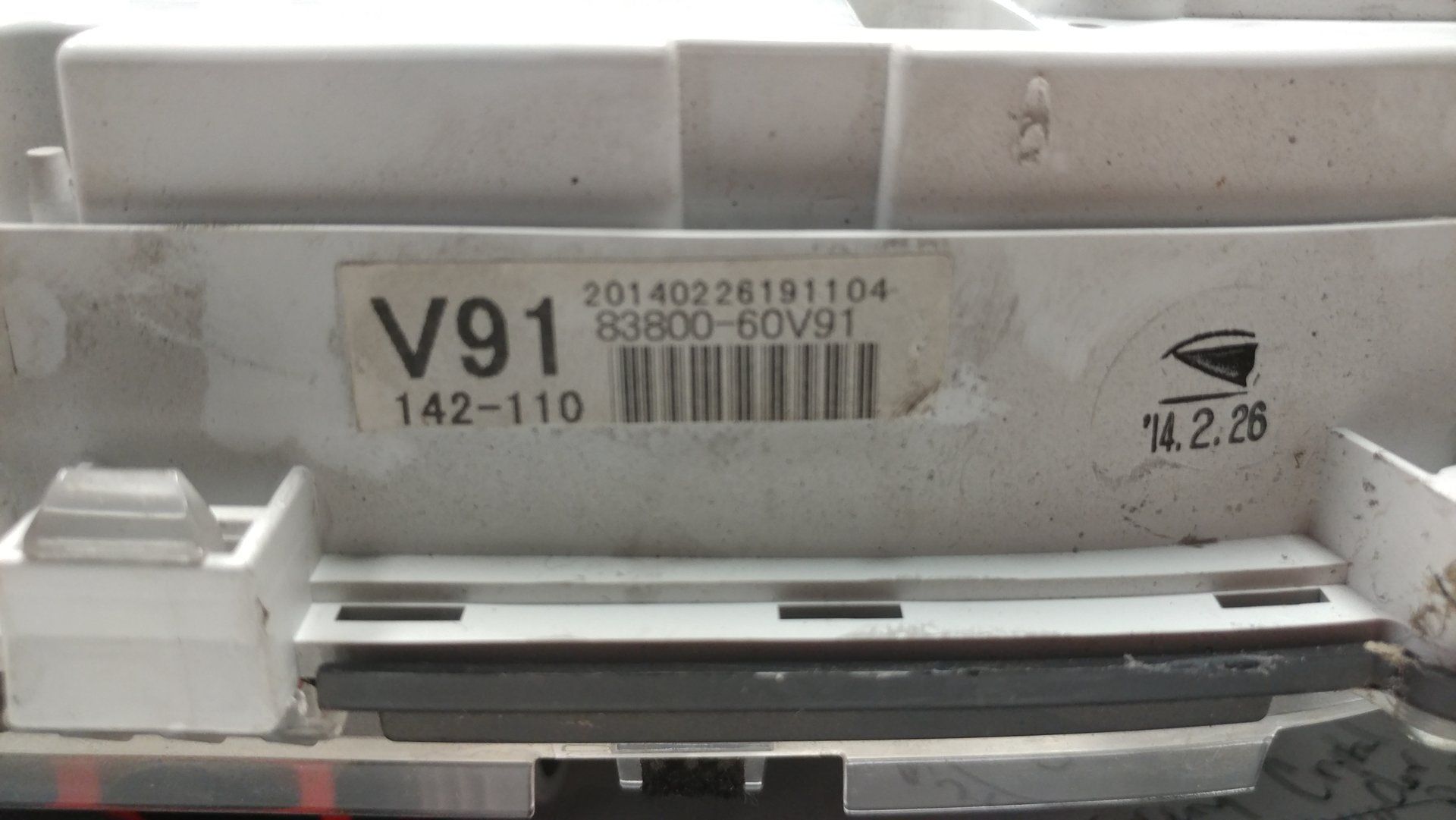

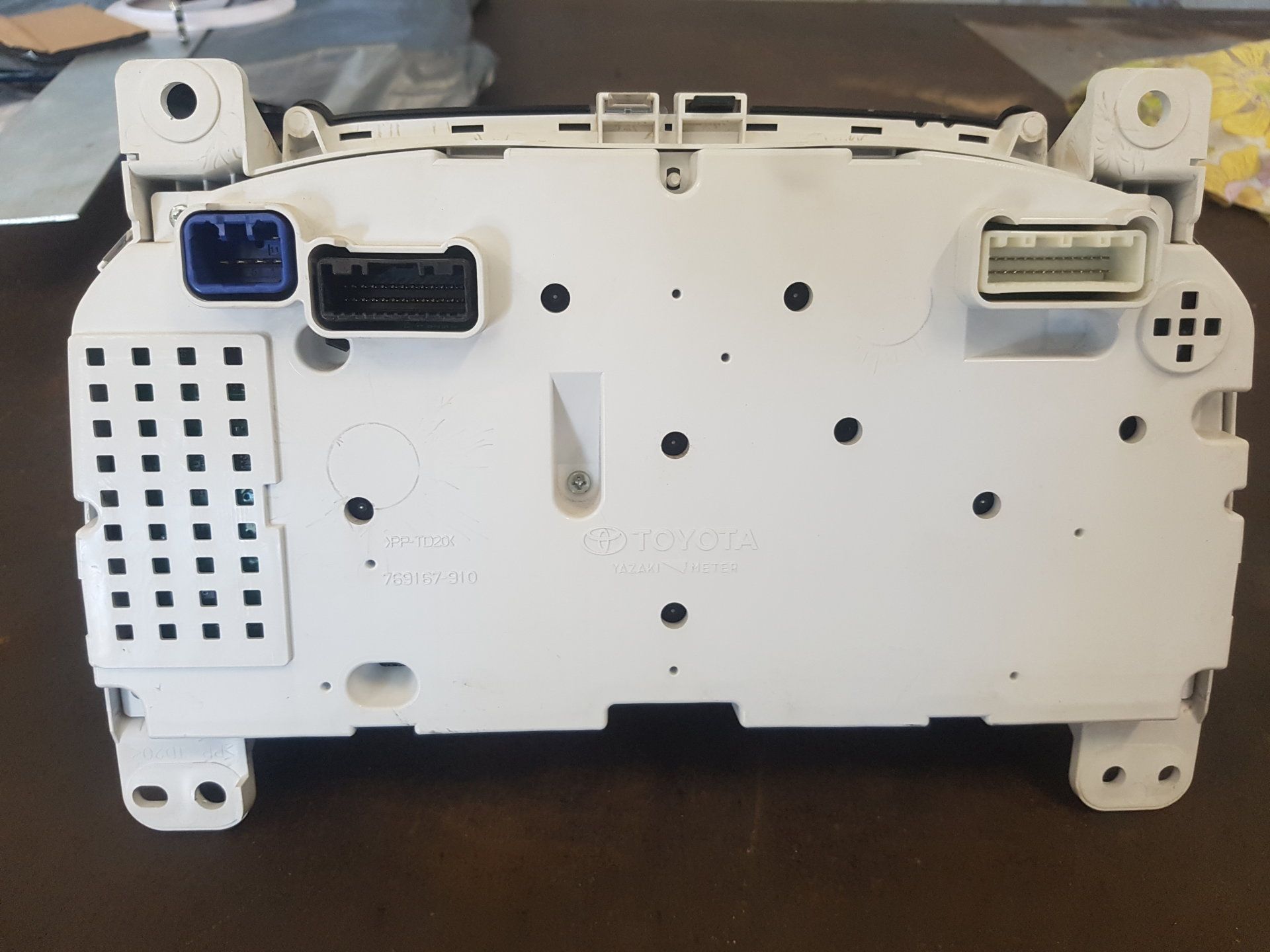

Hello,
Just purchased a 2019 VDJ79 GCC spec. The truck did not have a tachometer.
I looked up the part number for the Tacho equipped dash and it looks like 83800-6BT20 is the correct part number for that.
The gauges that came out of my 79 has a part number of 83800-6BT00.
Wanted to verify the part number for tach equipped VDJ7X and check where to buy it. Checked dealers and online. Strange that they all tell me it's discontinued yet it's a brand new truck? How do you make something and discontinue it at the same time?!! very strange.
Any pointers would be appreciated. I need tacho more than speed.
This is what I have
This is what I need
This is what I pulled out
And the plug for reference

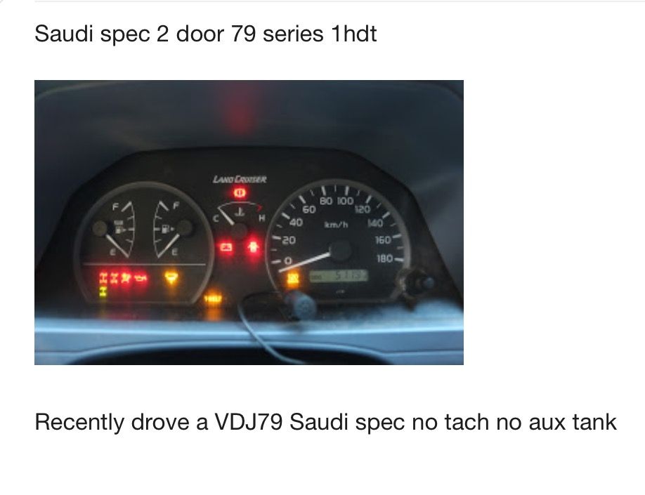

@LandCruiserPhil ...... Is this the actual photo of the instrument cluster on the Cruiser that you drove and if so
was one of the fuel gauges simply inactive?
was one of the fuel gauges simply inactive?View attachment 1951767
Great eye and yes you are correct. The factory rear tank was replaced with a 180lit and the clip on the plug was broke and once I figured it out I zip tied the plug.

I could source a complete dash out of Australia but would need to compare pin-outs. The GCC spec 79s came with 3 plugs in the back of the cluster.
