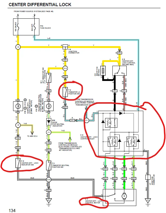

Tests:
With the key on, engine off, and windows open. Shift the T-case to Low. You should hear a brief whirring sound. This would be the CDL actuator motor engaging.
Try it a few times. Shifting the t-case to High should also trigger the CD actuator.
If you hear the whirring sound when shifting the t-case to low (CDL motor). Do the diff/abs dash lights come on? (key on engine off)
What was the outcome of the VC test? With the T-case in high. With open diff's, one tire raised. Transmission in neutral, the tire/driveshaft should turn.
You would feel a mild resistance when rotating the wheel. You should be able to do 360 degree turns.
If the wheel will not turn, the VC is frozen.
Other to eliminate:
At the front of your T-case (on top) is the CDL on mechanical switch. Triggers dash lights, Abs light etc. This switch has a two wire connector. If you pull the connector and jump the two wires together. The ABS light and diff light should aluminate with the key on. Run a continuity check on the CDL switch (no continuity with the t-case in high. Yes-continuity with the T-case in low?
Drivers side kick panel, behind the ABS computer. Is the transmission control relay (labeled), also known as the 4x4 relay, or diff control relay). There are three separate relays inside. It is possible one of the relay's inside has gone bad.
94 EWD from the RESOURCES tab
