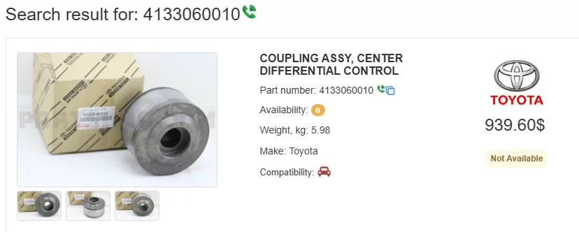

I am looking for a viscous coupler for my 94LC. I am the only owner. The truck kicks out on slow turns, even screeches. I understand that is due to a defective viscous coupler. I'd like a new one, but if a used one were said to be good, I might take that. My mechanic wont install it unless it is new. He says he cant get a hold of one but i'm not sure i believe him. Thanks all for your help.
Impex might have it. New parts search — IMPEX JAPAN - https://en.impex-jp.com/parts/new/search.html?partNo=4133060010+
PartSouq doesn't
