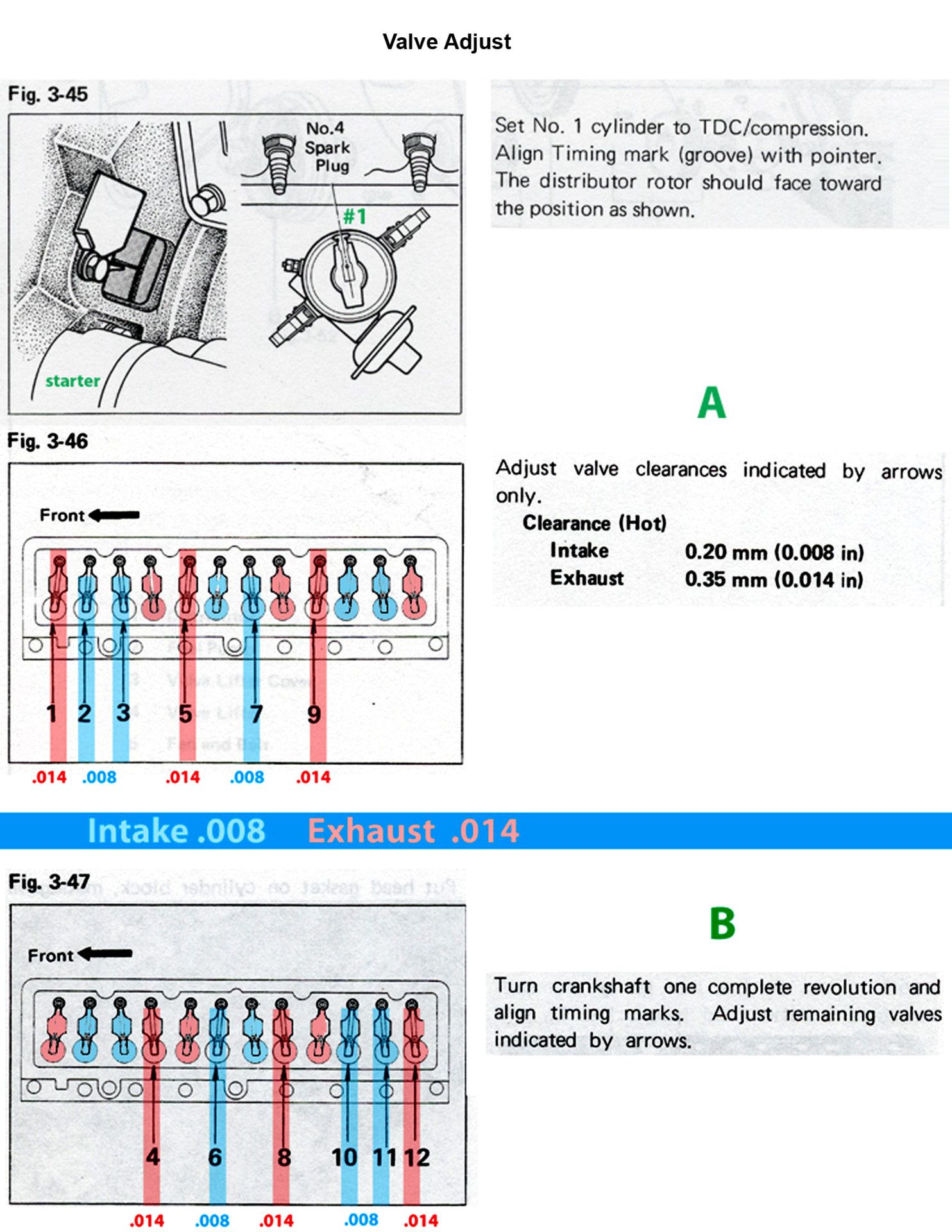

This is the guide I found most useful.

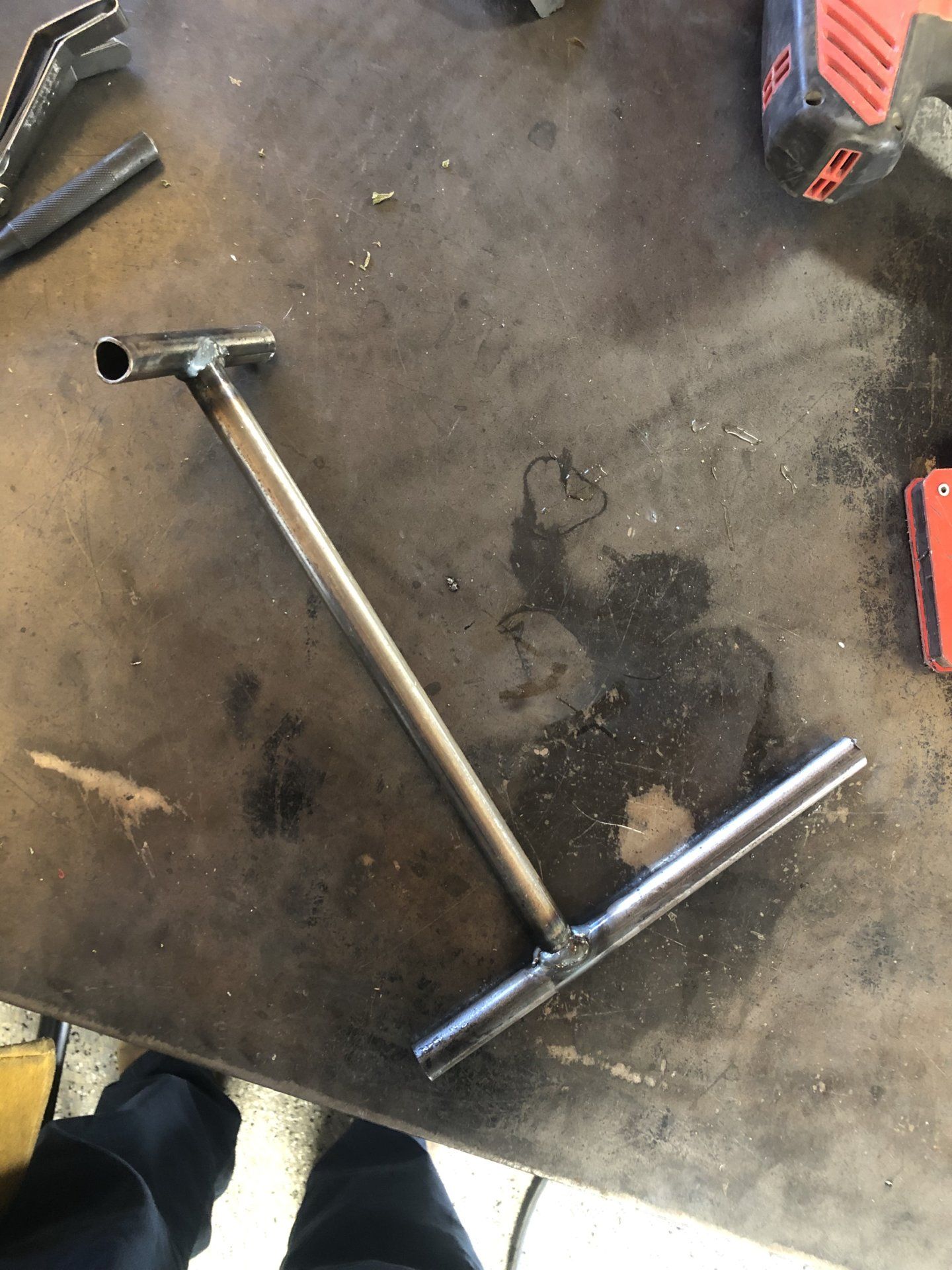

for me this would be the hardest part. rotating the motor. isnt there a hand crank like old rovers have that would make this easier ?
otherwise 4th gear and push it in the driveway with a keen eye on the bellhouing window?

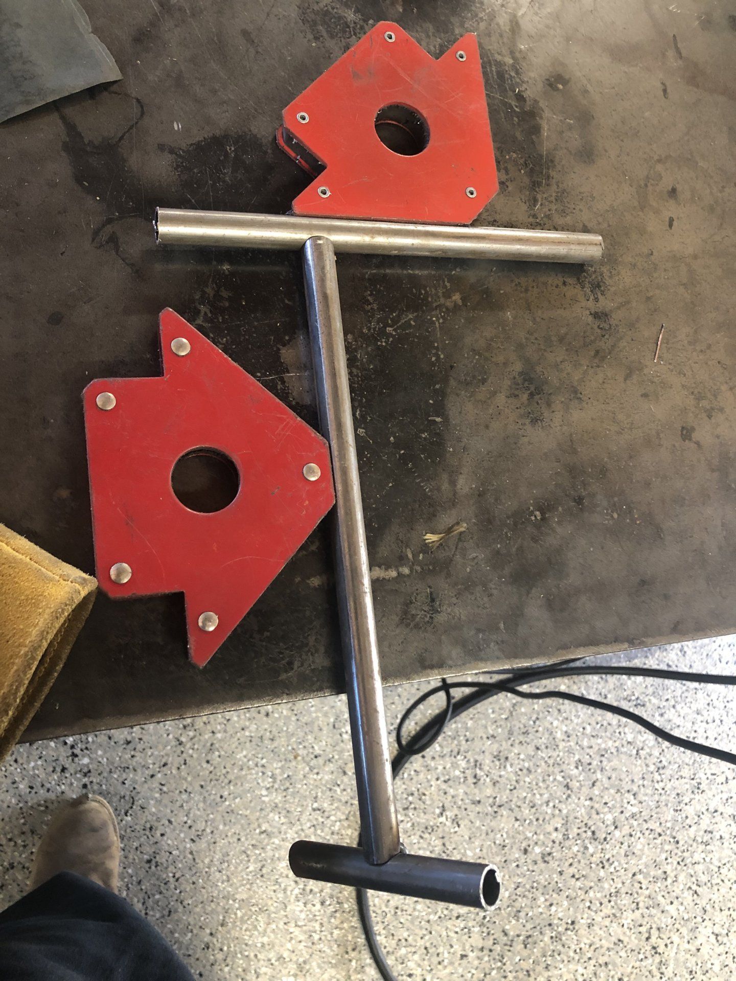

I fabricated this and worked well. I’m able to slide it under the radiator and engage the crank. I have a winch so I had to make it 11”
Thanks, Perfect Printable Instructions!
