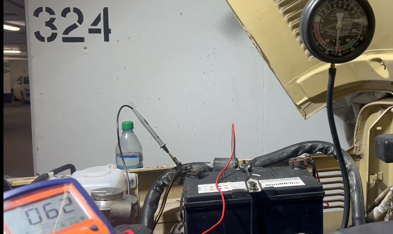

I noticed recently that I had alot of engine vibration, maybe low speed, and the exhaust fumes were excessive. There's no smoke. Thought it was time to re-adjust the carburetor using lean median method.
Set-up
- Digital tachometer connected to the coil
- Vacuum gauge on the inlet.
This is what it was like before I started. Engine was already warmed. Water bottle is my vibration meter. Getting 14-15 in Hg vacuum and speed is roughly 600-650.
Closed the idle mixture screw, and then turned out 2 turns. (at 1 1/2 engine cuts out). Then slowly increased my idle mixture screw to max RPM and reduced the speed back down to roughly 680 RPM. Did that a few times; this was my final...
Tried to set the speed at an average of 690 RPM and was getting about 19 in Hg; but still had engine vibration. (I wanted to upload the videos but could not figure how to do that? Does Mud not allow videos?).

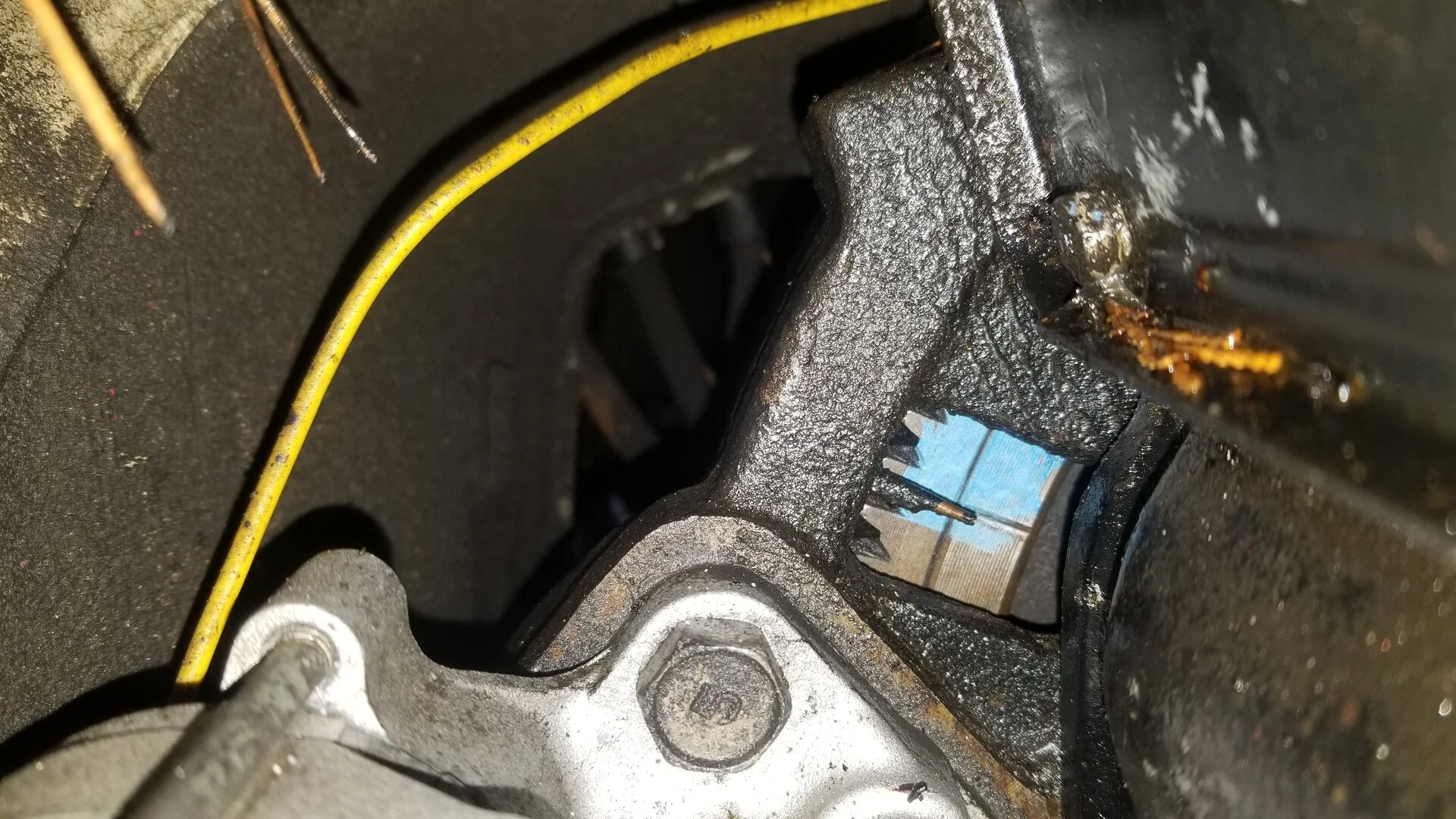

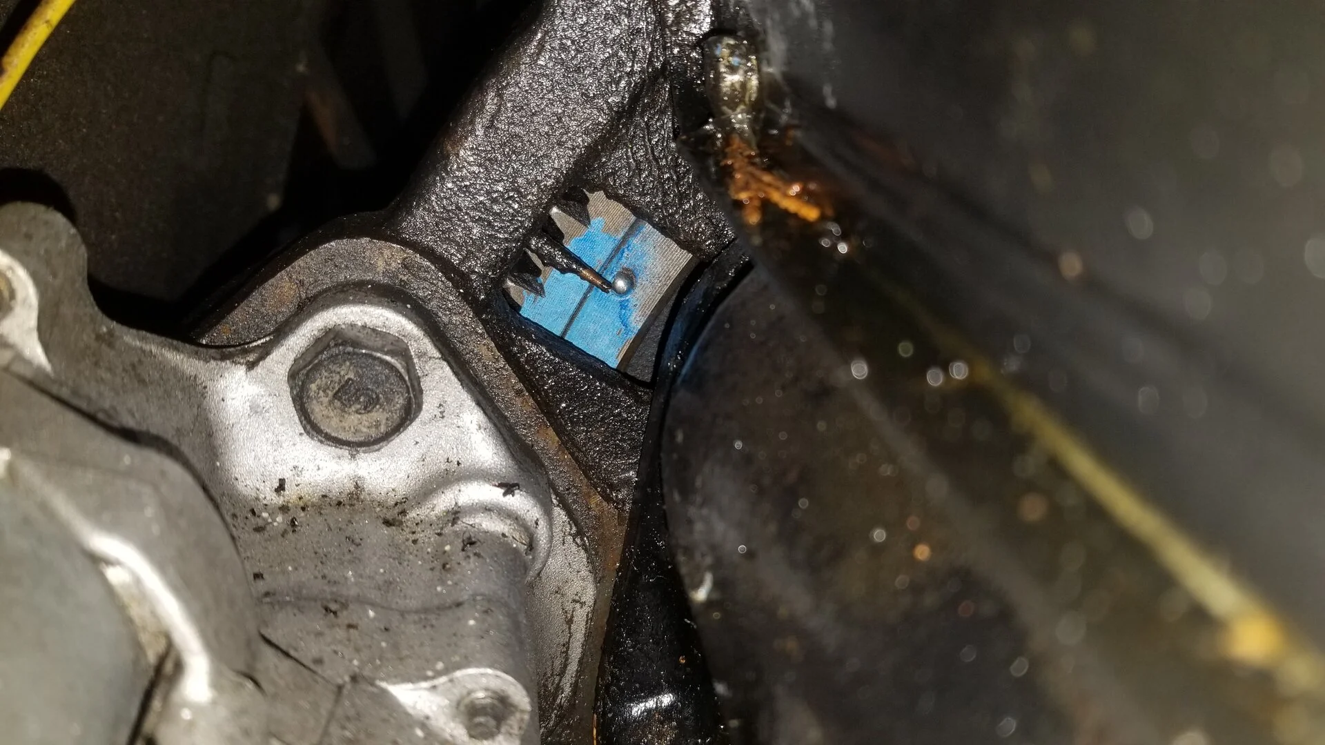

No. there are 3 or 4 things to look at to make sure you are at TDC #1 and I don't feel like taking off my valve cover today. here's a pic of the BB and the line you're looking for. Mine's blue because it's my favorite color.
since you're new at this, you'll also want to look at the rotor and rocker arms and piston tops through the sparkplug holes.
probably a lot more pictures and detailed steps in the FAQs.

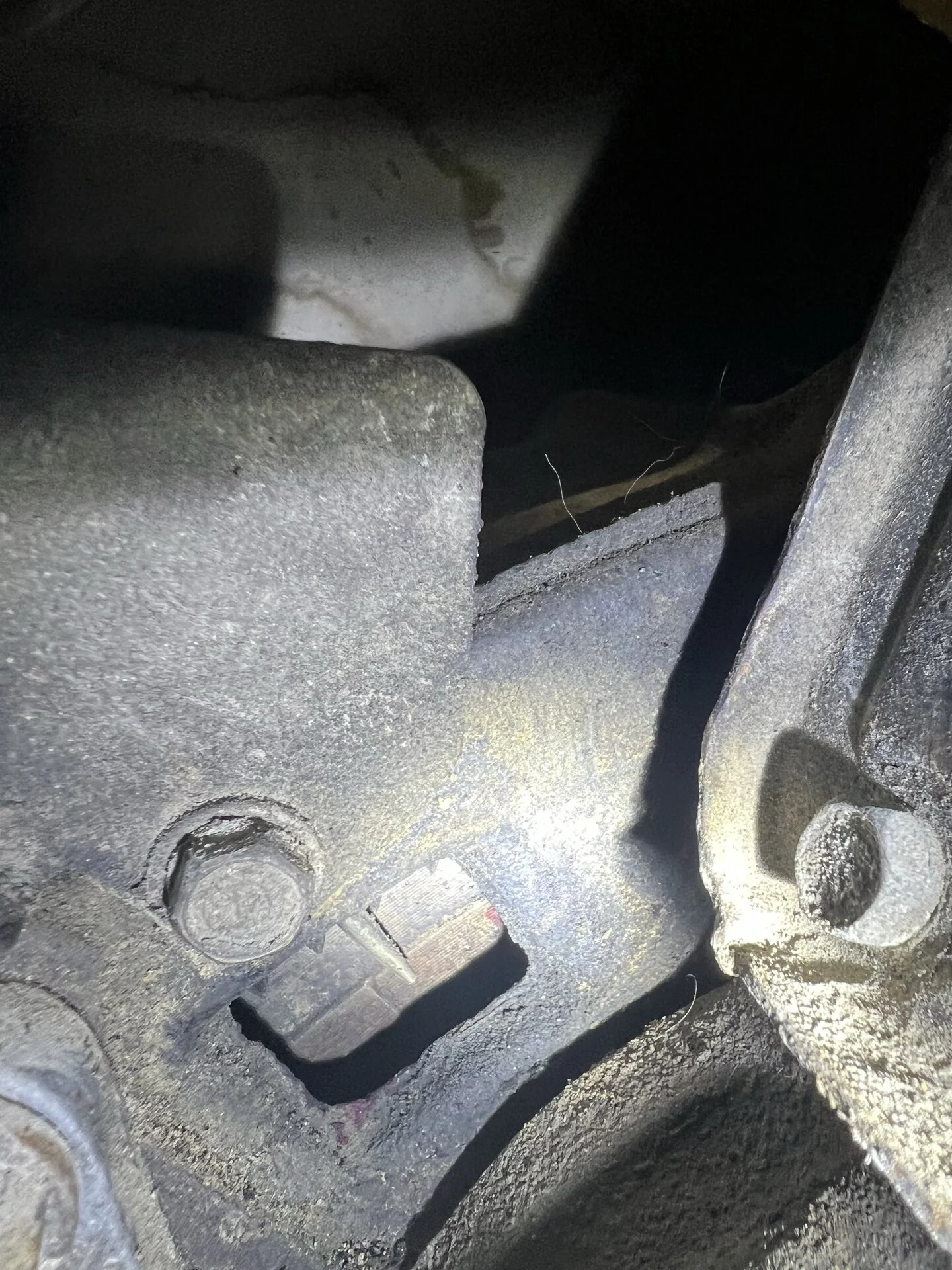

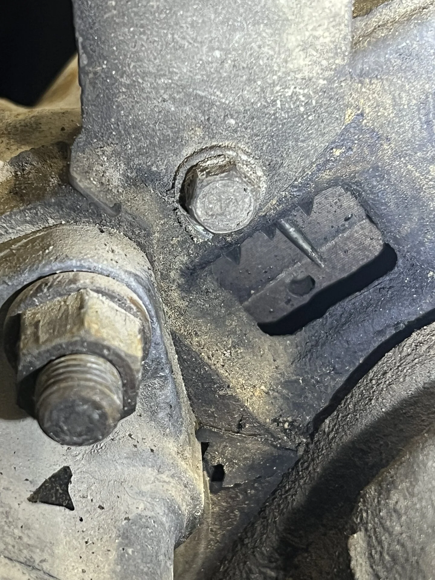

So tried the raise the rear end & manually rotating the tires, while in 4th gear technique. That was a waste of time. So then thought I would try what I saw an old mechanic once do.....turn the engine using the radiator fan. Disconnected the battery & coil; and very slowly managed to turn the engine using the radiator fan hub. It was a piece of cake; much easier than I thought and gave me a great view of the window.
so found the BB but did not find the line. Now I understand that the BB is TDC for piston #1 & 6; and I'm supposed to turn it 180 for TBC of the other pistons. But how do I know I have turned the engine 180 degrees?
I did also see these "painted" marks...not sure if they are 180 markers?
I'm going to take the valve cover off this weekend to start identifying inlet / exhaust valves. I will also try to look through the plug holes.
NO. You turn the crankshaft 360 degrees. Until the BB and mark come back into the window.
The camshaft (and dizzy rotor) will turn 180 degrees because gears
So I found the line; its not very visible, but was half a turn further from the BB. (roughly 7 degrees)

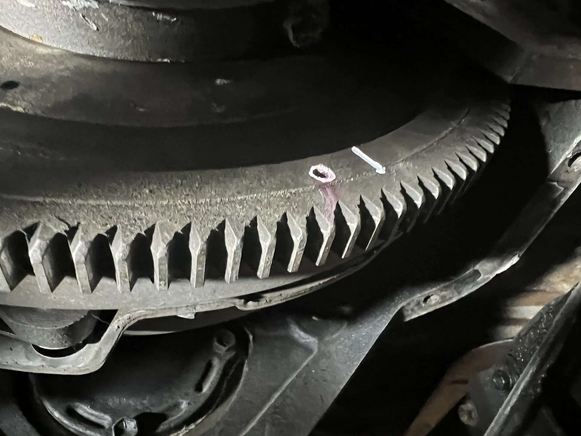

That was a piece of cake. Painted...with white out (highly visible)
PO had used an assortment of bolts; now replaced. Notice there was remains of grey silicon gasket material ... but i dont think this is required.
Also over came my fear of opening the distributor (long story) and was able to confirm TDC for #6. Turned the engine until I was back on the line and the coil was pointing towards firing #1.
Even with the engine cold, there were some valves that were loose while others were tight.
