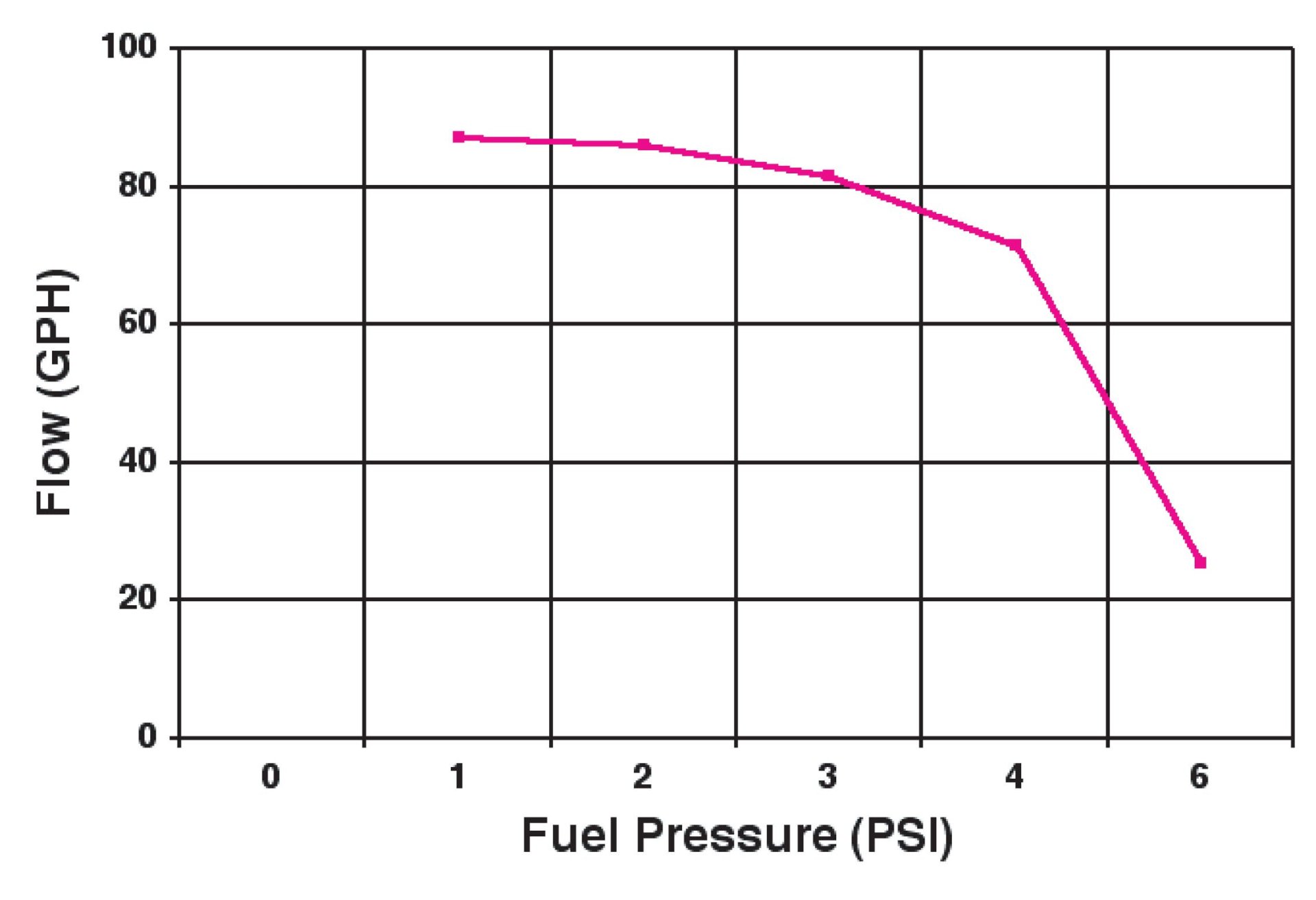

Unfortunalty it seems that the Airtex E84070N has been replaced by the Carter P4070 (claimed as same pump). Seems that Trico, owner of Carter purchased and merged Airtex into Carter in 2019; moved manufacturing from Illinois to Mexico.
http://store.summitracing.com/partde...5&autoview=sku
Part Number: CRT-P4070
Free Flow Rate: 72 gph
Maximum Pressure (psi): 4-6 psi
Part Number: CRT-P4594
Maximum Pressure (psi): 6-8 psi

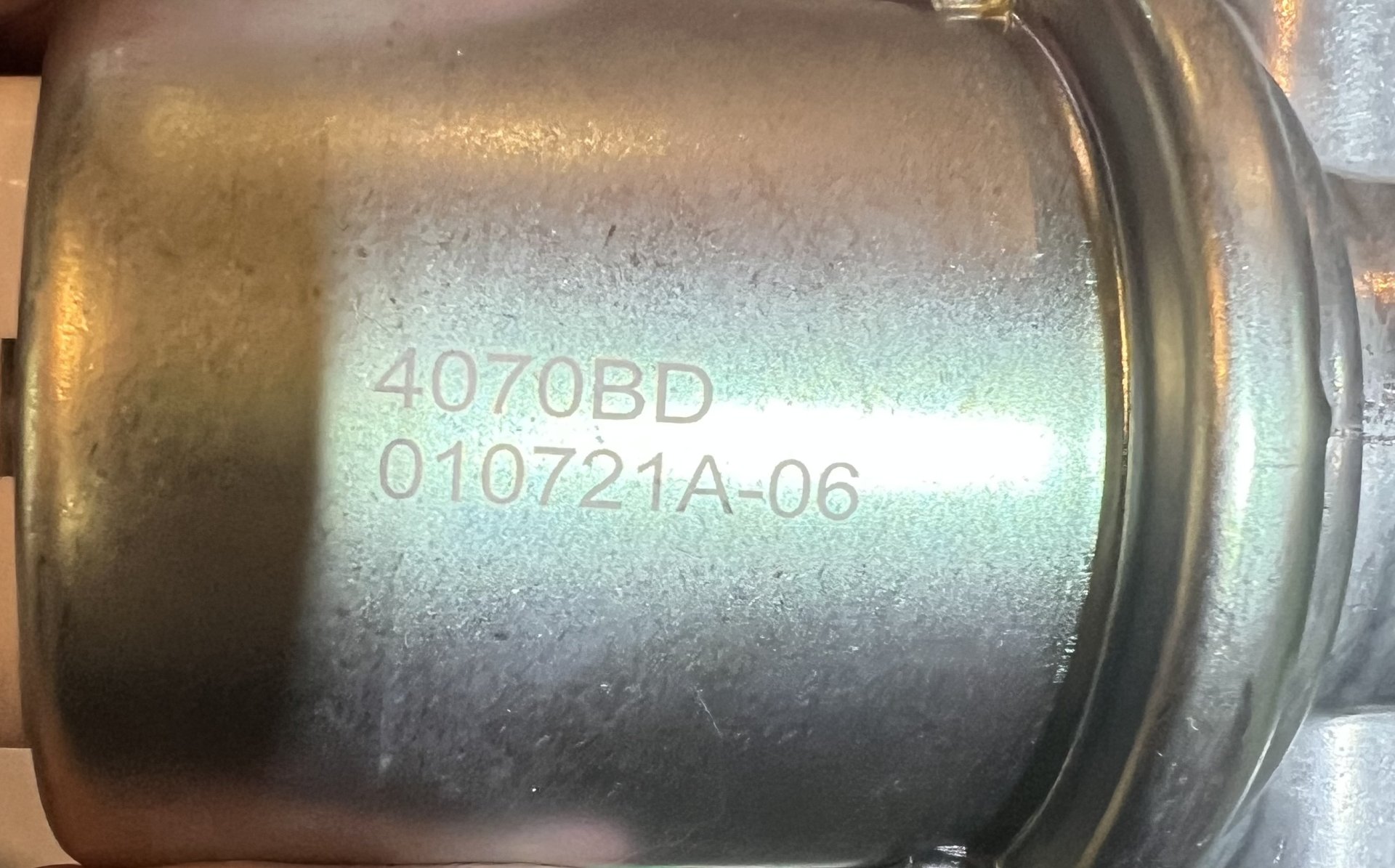

Mine arrived the other day, and is also marked made in China. The pump itself is marked 4070BD 010721A-06. A google search brings this up as a carter pump. Maybe the boxes are all that is still Airtex? Also, the Carter seems to be rated at 50 gph, not the 72 gph of the Airtex.
Interesting.
My packaging was similar but the color of the unit is kinds a brass goldish color, similar to the older inline fuel filters.
View attachment 3135776View attachment 3135778View attachment 3135783
My "SP1130" can in a similar box. Same shape and size, with same label except the box was all white (no printing on sides or Airtex on top. Label stated E84070N, made in chine etc., but was also where the name Airtex was placed and the label was overlaid on another label. Pump was stamped with the Spretra Premium brand model and designations and was a phosphorus gold color, caps over terminal lugs were little plugs (no cap like yours) and hose nipples had no thread protection. Your box looks a 100% more legit, your bags are also labeled and you have a pump body with a closer model number. As Airtex is now owned by Carter, I'm not surprised about the cross linking.
I may skip the drama and potential failures of Airtex/Carter/Lookalikes and go with a Holley Red Standard 12-801-1 (good for 97gph free flow; 71 @ 4 psi; draws only 2 amps) but may remove frame or add new, but does cost quite a bit more at $160
