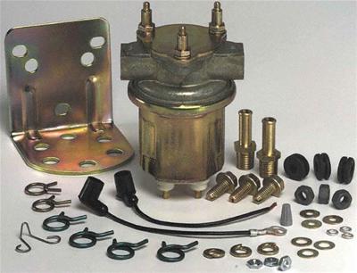

I was looking at the Carter pumps. Carter seems to have a bad quality reputation. That Carter pumps 50gph and the Airtex E84070N 72gph. More seems like it would reduce pumping time.
Thanks...any idea if that Airtex E84070N fits in the standard (behind trim of rear passenger wheel well) location?

There is a picture of that pump above (Upgraded pump info for LRA? - https://forum.ih8mud.com/threads/upgraded-pump-info-for-lra.1291862/post-14579478) of the pump in the behind the passenger wheel location. That's a little further back than where I mounted my Facet, but in the same general location. The Airtex and Carter look to be similar size and design (vane pump).

The one that came with my LRA was a Purolator Posi-Flo pump. It pumps 4-7 psi, 32 gph. 1/8NPT ports. 5/15 hose barb adapter/filter.
The Airtex should cut pumping time in half at 72 gph.
Looks like you can get Airtex pumps up to 100 gph, but the 72 gph is probably plenty.
