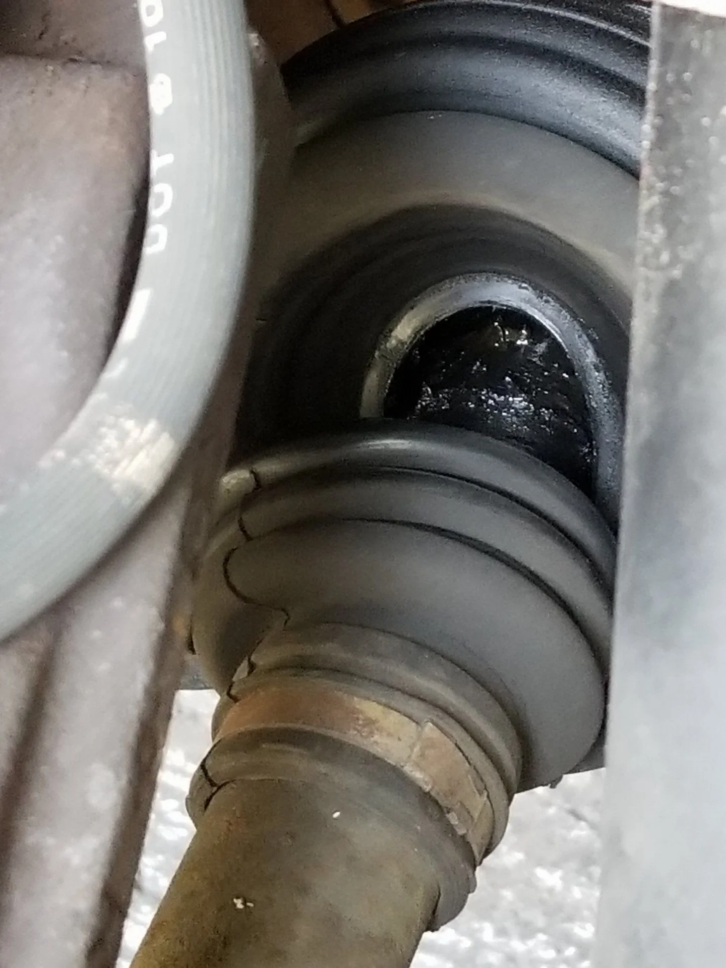

I was doing the front brakes today and found that the right cv axle inner boot is completely teared. The outer boot has a small hole.
For tje price of two boot kits i can buy a reman axle.
Opinions?

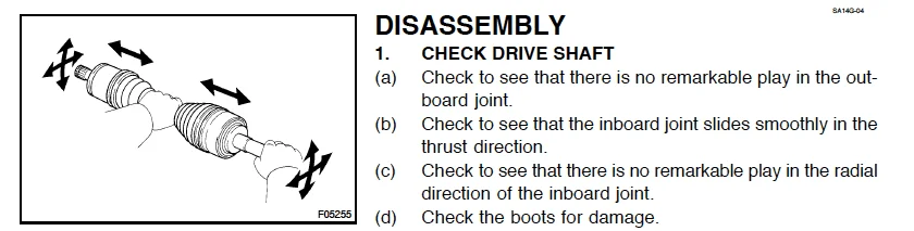

This is what the FSM suggests to check for "remarkable" play;
If you need to reboot- its a good time to assess the condition of the CV for "play".
As I am currently I'm in the process of replacing my CV's (183k) I thought I would post my results. While they weren't "clicking" while turning but I was getting some clunking noise under certain conditions, and the teeth on flanges and axle ends are worn enough to create a substantial free play which contributes to the F-N-R clunk. Also there is some minor acceleration/on-throttle vibes that points to being CV related. So while not completely shot, they are on their way out.
Inspecting the tulips on the bench the inboard tulip are ok(no rotational looseness and smooth in-out movement), the outboard tulip has some "lateral" in-out play, its minimal but enough to make a small popping noise, and under a load suspect that noise is more pronounced. I will check against my new CV when it arrives, but any play indicates wear, and limited life span.
