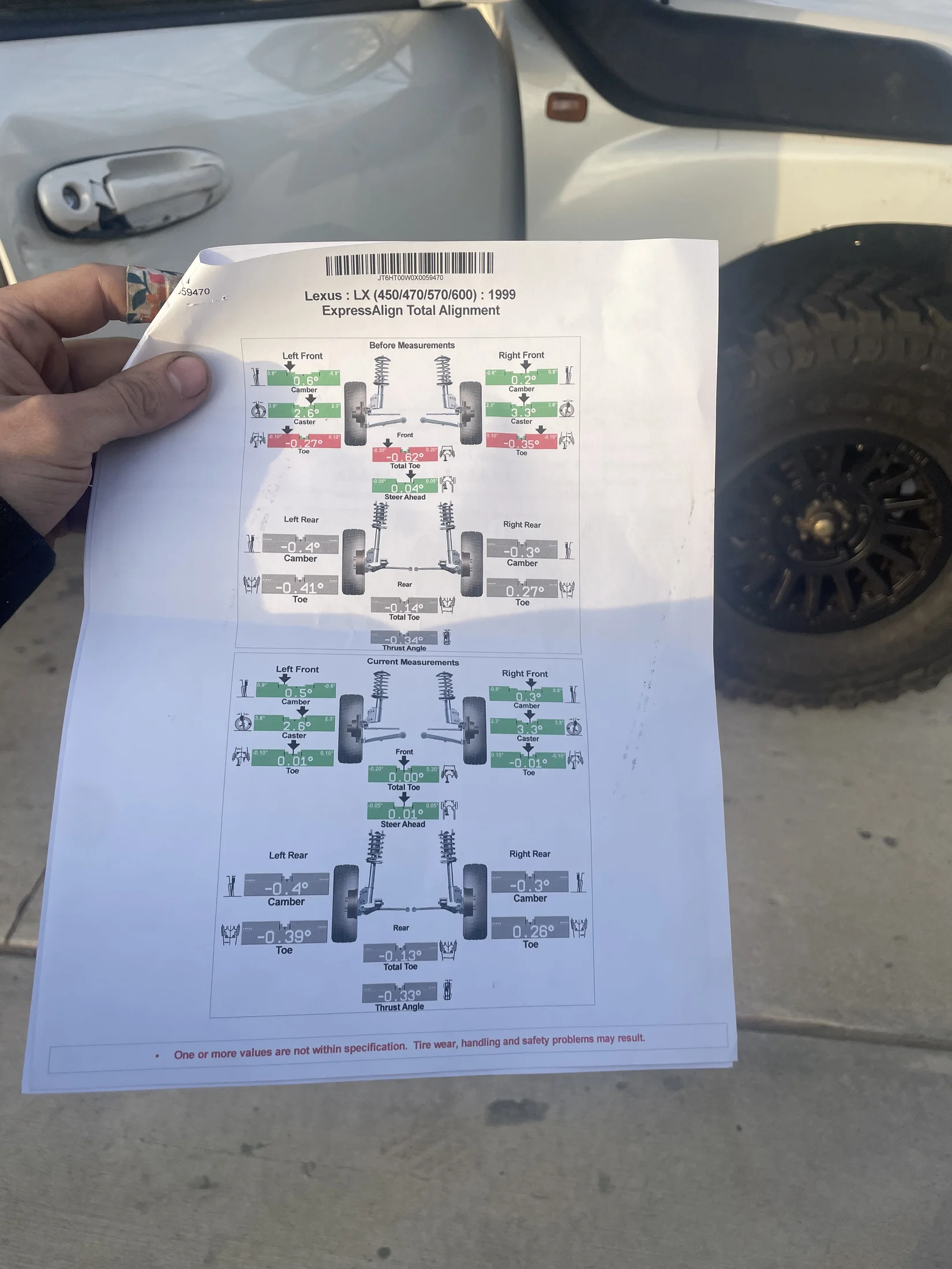

Above: Alignment on 1999 Lexus LX470 with Total Chaos UCAs and 1.5" lift

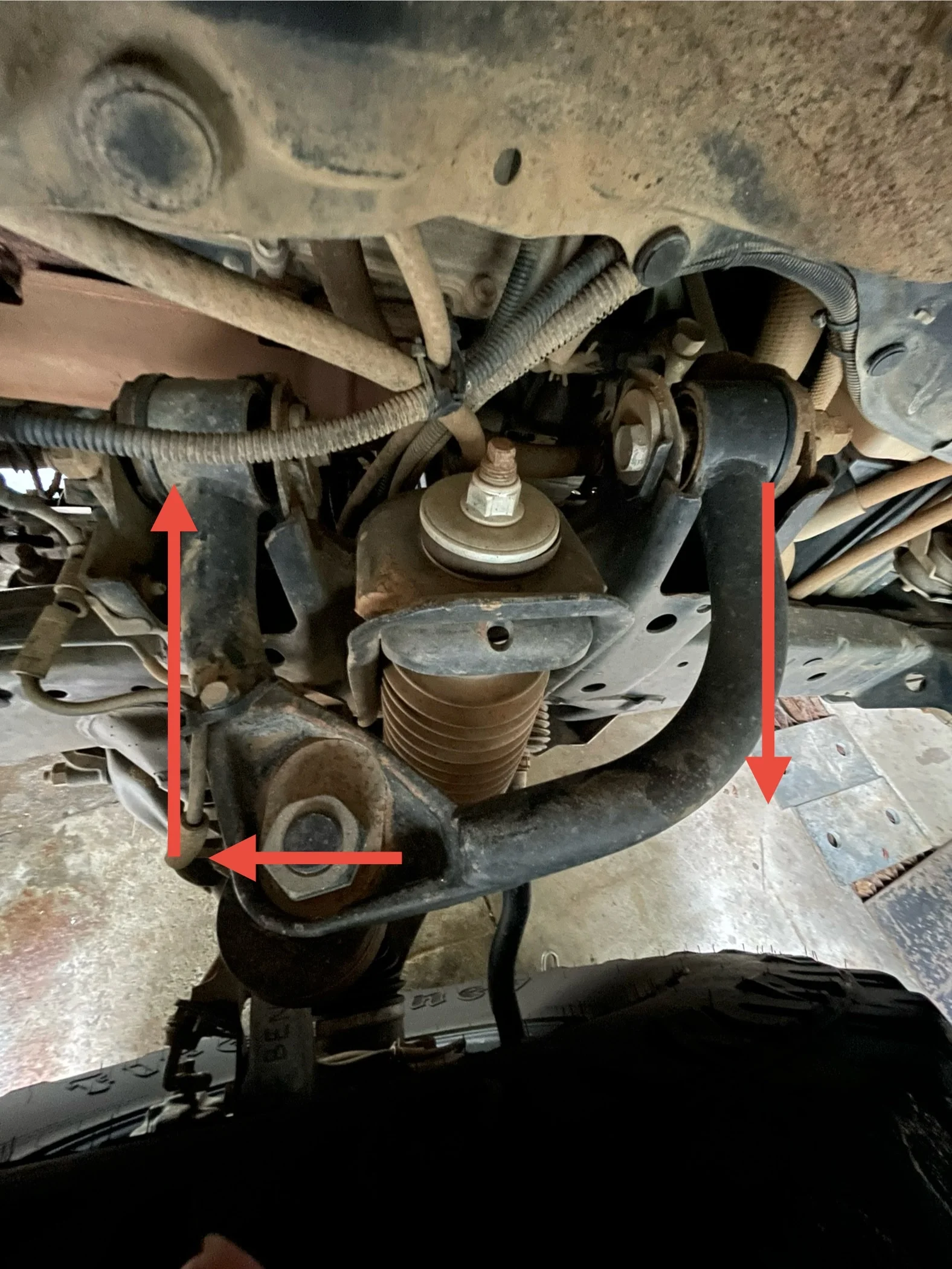

Above: SPC UCA (RH side) with forward cam pushed outboard and rear cam pulled inboard
  1. Push the forward cam outboard by rotating the assembly clockwise (viewed from rear).
  2. Pull the rear cam inboard by rotating the assembly counter-clockwise (viewed from rear).
  3. Double-check your ride height (as this affects alignment) and take the vehicle to get an alignment. Ask the tech to set Toe only.
Above: rear cam rotated counter-clockwise to achieve maximum caster. Couple this with SPC aftermarket UCAs for even better readings.

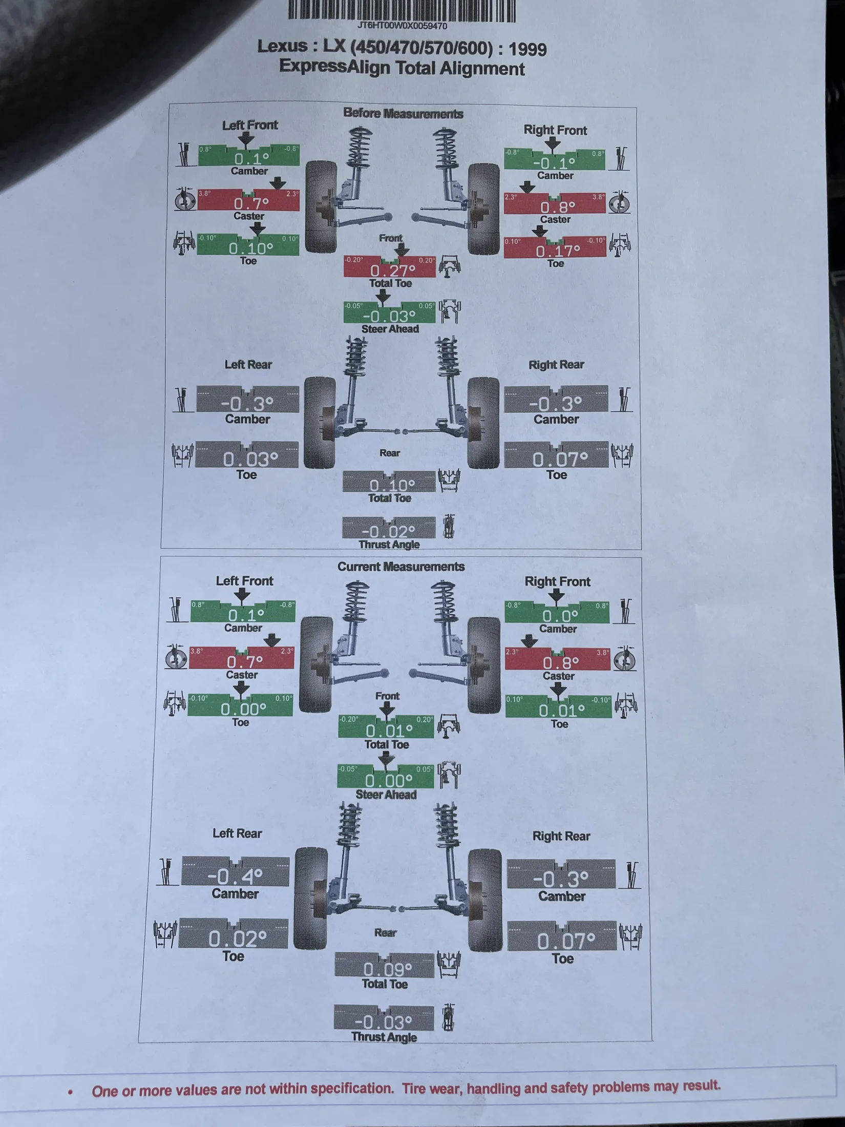

Above: alignment numbers 1999 Lexus LX470 on 1.5" lift with SPC UCAs

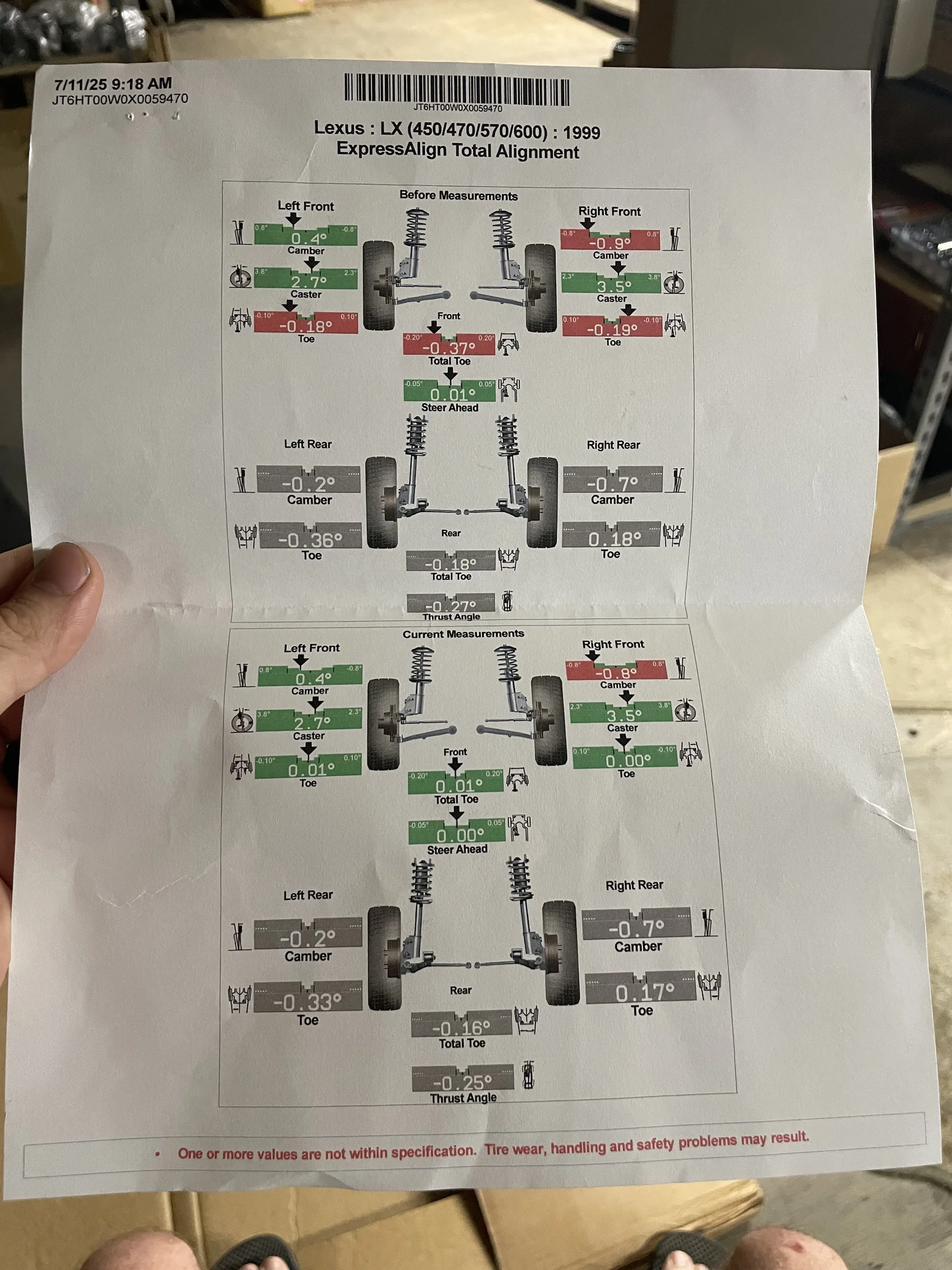

I've bent three or four spindles now over the years. I recently bent my RH spindle (see alignment specs below before vs after) which finally convinced me to work on a method of bracing/gusseting them.
For now I'm still in R&D phase but once I have a working prototype I'll test it out and bring it into production if it works.
The trick will be strength without compromising access to the UBJ nut.
Above: March 7, 2025 (before)
Above: July 11, 2025 (after)
