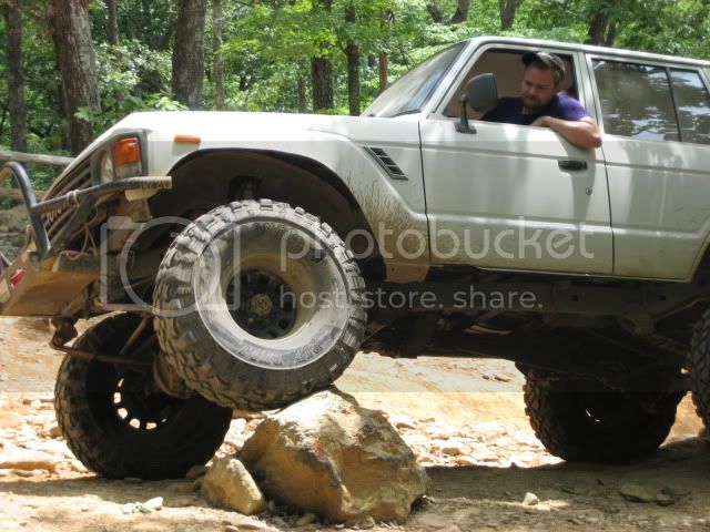

I tinted the two tintable raptor liner kits with ~1qt of 033 Dupont ChromaColor urethane paint.
Pros include:
- impossible to get pin striping from rubbing up on trees / brush while wheeling
- doesn't seem to fade at all
- good abrasion resistance
- bends with the steel instead of cracking
- very high heat resistance
Cons include:
- difficult to keep clean
Took her out wheeling a couple of months ago and rubbed the body on some boulders and the sides of ditches. My cut rocker got bent up a little bit, but the liner curled up with the steel instead of cracking and coming off.
When I rubbed her on the ditch, the panel bent in a little, and the outside corner had a little liner rub off, but overall, it did pretty well. I had a lot of pressure on the quarter panel and only a very small amount of liner rubbed off.
I tagged a boulder in the driver's rear quarter and while it put a nice wave in the panel, the boulder only scuffed the liner.
Finally, I have my exhaust hard mounted to my frame and the cat is only 1" or so below the body of the RaptorLined body, with no heat shields at all. The floor inside the truck heats up like crazy, but the raptor liner looks no worse for the wear.

Curious, why are you using a bed liner on the outside? Yes, the UPol is really good stuff, I loved how it sprayed, but I don't see it holding up to serious abuse on the outside and if you do tag trees and rocks it will be a PIA to repair vs. if paint, you just do your body work and shoot some more paint. IMO if you want something cheap, just shoot some single stage. Now if you like the way the UPol looks, that is different story, but given the cons, I still don't think it is very practical as an all over coating. I would imagine getting that stuff back off if you change your mind would be a b#%^tch.
I disagree 100% with you, for a wheeling truck. I know that regular paint would not hold up to being tagged by boulders, trees, dirt, or gravel kicked up by the truck in front of you. If you want to know what it'd be like to repair, I can buy another kit and repair these scratches. I guarantee that after wiping off with xylene, all I'd have to do is mask off what I want painted and spray. No sanding, just good to go.
Now, for a street truck or restoration, never use bedliner, always paint. When I painted mine, I knew I wanted something that would stand up to my abuse. From my original paint job, I knew that regular paint doesn't. Raptor Liner does.
I disagree 100% with you, for a wheeling truck. I know that paint would hold up to being tagged by boulders, trees, dirt, or gravel kicked up by the truck in front of you. If you want to know what it'd be like to repair, I can buy another kit and repair these scratches. I guarantee that after wiping off with xylene, all I'd have to do is mask off what I want painted and spray. No sanding, just good to go.
Good to know that the Raptor is that strong. As for the cleaning? Mine is pretty shiny and sort of slick, even tho very bumpy. Can you pressure wash it hard and get the dirt off? Do you know if it will hold up to 3500 psi? Also, when you mask for repair, do you sand it so it feathers, or just hose it on? Thx
To be honest, I haven't washed my truck one time since I sprayed the raptor liner. I call a stiff rain my 'car wash'. I say that it's a bitch to keep clean because the rain doesn't wash off all of the dirt:lol:
In addition, I have not attempted to repair any of the scratches in my paint. However, what I would do is wipe with xylene, then spray on, feathering into the existing panels. Due to the texture, it should blend very easily.
