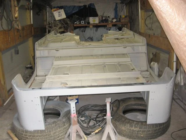

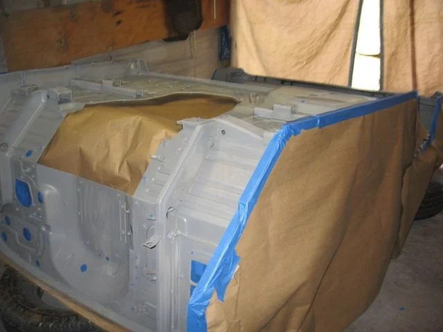

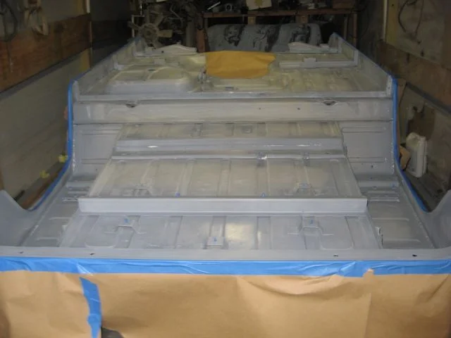

first step was prep.. which everyone always says is key.. i had a coat of primer on it already.. but had some patches that needed priming.. I also seam sealed EVERTHING... so here is before.. after seam sealer and epoxy primer.
taped everything off with generic blue painters tape from home depot.. used that same tape to twist and put in all threaded holes

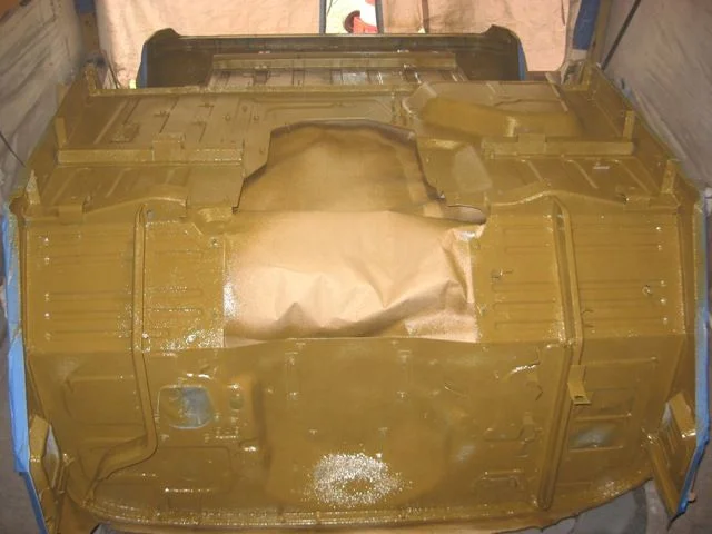

to shoot i used 60 psi.. i have a 16 gallon husky compressor for homedepot and it did just fine. I also too my tiny regulator and water trap and hooked them up to the gun.
so all you have to do is mix.. shake.. and shoot.. it really is that simple...
if you want two thick coats for the underside all the way up to the firewall I would get an extra bottle or two (they are $20 each) 4 liters got me to do one coat then the underside of the tranny hump and then pretty much i went around and hit where I wanted it to be a little thicker and where I had missed the first go around. Overall the position the tub in was good but I still missed a few spots where the gun couldn't get to.. I used a brush to get in some more spots but I still missed some.. (after you are done with each bottle you can usually pour a little that is left into a cup to use with a brush
granted it was only a few days when i did a comparison but my friends rhino liner in his bed of his pickup looks and feels a little tougher than the raptor lining.. but it also costs 8x as much..

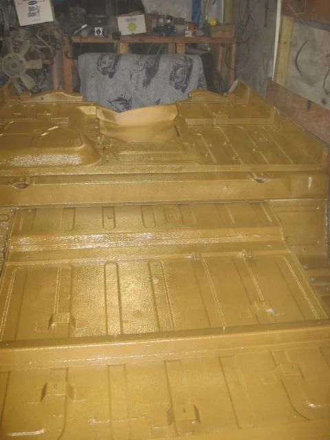

I started to pull my tape up after the second coat had dried for about an hour. Used pliers to pull all the tape out of the threads.
I just taped behind large holes (like grommets or steering wheel hole or heater blower hole) then peeled the tape off afterwards.. no issues.
