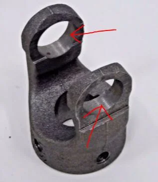

All that is needed is to peen the inside diameter of the yolk where the cap "presses" into. I use a simple and cheap automatic center punch and put approx 8-10 small peens per yolk around the bore. The caps press in nice and tight. Install the u-joint and caps normally, no other special tricks are needed. This just tightens up the bore on the cheap so the caps don't rotate.
I've replaced hundreds of u-joints when I was an auto tech. This is a common practice in automotive repair when the caps are loose - The caps must not rotate!
Do not do this of the bore of the yolk is damaged, out of round, cracked or bad in any other strange way - the yolk / shaft must be replaced at that point.

Peen this area with the automatic center punch 5-10 times around the diameter - problems solved.
Just my 2 cents, but being a UAW Journey man machinist/mechanic for over 30 years putting those prick marks inside the yoke did NOT correct the underlying problem. Under load those 8 to 10 prick marks will not keep that cap from moving, those caps NEED TO BE PRESSED IN so the U joint turns on it's needle bearings, not the caps turning inside the yoke bores. The correct way to fix this problem is to buy the correct sized U joints that press into the yoke. YMMV

So what would be my best option? I ordered the correct replacement u-joint and the original was spinning so I'm guessing the yoke is just worn. Buy new yoke? New driveshaft? Try the preening and lock tight maybe?
@B Todd, I've use Loctite 620 retaning compound with good success on worn bores, but I'll warn you if you have to remove that U joint sometime down the road, you"ll first need to heat it with a torch to break the Loctite bond, otherwise you'll have a he11 of a time trying to remove it. If the yoke bores are worn more then .008 (that's the limit of Loctite 620) you can use Loctite 680, it'll work with worn bores up to .015 of an inch. But if your yoke is worn that bad, it really would be best to buy a new one.
