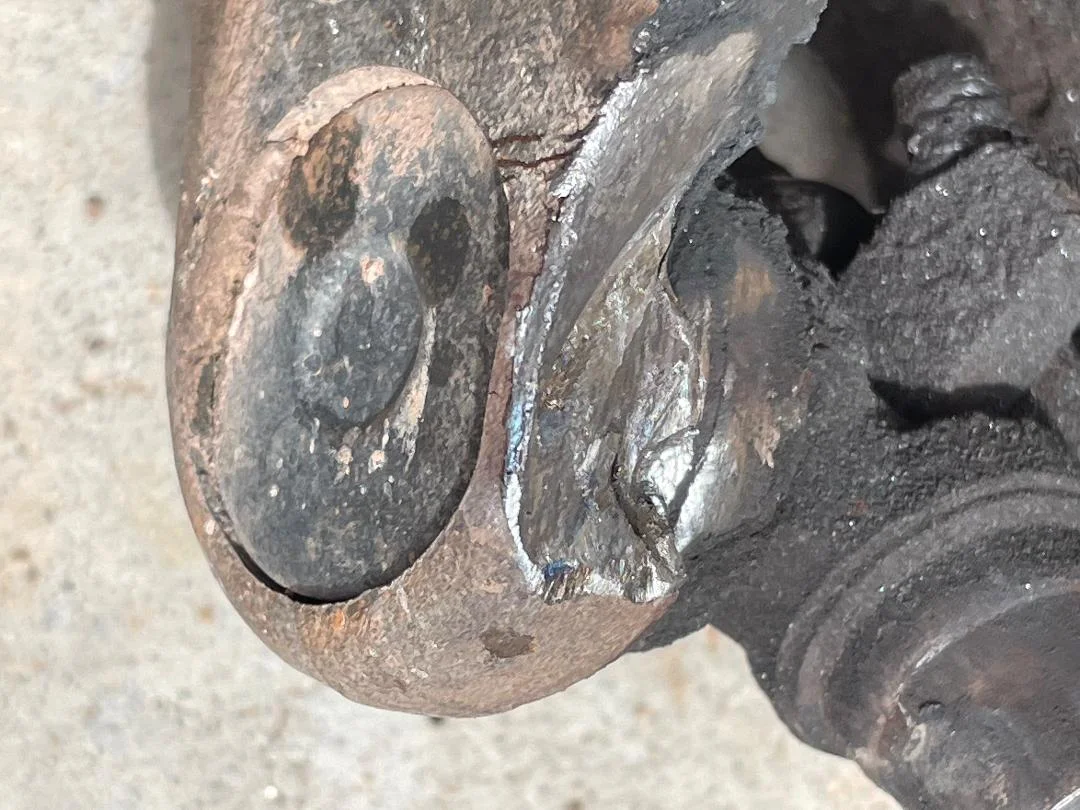

Aside of a bloody forehead I win. Last night sprayed it down and again this morning. Fought the last one to the death.... I WIN ! ! ! ! ! !

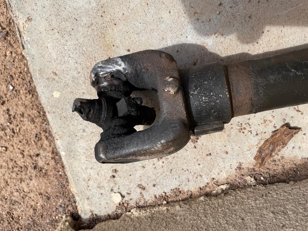

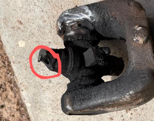

Time for a new DS
Really, doesn't seem destroyed. Let me put on readers and take another look.
You are correct. Now where to source this from... Can I just replace the yolk as it is the spline end?

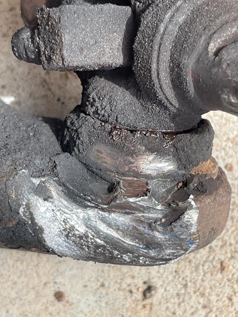

Is that a big grinder gouge on the yolk, and did the fractured post break during removal or was that the problem (fracture line looks old)??

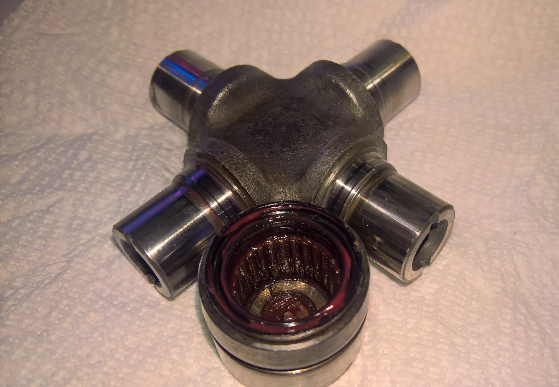

FWIW I attached a photo showing an originally installed U-joint (97 FZJ80) recently pulled that had 250,000 miles on it. Replacing it due to brinneling of one of the spider's posts.
If you click twice on the photo to magnify you can see very slight wear on three of the four posts (can't feel any step where the roller bearings rode on the posts).
One post however, bottom right, has some brinneling. If you look very closely at the flat end of the brinneled post you can see uneven wear on the surface that rotates/wears on the inside bottom of the end cap.
250,000 mile original FZJ80 U-joint:
Keeping these joints well lubricated is key to a long life IME/IMHO.
Here's a link with some good photos and discussion of U-joint failures including some U-joint fractures. FWIW
