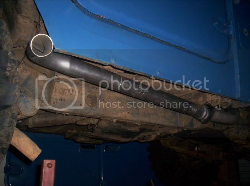

I run no muffler on my 42 turbo love it but on long trips with a soft top and no carpet it does getting annoying as it exits it drivers side. I will proberly get a new one but exit it to the rear still no muffler as I love that hint of turbo whistle.
BJ
Nice pics of the kid and cruiser!!
