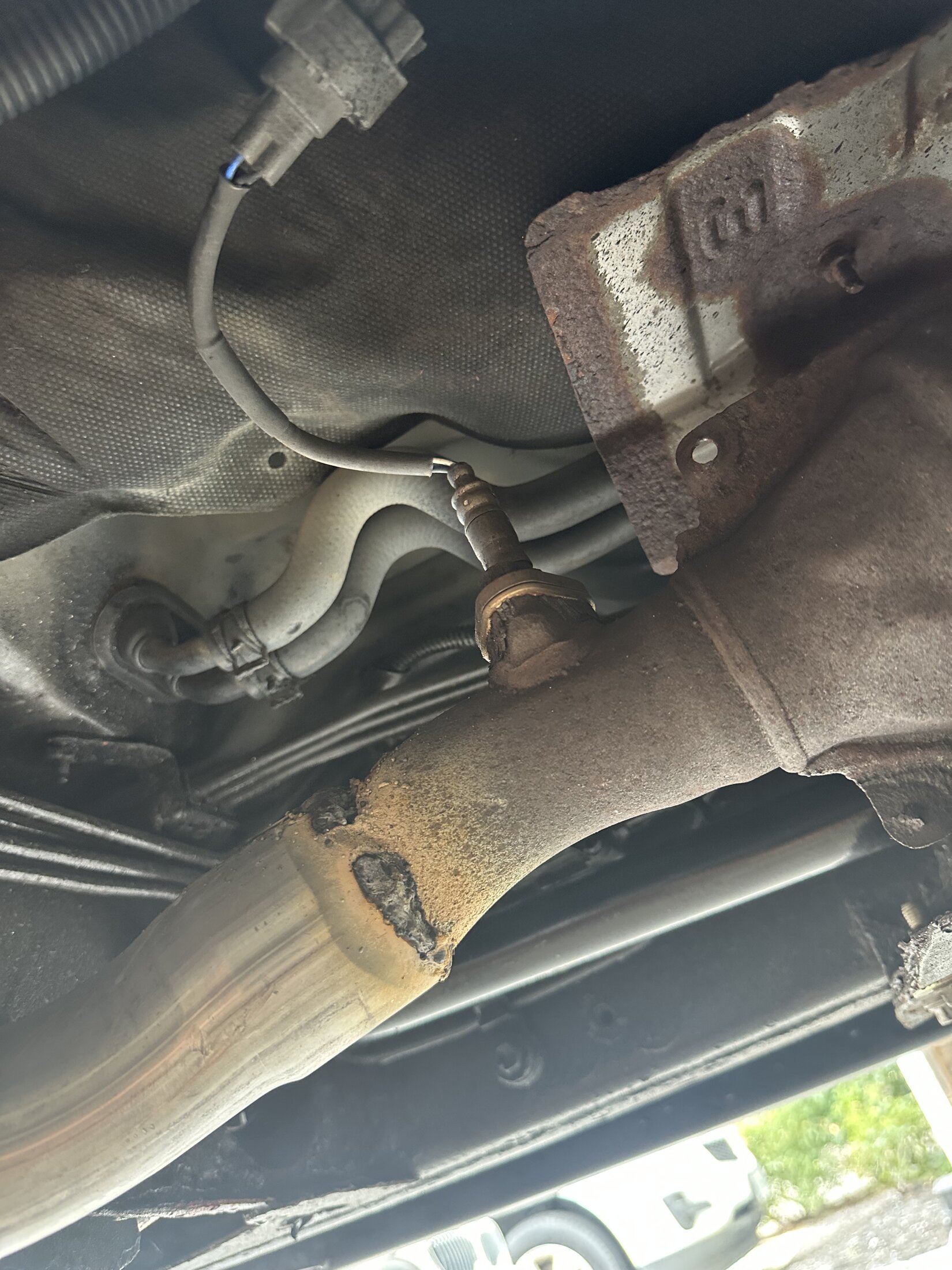

Alright I was able to clear all the issues except the O2 sensors TID 31 and TID 32. These look to be the O2 sensors on the cats just before the exhaust. It appears the muffler shop my mechanic took my truck to welded the Borla exhaust on the cats just after these sensors. I wonder if not having the flange there is something that’s throwing these sensors off? Here’s some photos
