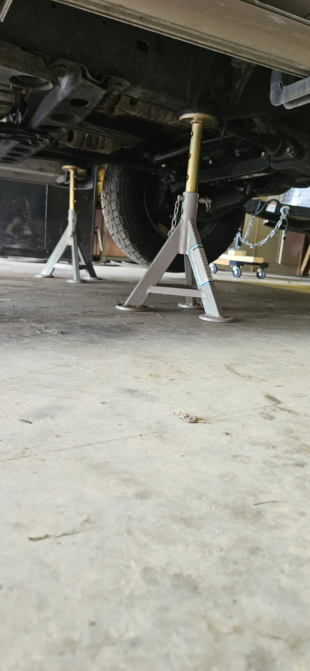

I started by getting the Cruiser up on some Esco jack stands.

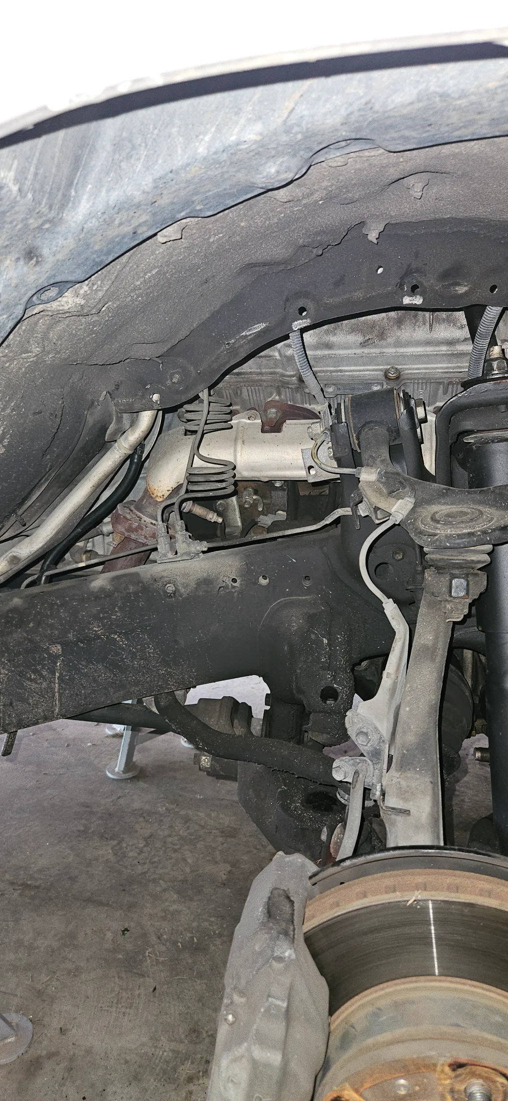

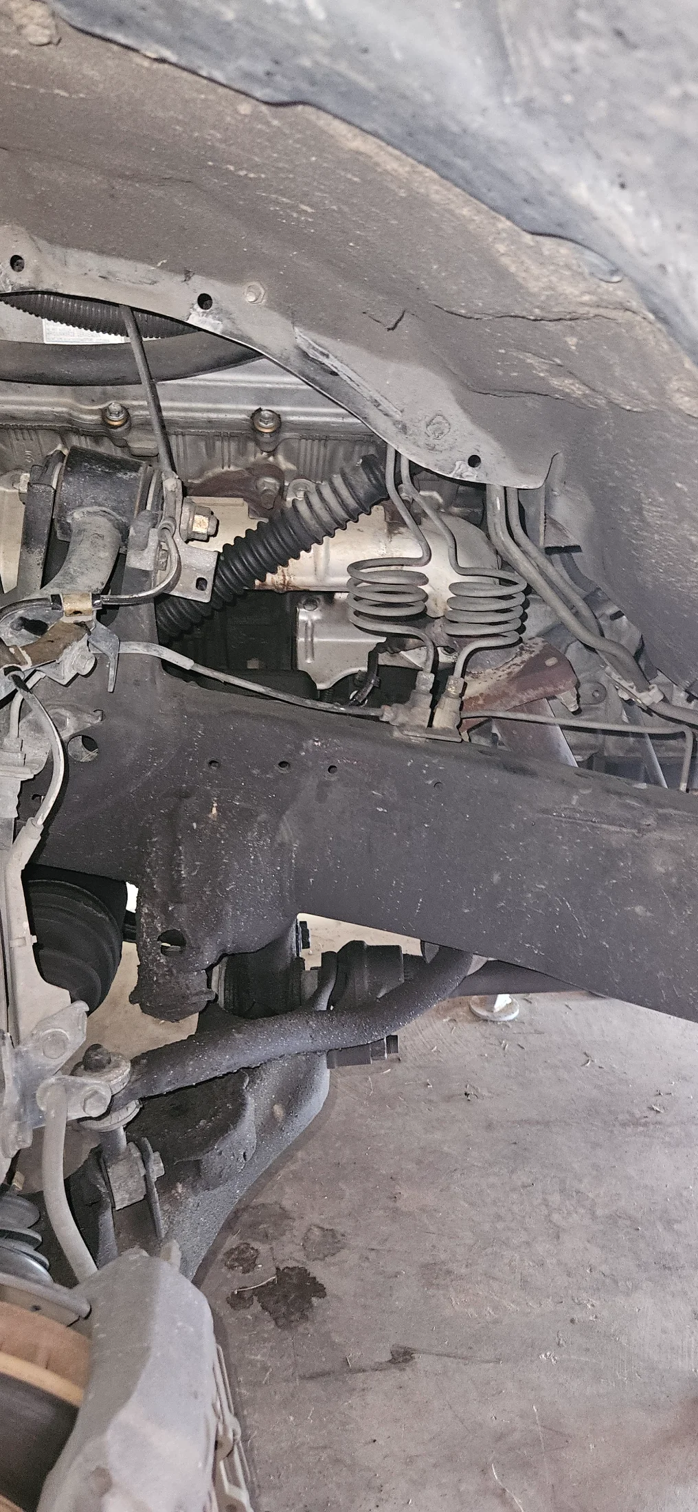

Then, I yanked the front tires, skid plate, and inner fender liners. Ended up here.
Driver side
Passenger side

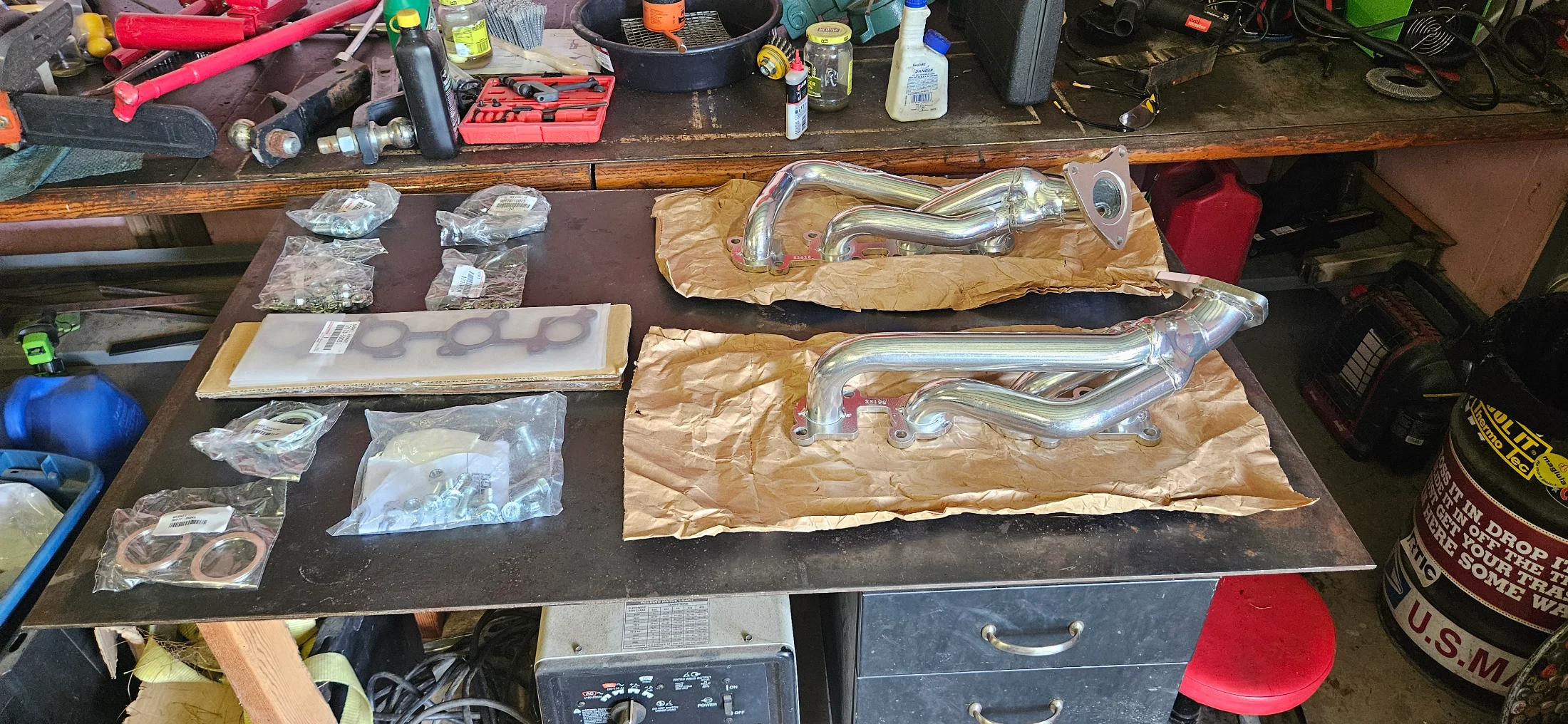

Also got my parts laid out on my work table.
My barn is a mess and it's really small, but I do get a lot of wrenching done out here!

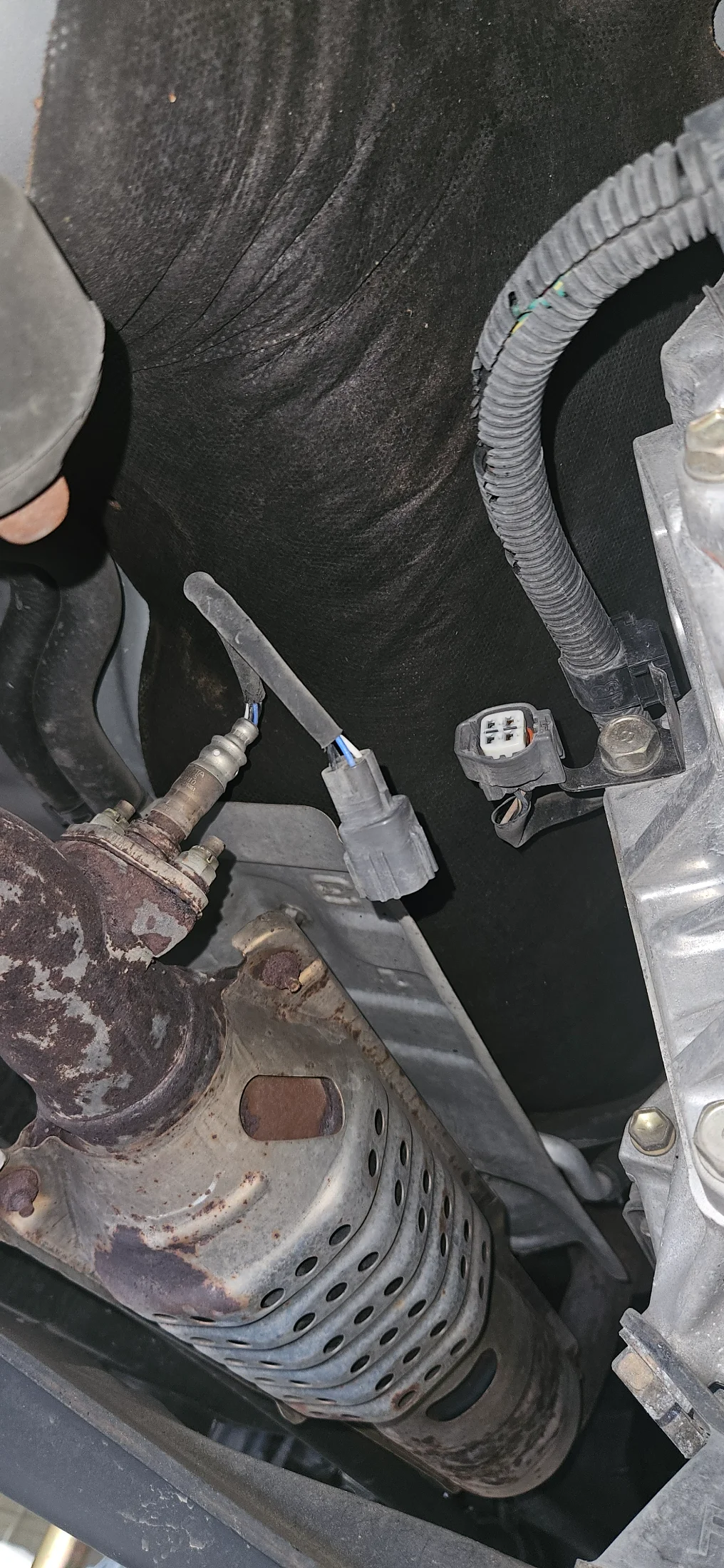

I started by unplugging the rear O2 sensors on the cats. The driver side is easy to get to.
The passenger side is tighter to get to the release tab on the plug. I shoved my left hand up there and was able to press the release tab with my thumb and pull the plug with my right hand

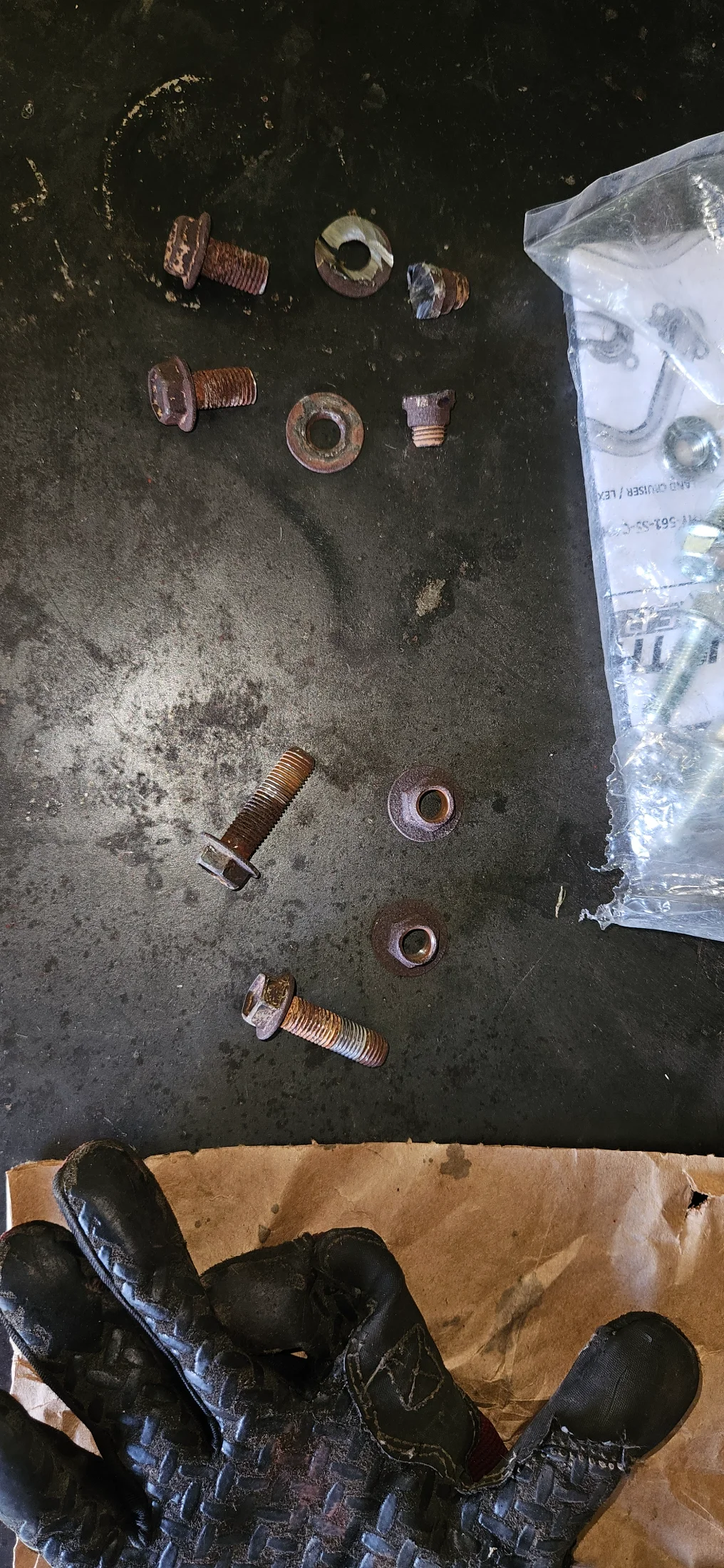

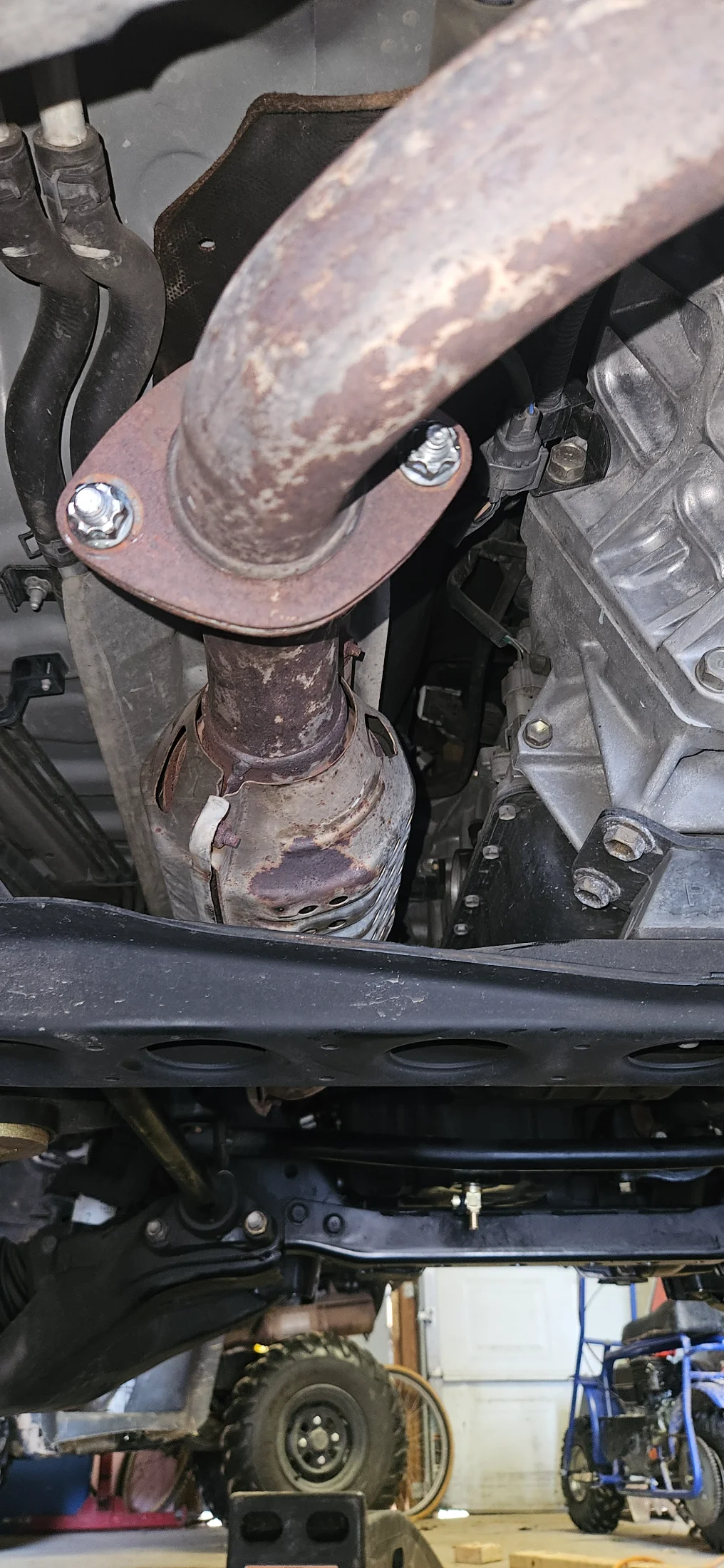

Next up was the rear cat flange bolts, two on each side. I used my impact, and the passenger side came right off. Driver side immediately stripped! I got the grinder and cut off disc and went to work. 30 seconds on each bolt and those were free. In this picture, the bottom set is the passenger side
Then I took the manifold flange to cat nuts off. All came off with the impact, one snapped off on the passenger side.

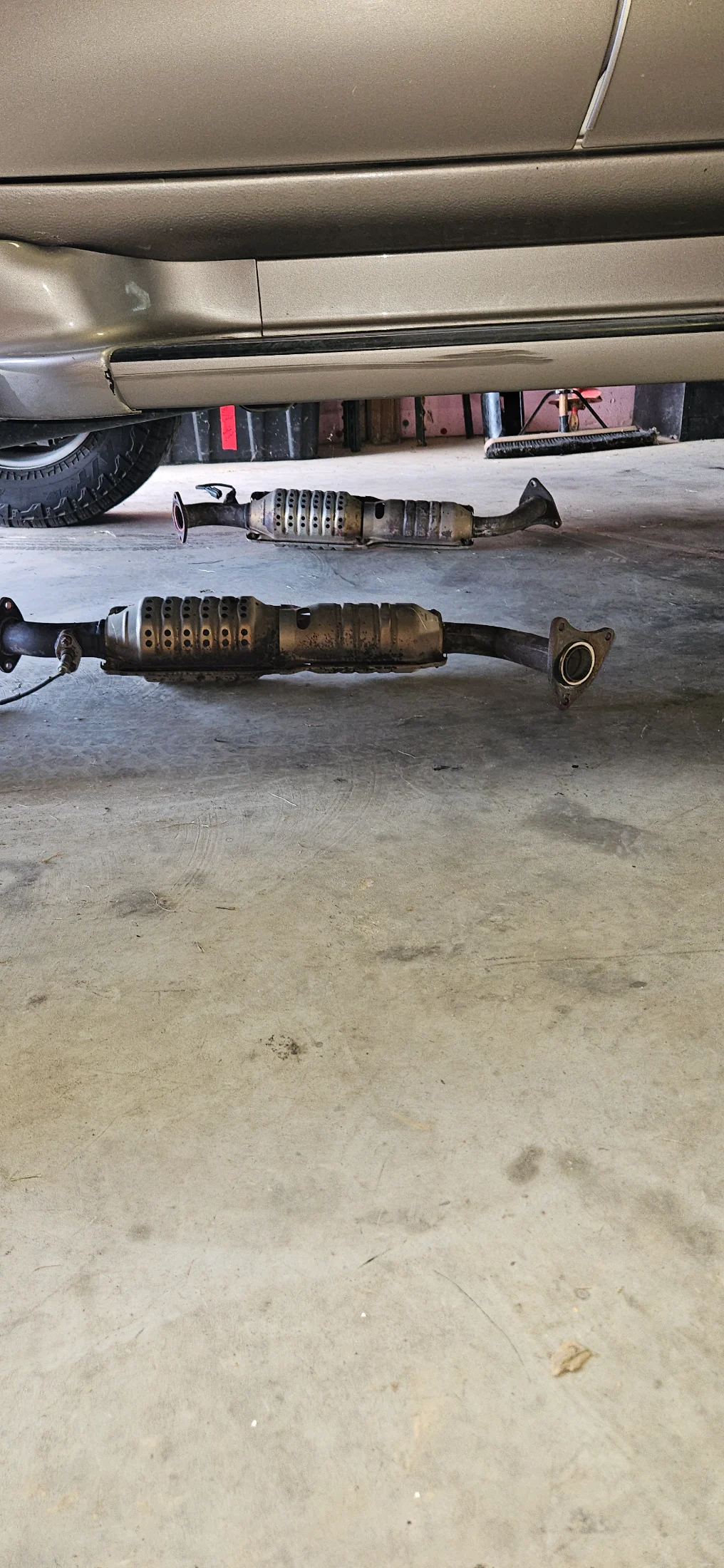

Then I dropped the cats out of the frame. Easiest way is to get the rear flange loose and push it upwards. Wiggle the front flange off the studs, then you can fish the cats down and out the front towards the engine. I just pushed these back under the LC to sit for now.

Passenger side, lots of room!

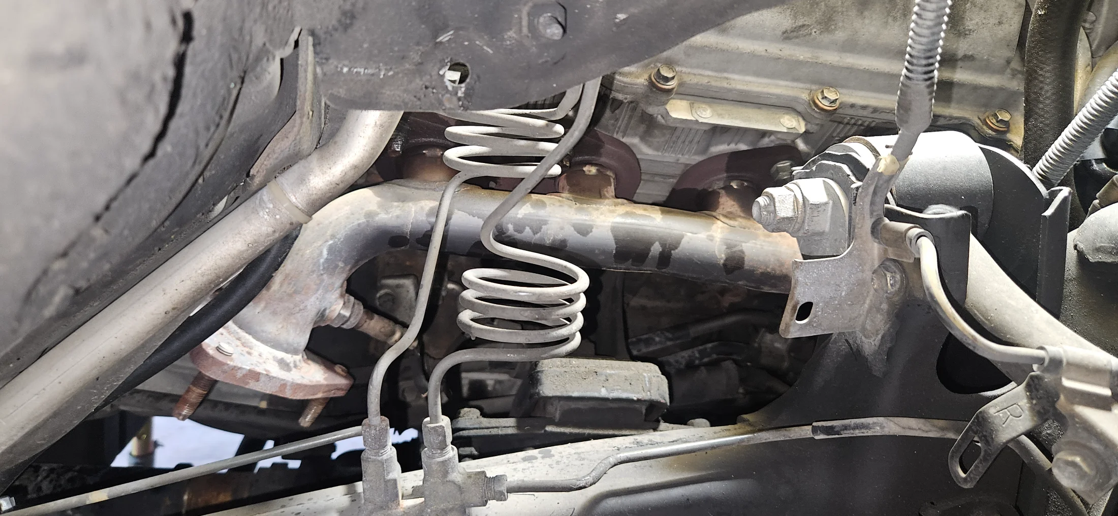

Driver side, this is going to suck!

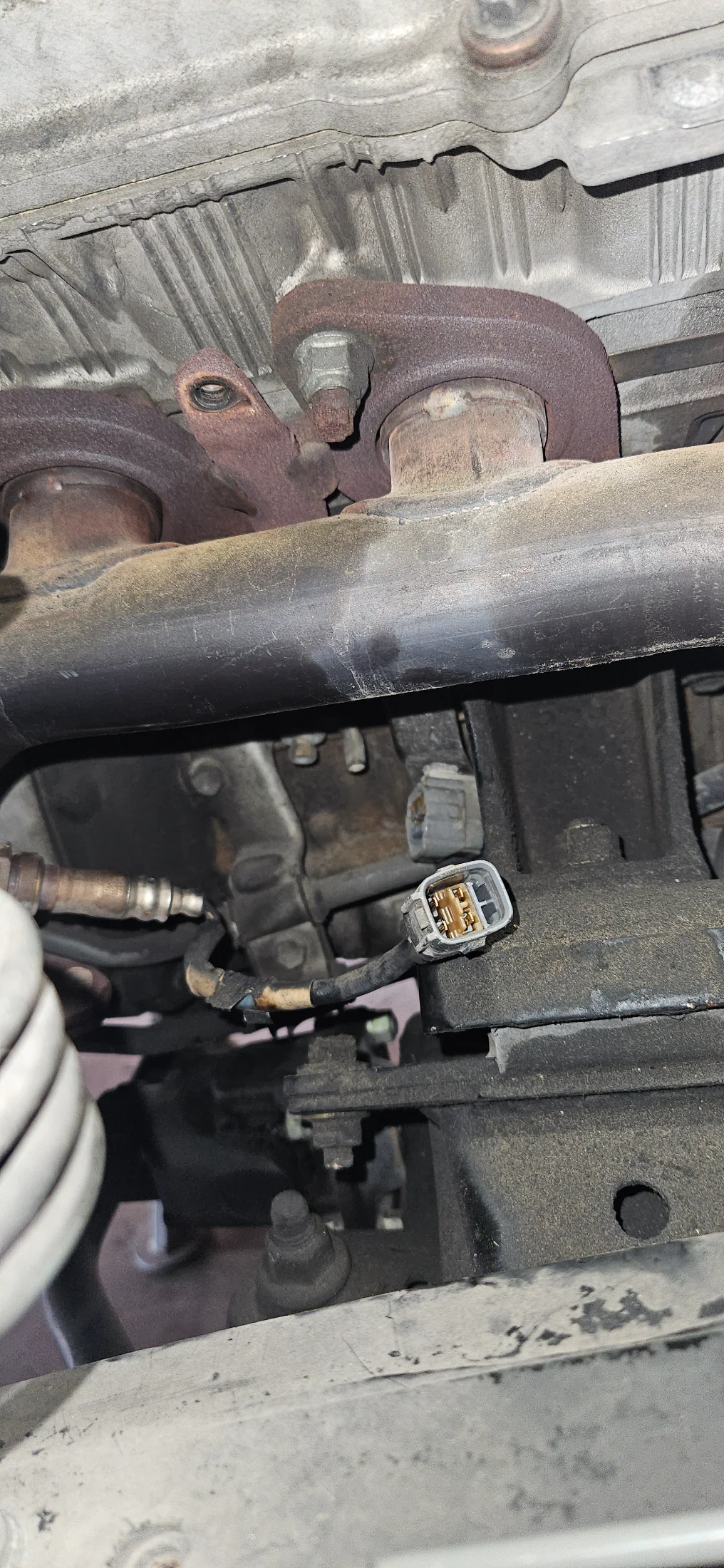

I started with the passenger side. Step one was getting the forward O2 sensor disconnected.

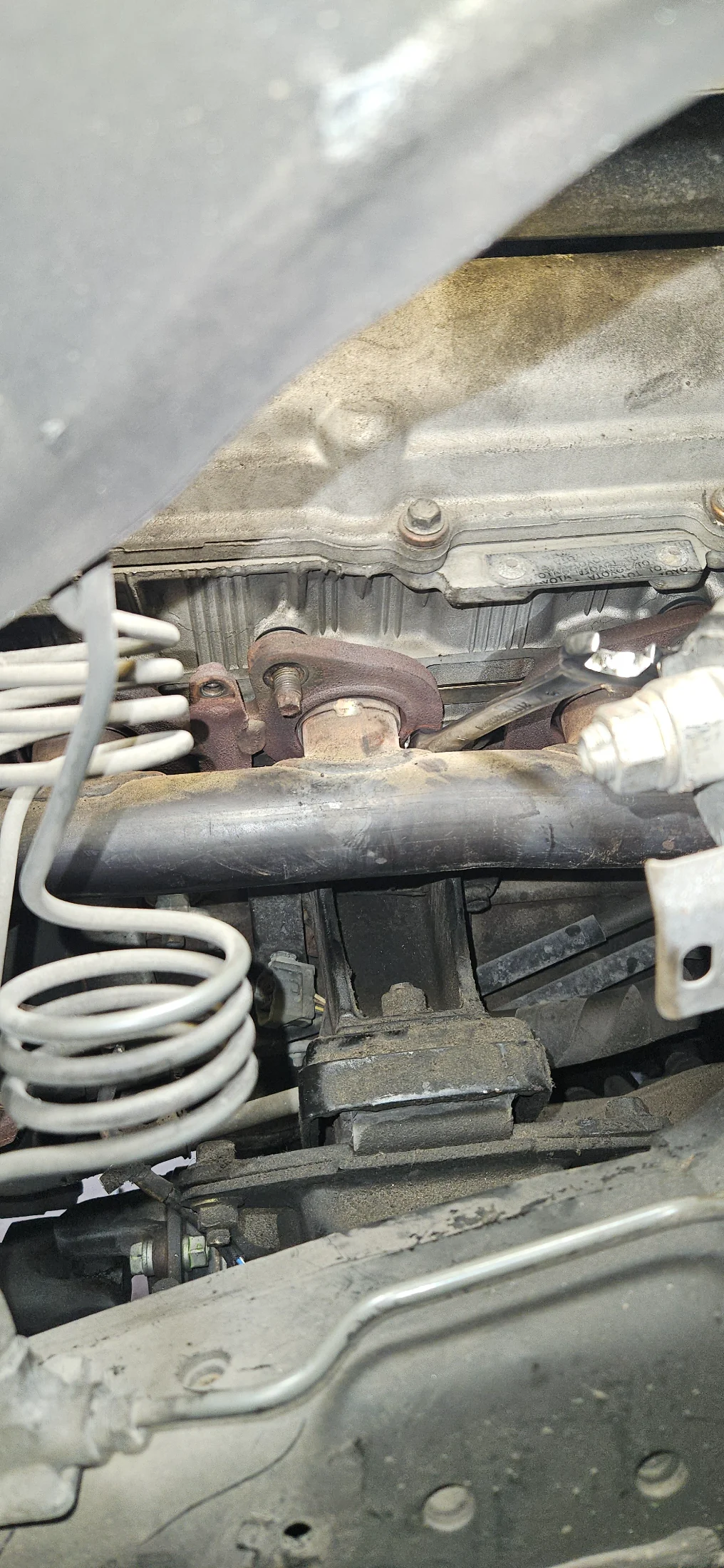

Then I started pulling all the manifold nuts. I could get 7 of them with my impact, except this one on the bottom just above the motor mount. Had to use a wrench on it.
The manifold then came out easy, and no studs came out.

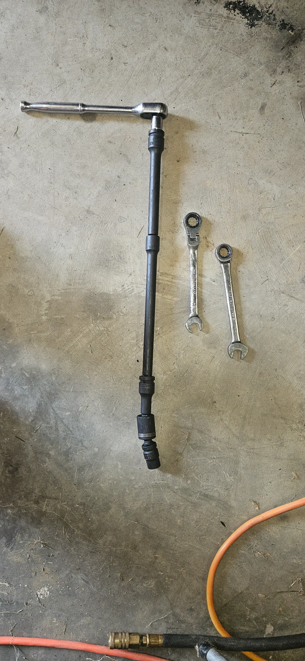

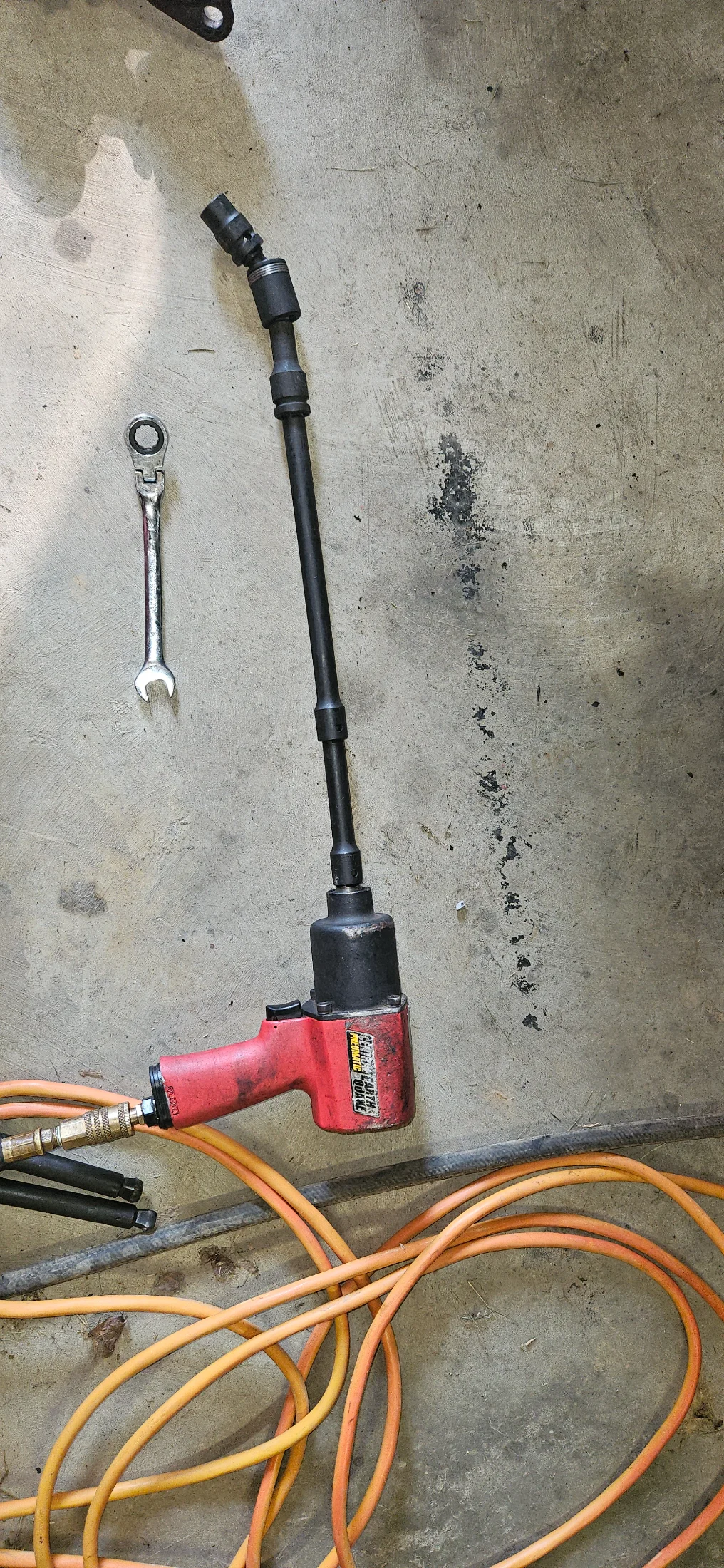

Here is the extent of the tools I used on the passenger side: impact and various extensions and swivels, and the wrench. I didnt use the two extensions right at the bottom of the picture.

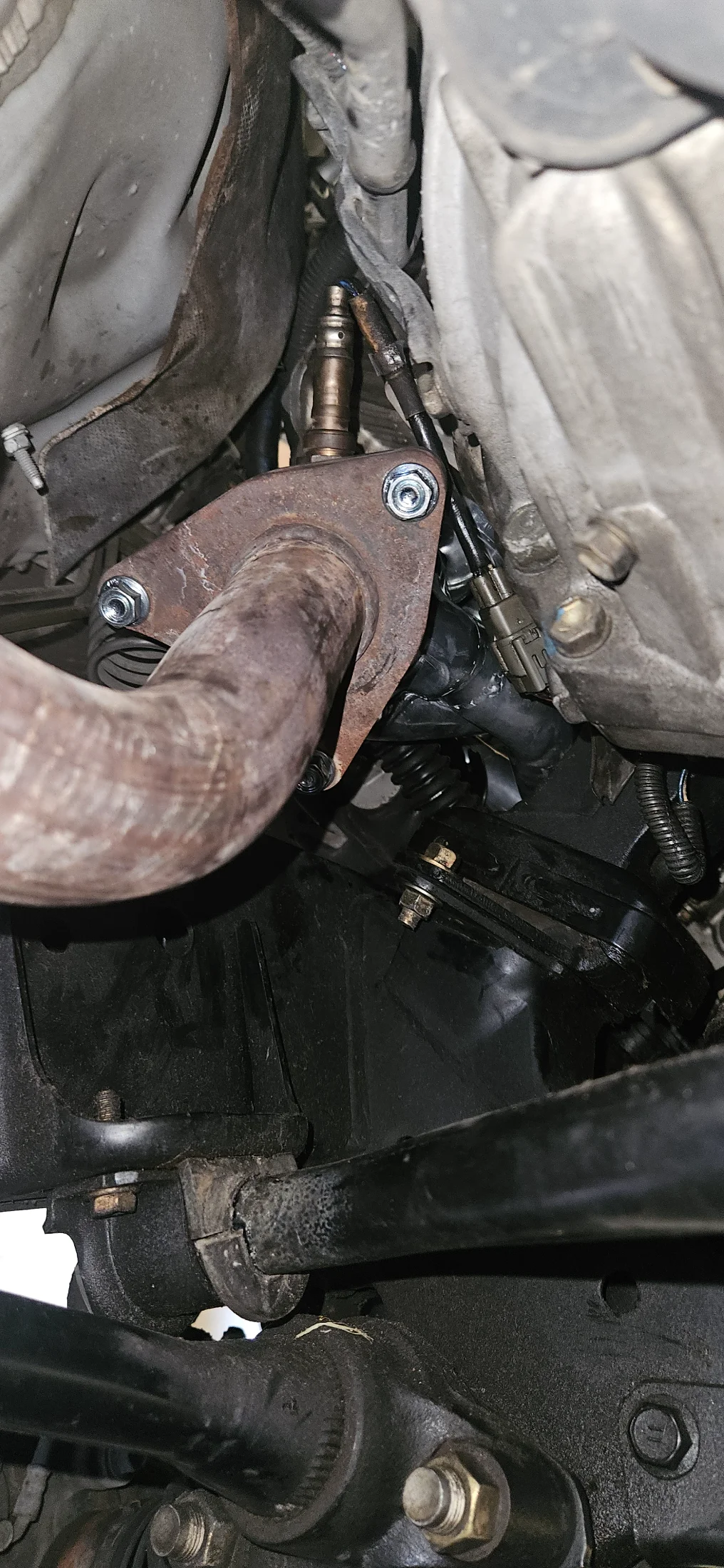

Getting the bottom nuts i had to come from underneath next to the differential.

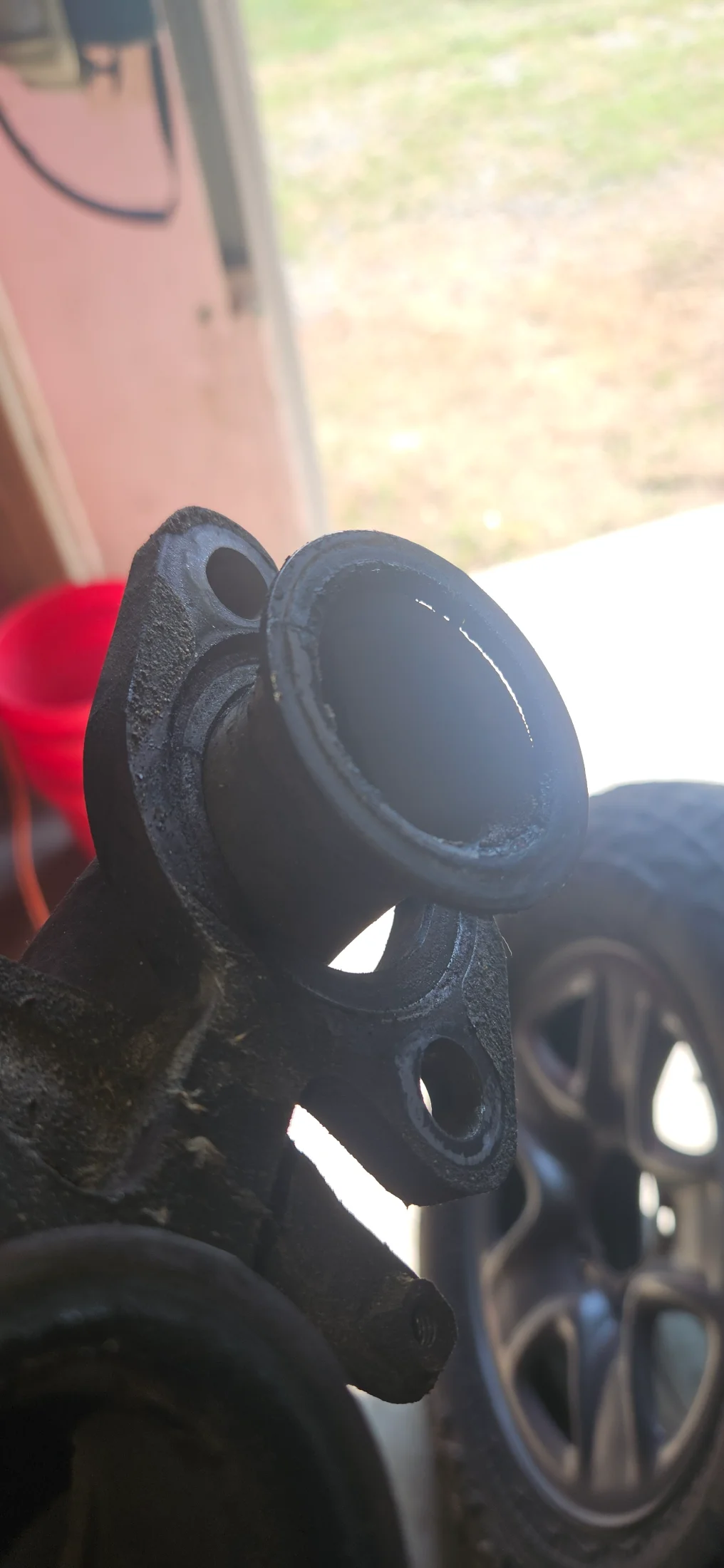

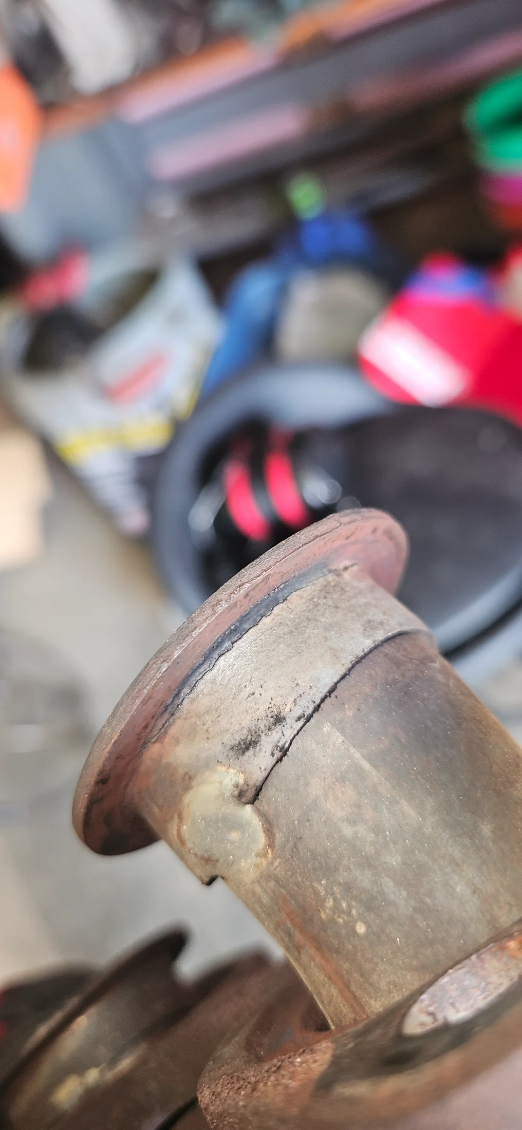

Front cylinder has a hairline crack on it.

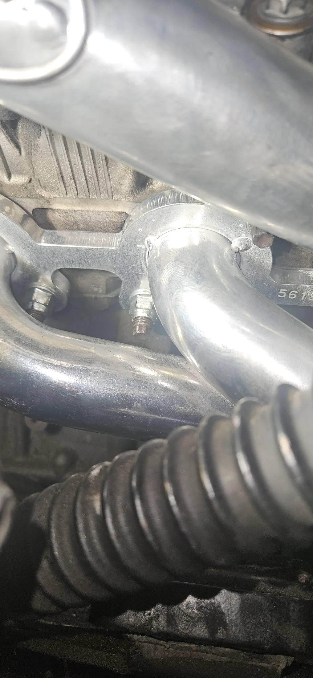

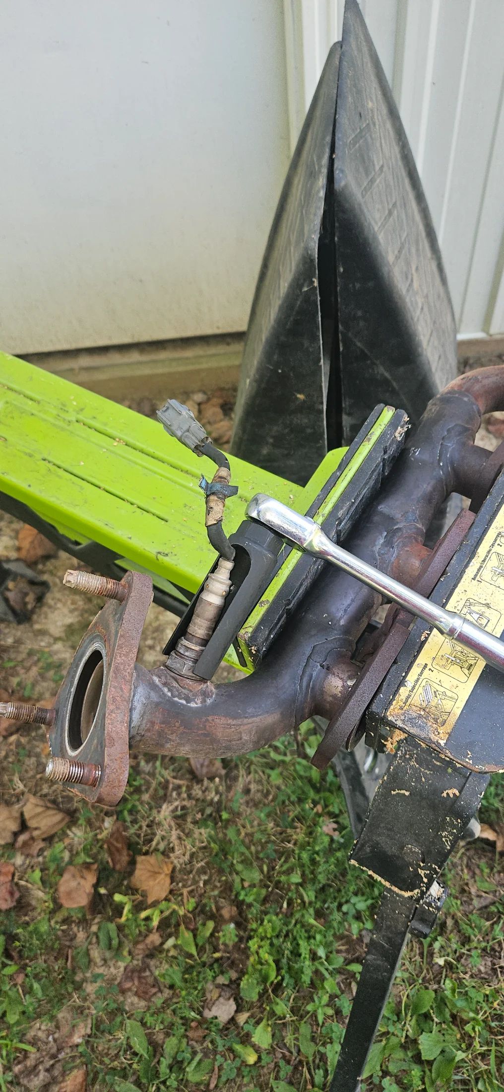

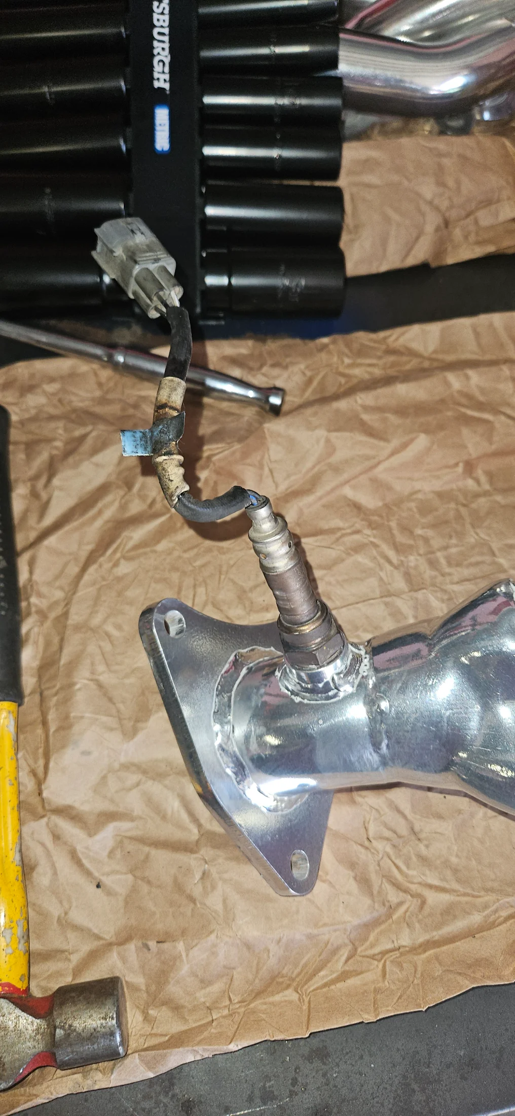

Next up was swapping the O2 sensor to the new header. I used my jawhorse to hold it.

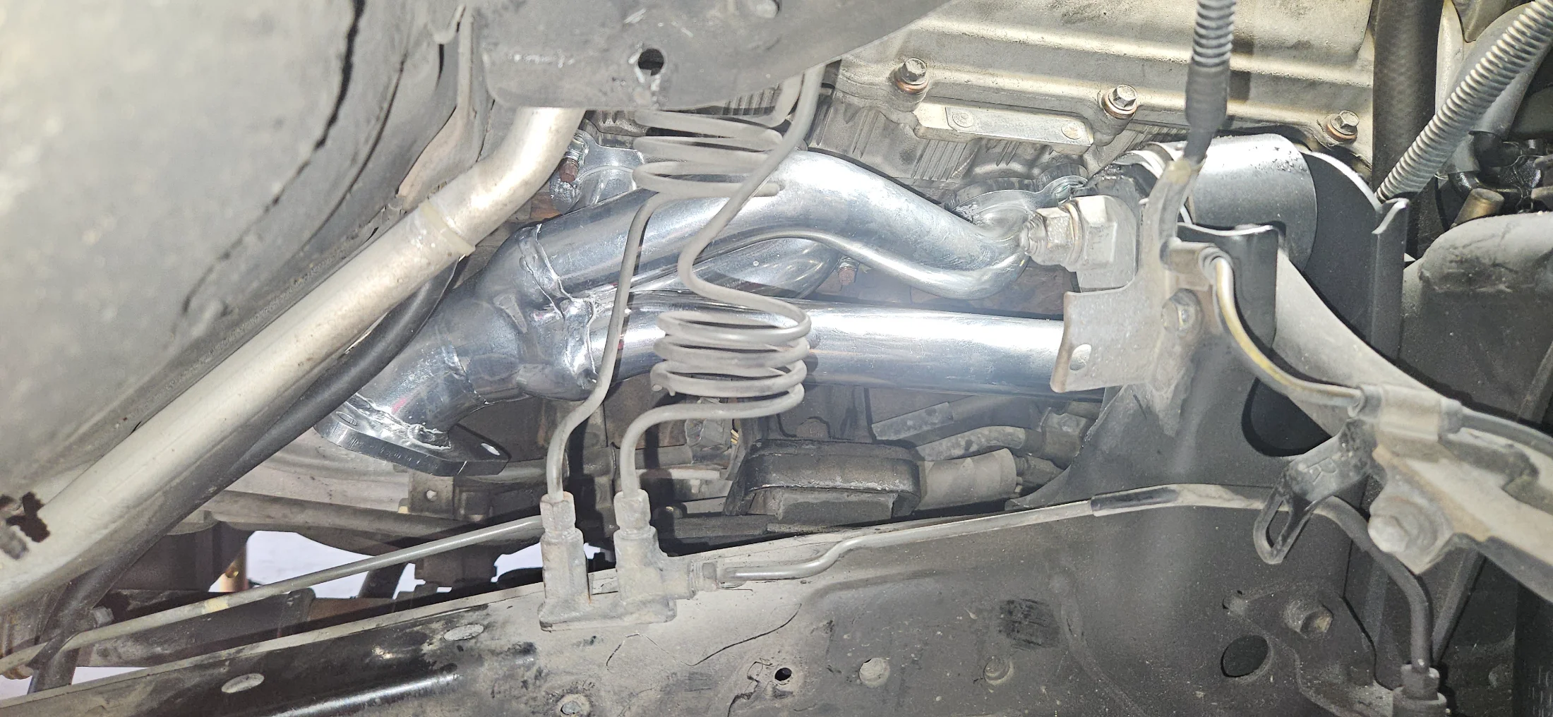

And installed
It went back in quite easily, lined up nicely and bolted it down
Here are the tools I used to reinstall the passenger header

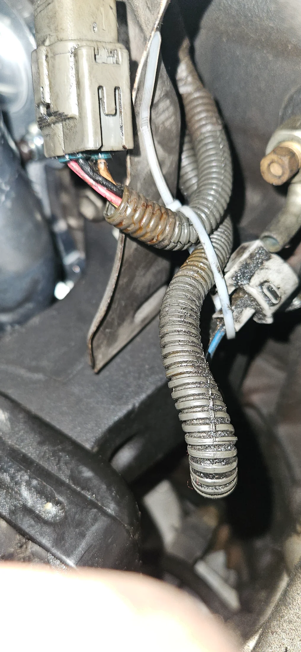

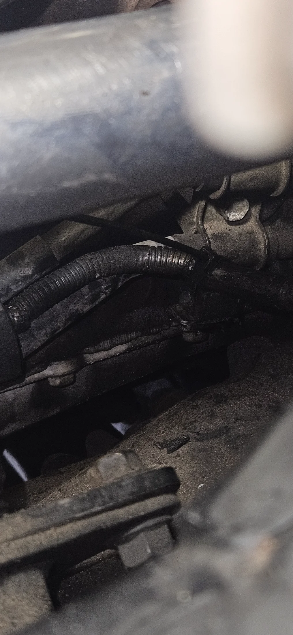

The O2 sensor wiring, I released that clamp and pulled it further back. Then I used that now empty clamp to hold a zip tie and secured the bundle.
The 5 photo max is making this hard.
Anyways, here is the 02 sensor wiring and connector, nicely clear of the header tube

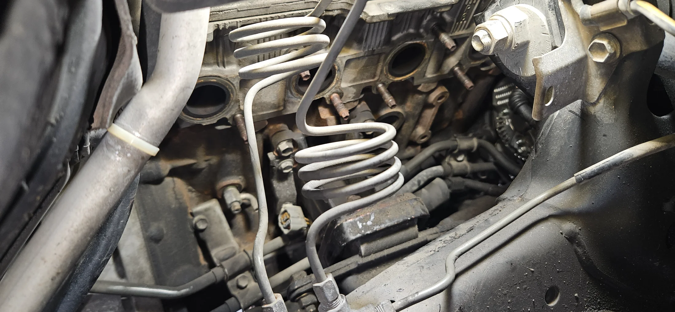

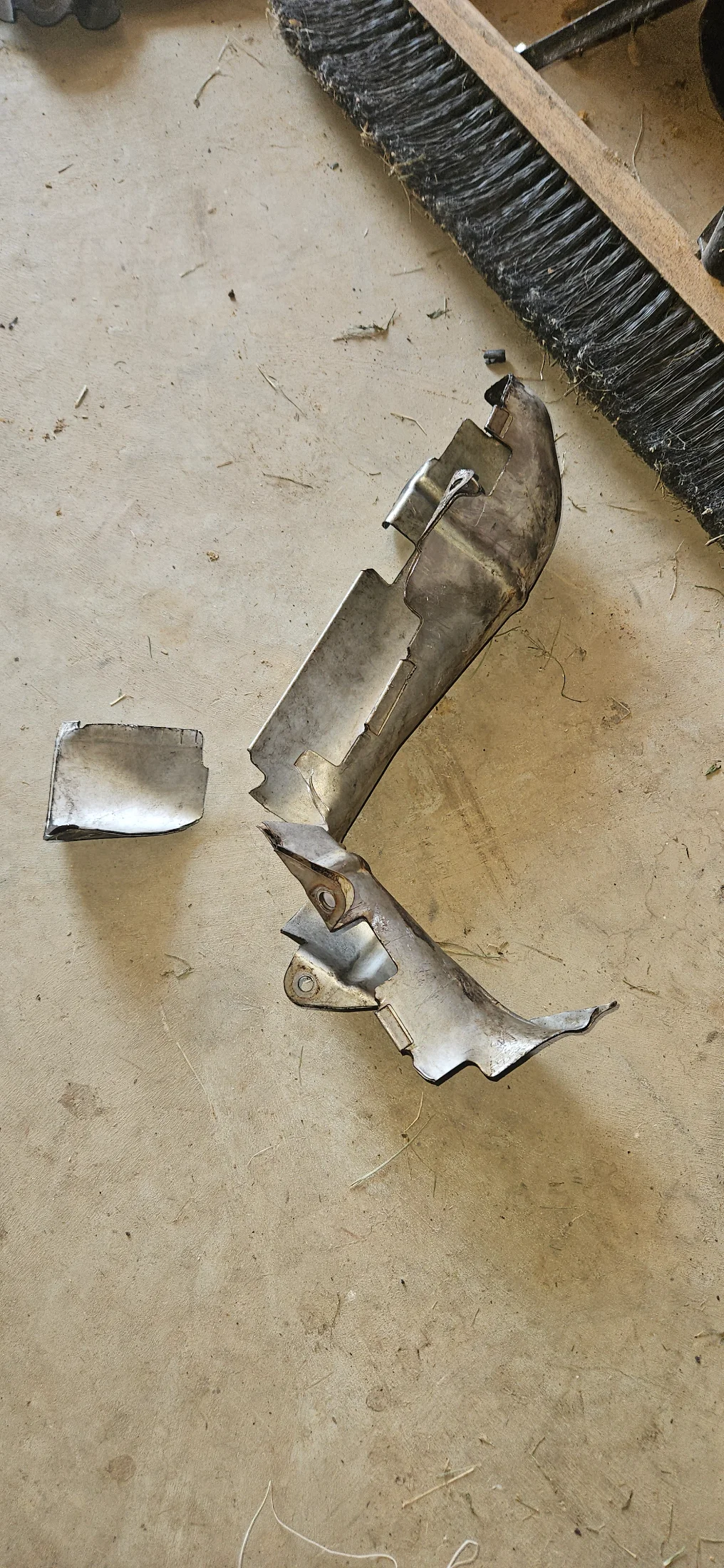

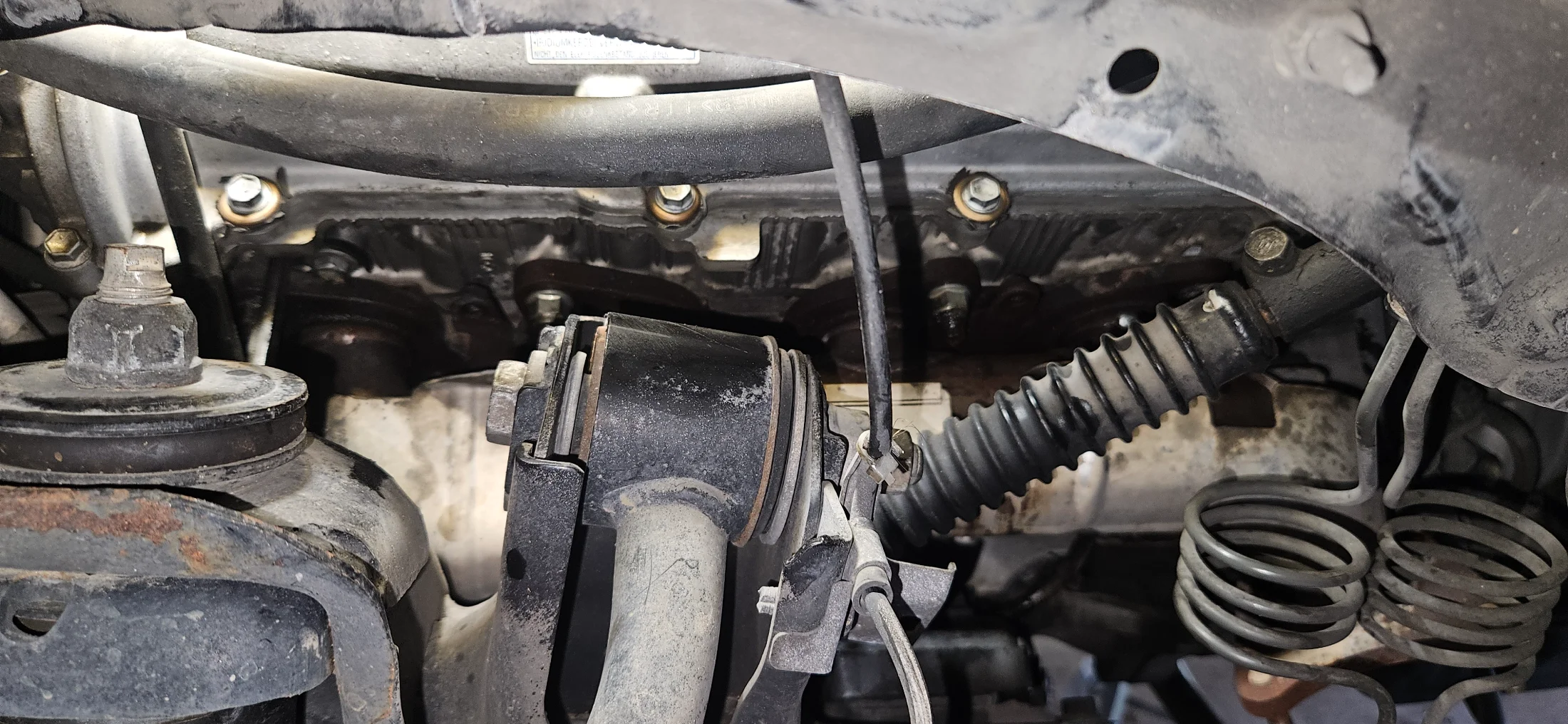

Then came the driver side. I could remove two nuts that I could access before lifting the engine, so I did, and then jacked it up about 1.5 inches. Got the rest of the nuts off, but not before getting the heat shield out. I cut it in pieces with some snips and bent it up to get it out. Made my life a lot easier.
I got these manifold nuts pulled and the manifold came right out. No pulled studs on this side either, but big crack also on the front cylinder.
This side was much more difficult to get the nuts tightened. This one here, bottom nuts third cylinder, was easily 20 minutes of turning it 1/64th at a time.

The O2 sensor connector I had to pull off the little metal bracket. I ran a zip tie through the hole in that bracket and bundled up the wires and connector here.
Got the cats reinstalled with new gaskets and all new hardware

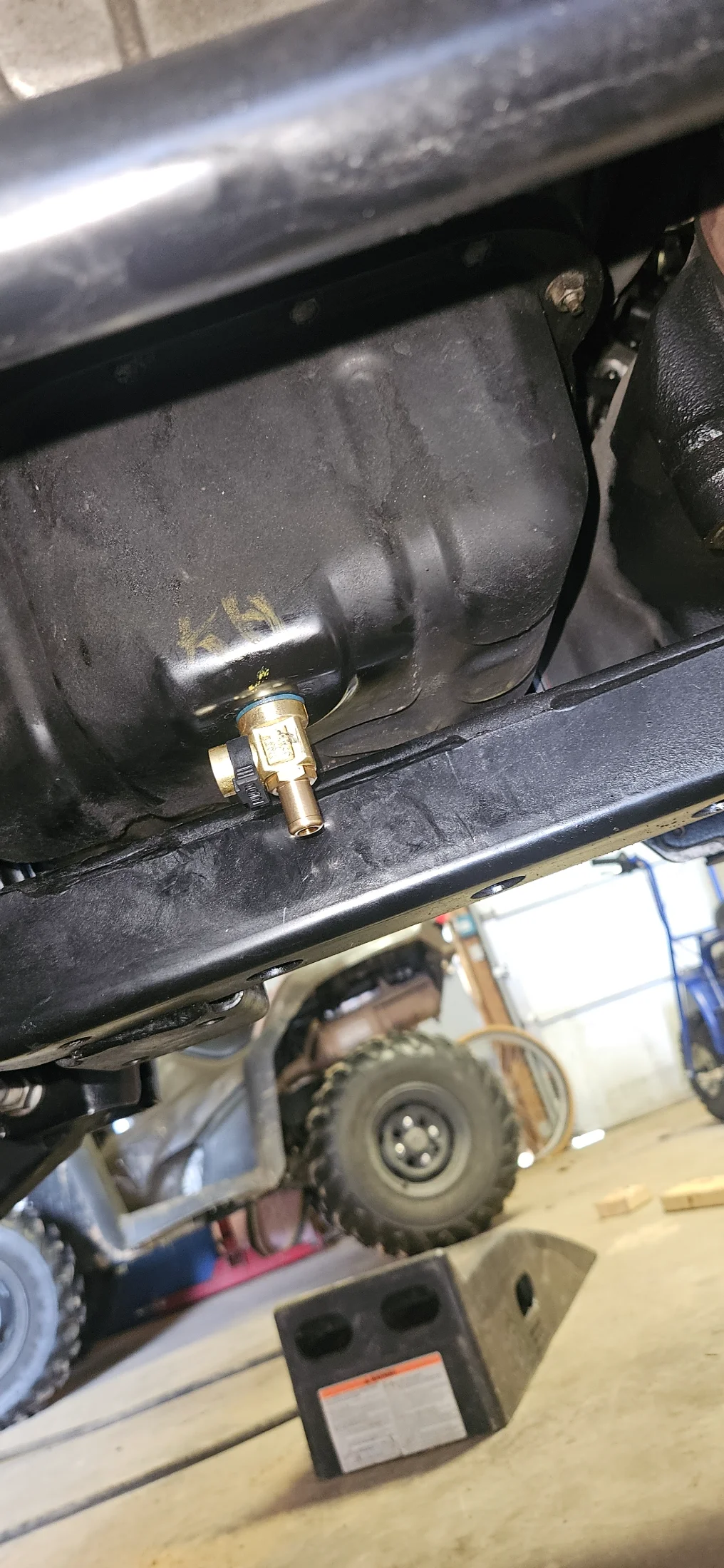

Also did an oil change and installed a Fumoto valve on the drain pan

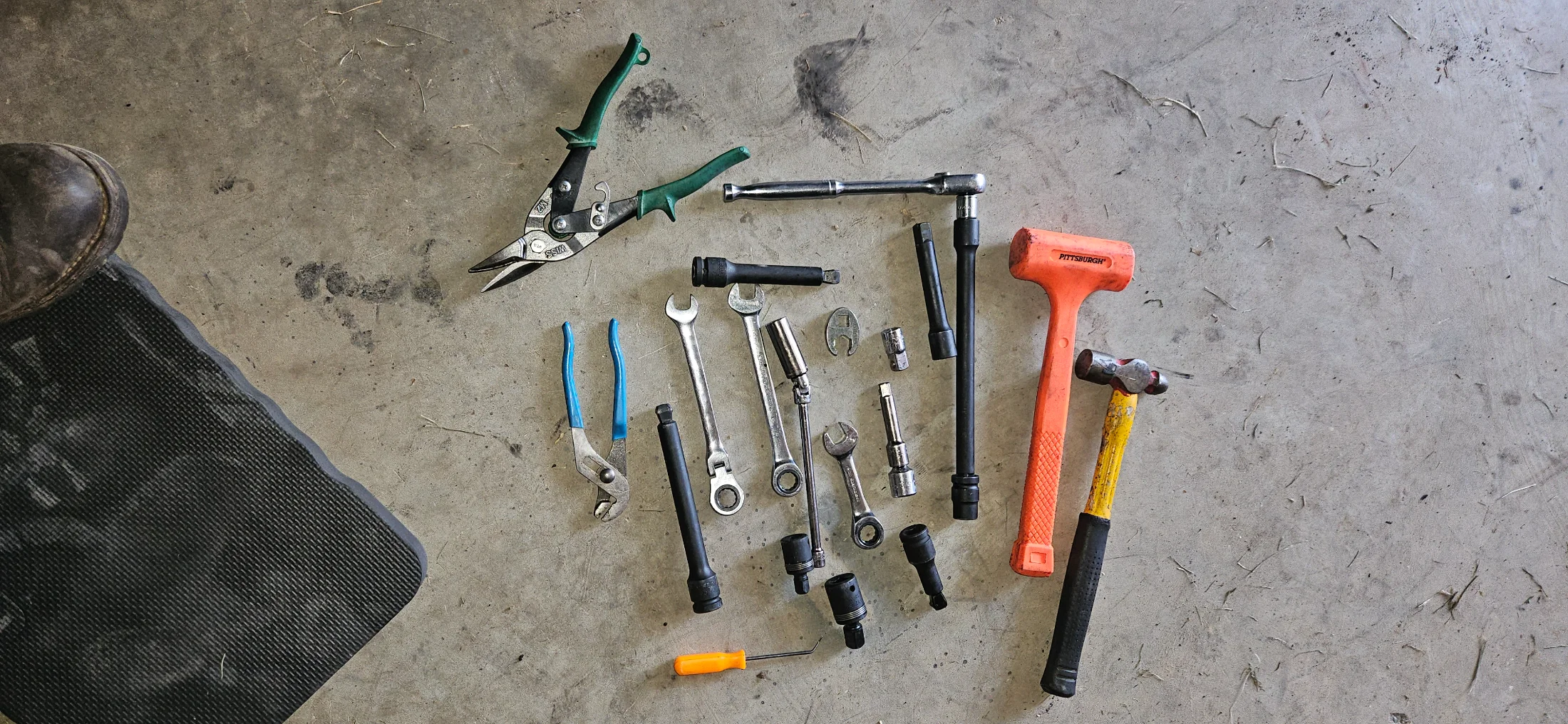

Here is the pile of tools I had to use on the driver side. The impact was also used.

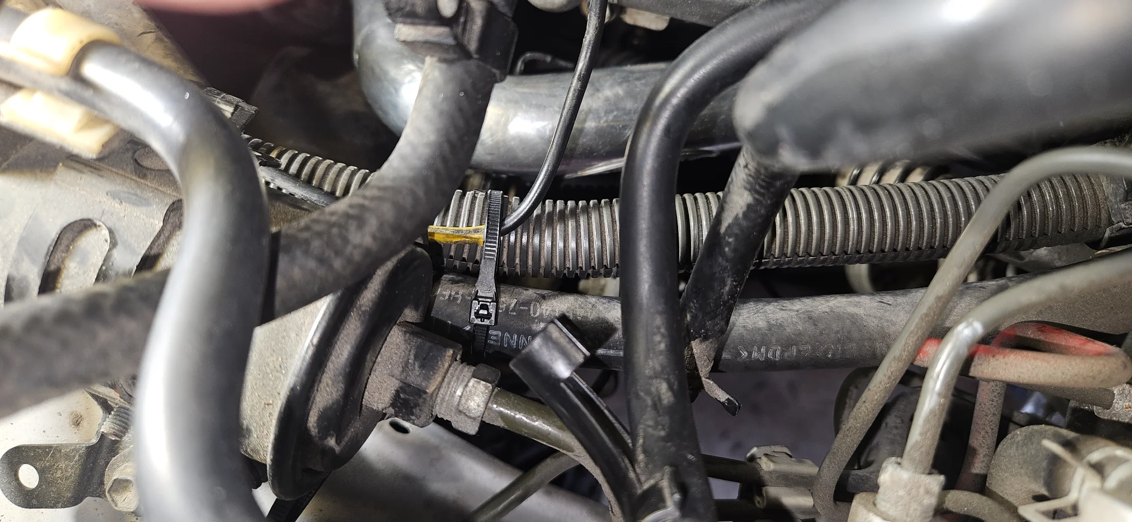

Final order of business was to zip tie the ac lines and wire bundle up on the driver side. I used a hole in this bracket by the fuel filter to hold my zip tie.
Then secured the bundle like so

There are no new heat shields with the new headers and you don't reuse the old ones?
