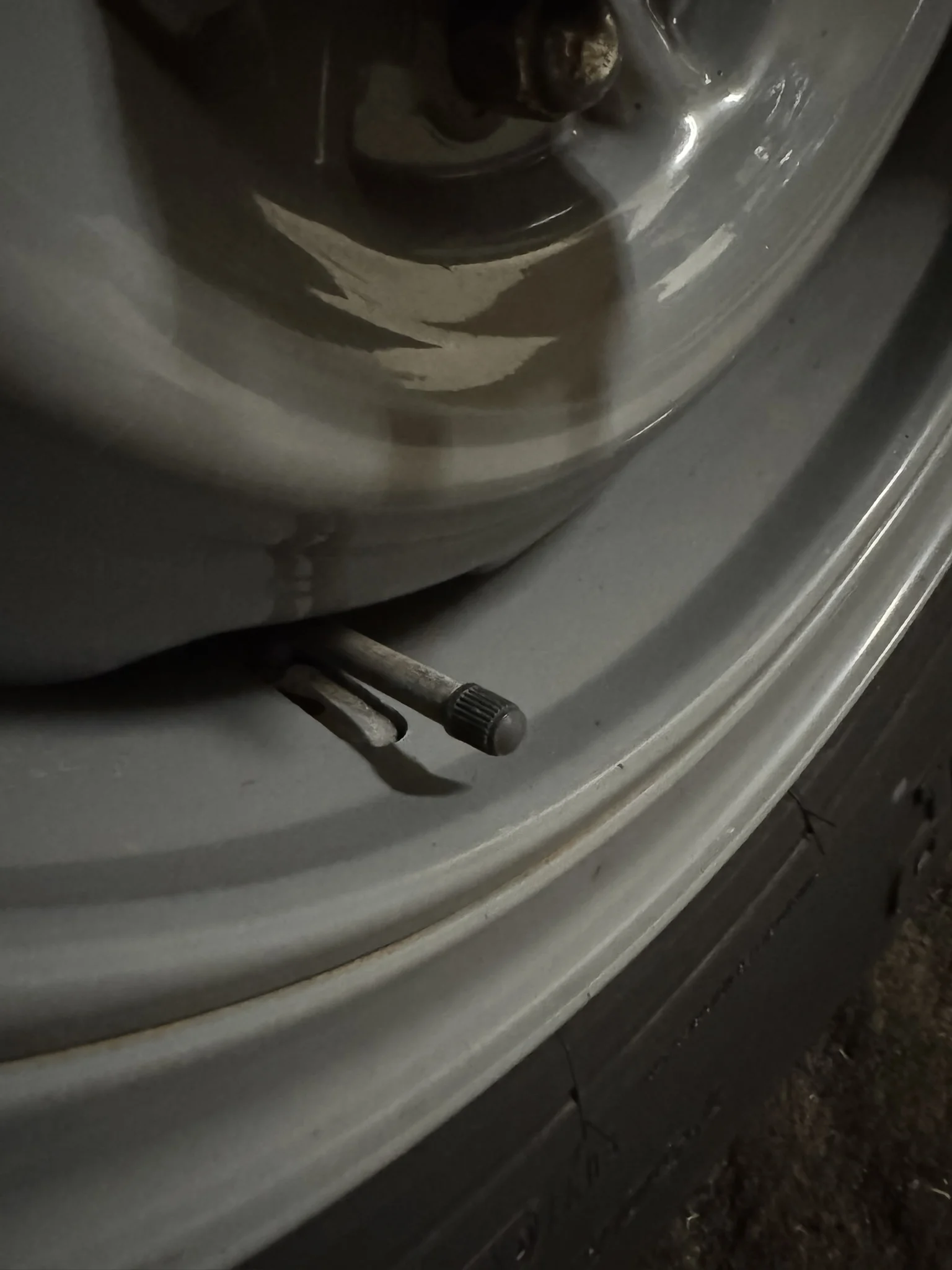

Between my 45 Troopy and 75 Pickup I have 11 of those tire, rim, tube combinations. Having said that, I have never purchased a spare tube. I had new 7.50r16 tires mounted on two new rims in Saudi but the tire shop supplied the liners and tubes. I think you want a tube with a TR75A valve stem which is an all metal stem with a 90 degree bend. Be careful of the length of the stem though. One of my rims on the pickup has a longer valve stem which I think is undesirable.

10 out of 11 look like this:
The odd duck:
+1 for the TR75.

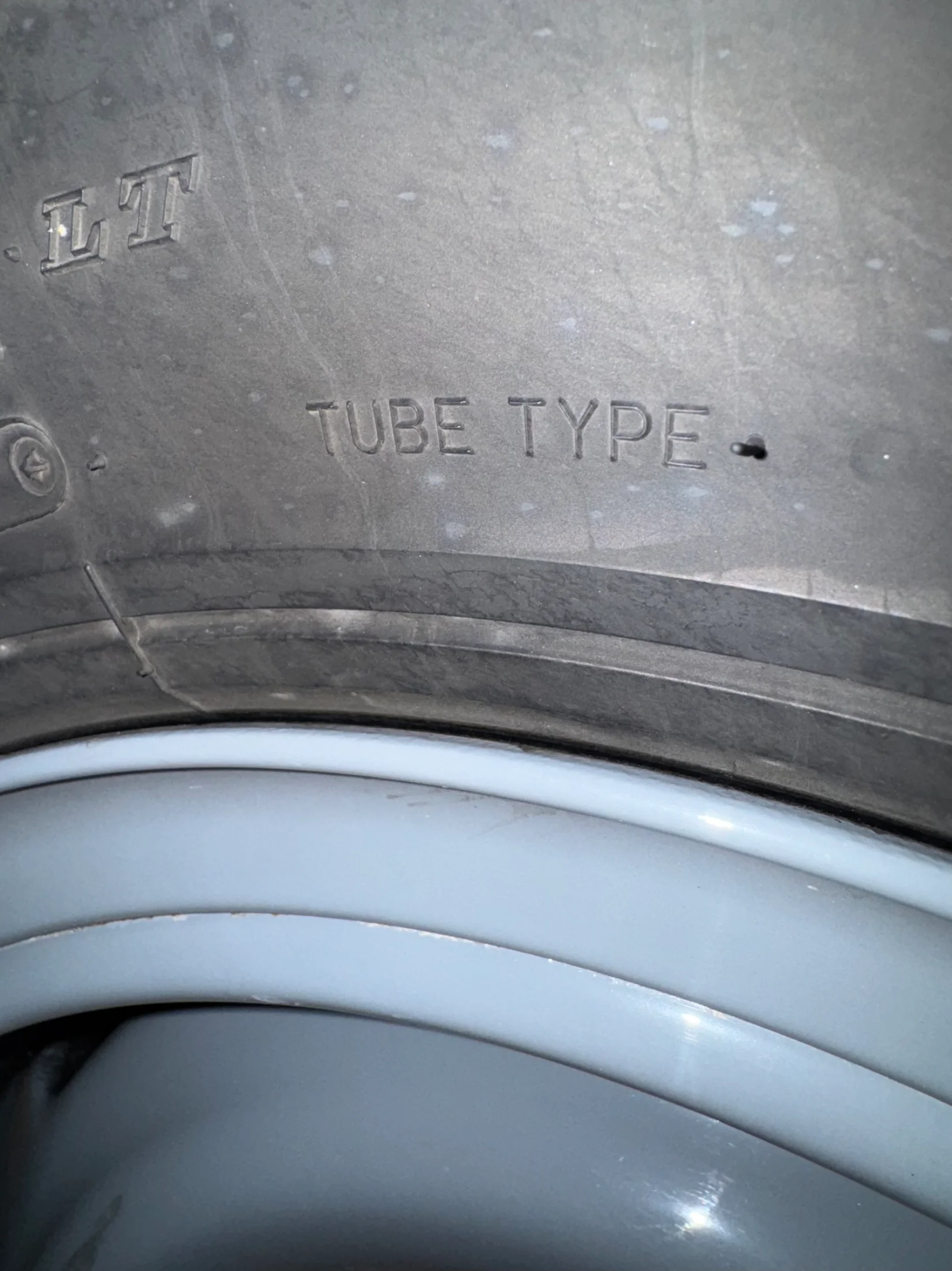

Good point on the tires and something I haven't given much though to. My tires say "Tube Type" on the sidewall.
