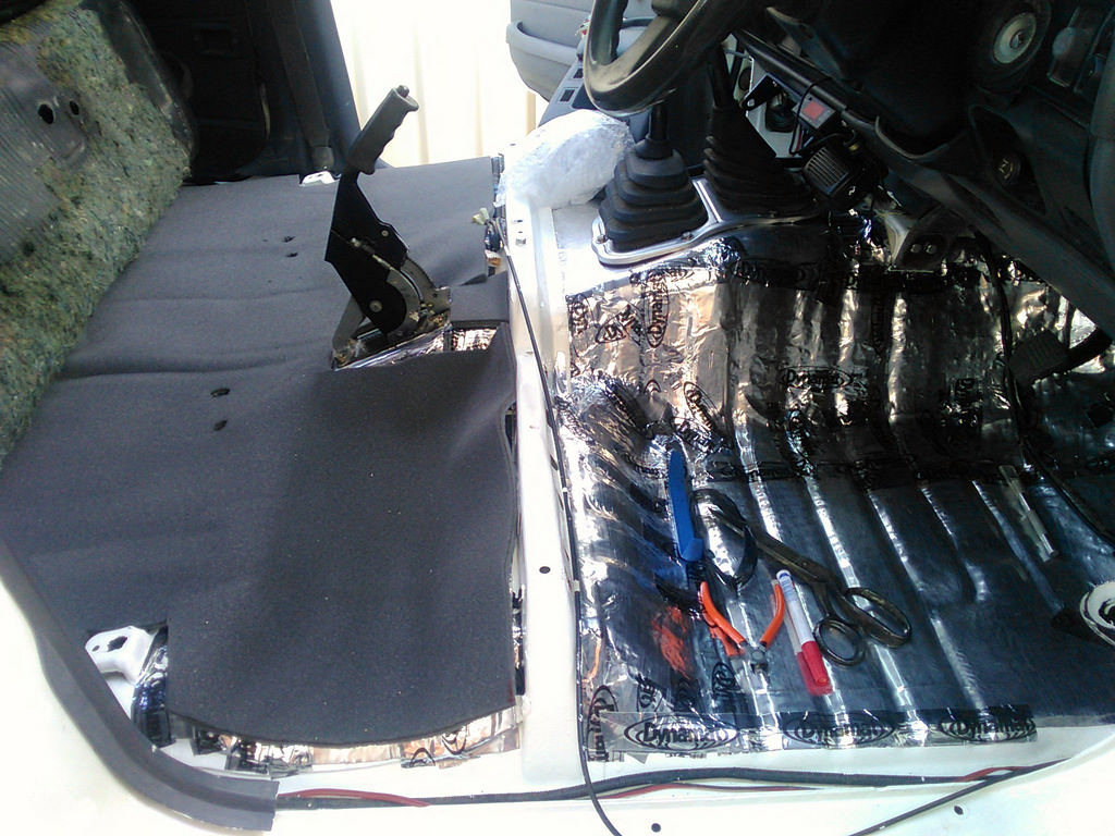

After cleaning out the interior over the past couple of weeks, I took to installing the sound deadening underfelt. They gave you more than enough, so you can really go all out if you want to get it into every crevice (we know Mr. T didn't do this), but this is a trail rig so I didn't really go overboard. I did the cutting in the truck, not using the existing carpet as a template as it is hard to do without knowing the contours.

Tips based on today's experiences...
1. I used the plastic channels from the existing carpet for each door sill (it is just stapled to the carpet). I used the channel in place as a guide for cutting the outside edge of the vinyl and then used a staple gun to secure it in place. On one of them, I put the staples too close and ended up cracking the plastic, so space them out at least 2 inches apart. Once they are stapled in, pull the plastic up and bend the staples back manually to lock them in place. Install them as close as you can to the center of the channel - some of mine are too far towards the inside and stick out from under the doorsill.
2. Cutting into your new expensive vinyl can be daunting. I installed the back first (as it has the largest molded part which made aligning it easier) and then installed the back seats to hold it in place while I did the rest of the work. When cutting, start with a small cut and expand as needed. You want to cut the smallest amount required or you will end up with gaps (I've got a couple).
3. Getting the handbrake/center console area right was difficult. I ended up cutting too much so I took a spare bit of vinyl and make a large U-shaped collar that went around the handbrake boot and then put the top level over that - it made it hug the handbrake boot and looks much cleaner (and you can't really tell I messed up).
4. The rear outside mounts for the front seats are stubby little towers. Note that the plastic cover does NOT go down and cover the tower, so only cut the hole for the bolt, not the tower. I cut a large square and thus have a bit of metal/underfelt showing here.
Hope this helps everyone. I think this stuff is going to hold up well...
