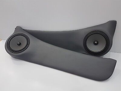

What's the source on that door pocket/speaker enclosure?
Fleabay and it came out of Aussie land.
