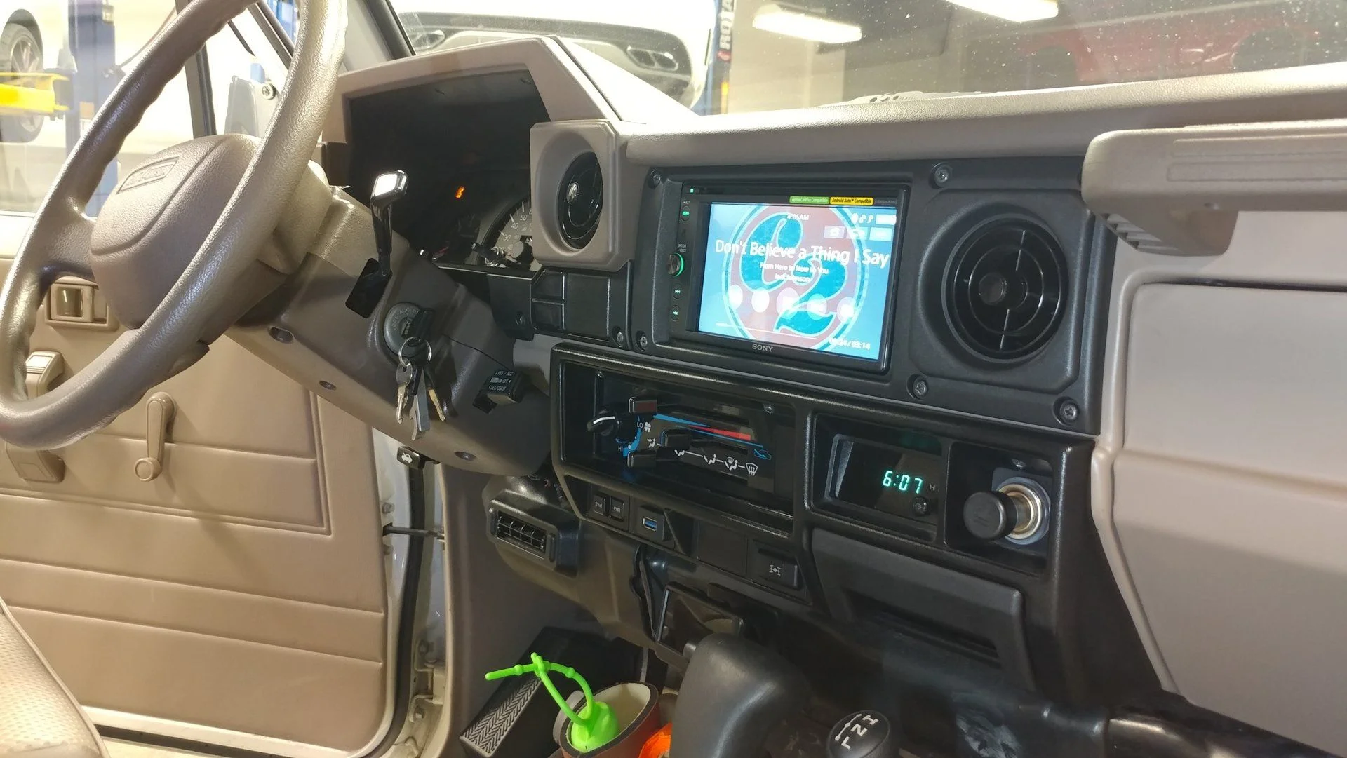

I went with a Sony AX200 on my LC79 primarily because it has a volume knob.....I hate fiddling with buttons for volume. Easier to deal with a volume knob....probably a sign I am getting old. It has Carplay and Android Auto. Nice system but the screen is tough to see in certain light...my only gripe with it.

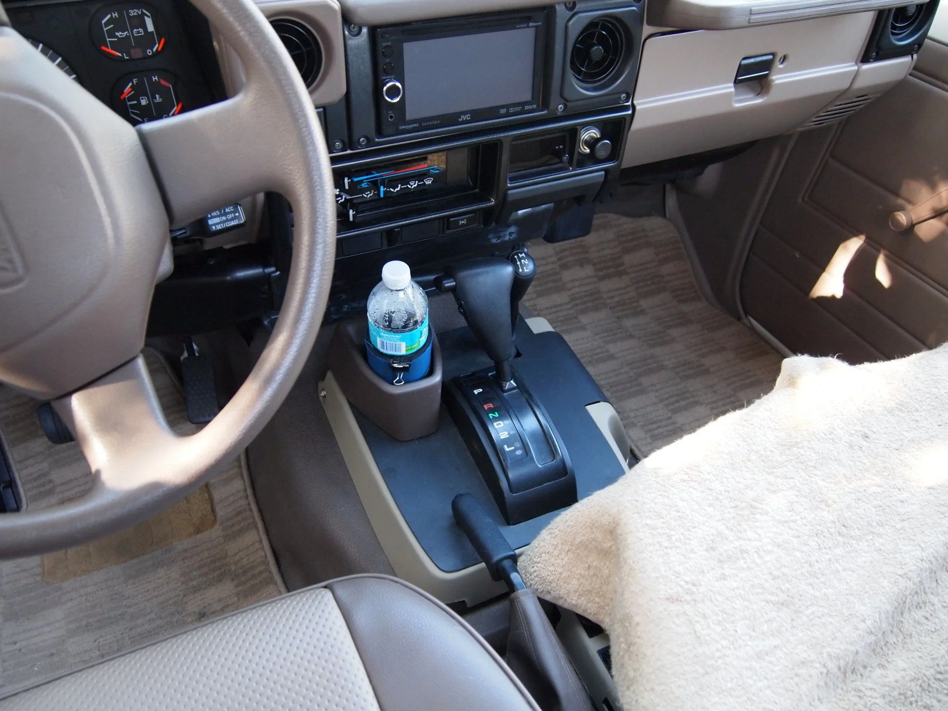

This was my JVC setup....really nice simple unit. No Carplay or Android Auto on it but I'm sure that's available now. Again with the volume knob.....I like them.

I miss my JVC in the 79....I feel like I downgraded with the Sony. It's a great system but I hate the screen. I could always see the JVC.

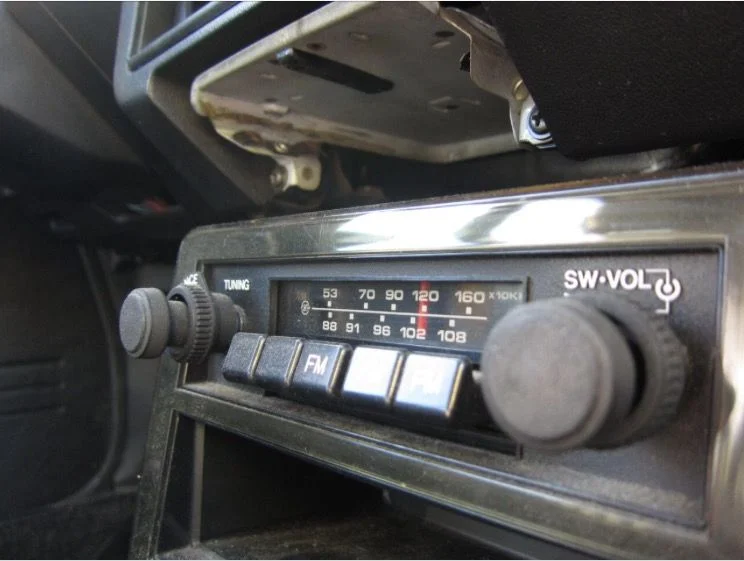

You'll find that this will fit with room to spare and although I'm not sure about Apple Play it does have FM play as well as AM play. Part time static is provided at no extra cost.
1914534
@lazylfarm My wife made that comment when I told her about putting a good stereo system in the Troopy, So I will just find a rag or make a custom Kydex cover that covers the face of the radio. Anyone have any suggestions ? Mike
