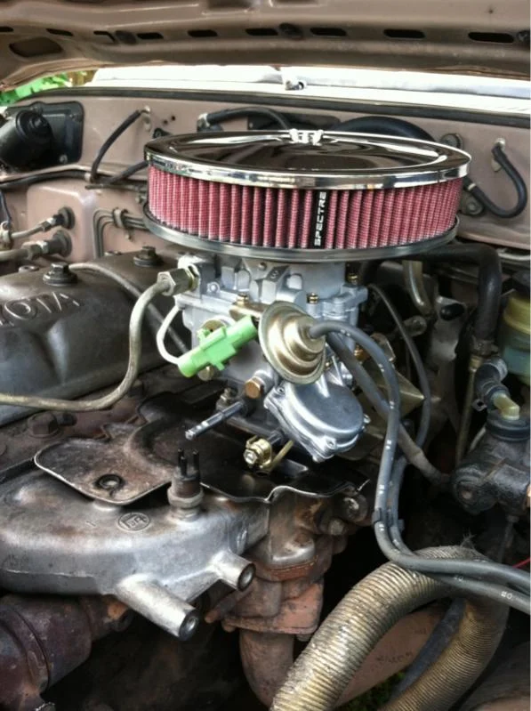

Just installed the carb it runs great just adjusted the idle.Haven't finished the a/c idle up yet the screw was stripped and the fuel cut off was so easy to adapt the stock connector.

Autozone. I had to do some trimming on the adapter and bottom assembly and it's a tight fit but sounds and runs great. If you need part numbers I can post them tomorrow.

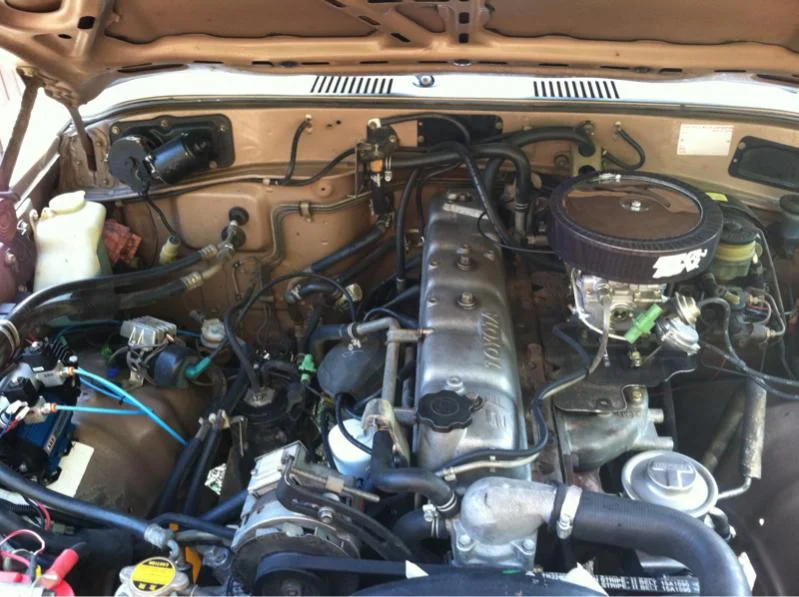

Looks good!
Make sure to plug up the part I circled in red.
Big vacuum leak otherwise.
A short length of hose on two ports and one cap on the other will do the trick!
Please do!
Jul 18, 2009
313
Part #'s
Spectre air cleaner adapter 3 1/16 to 5 1/8 #4953
Spectre air cleaner assembly #47708 ( this is the lifetime filter or for $10 less you can get the regular filter)
I trimmed about 1/4-3/8 off of both and the wing nut just hits the hood so now I have a regular nut I'll probably get the fancy one that's an option. I tried to find a drop base to even out the inch rise from the adapter but couldn't.
