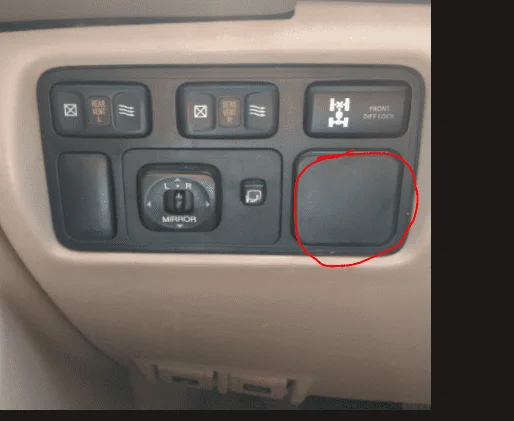

Guys I just want to point out that the dial switch takes the slot used by the night view switch
My plan was to punch this out and put the rotary knob here, does that not work? The switch knob hasn't arrived from ebay yet.
that is where the rotary knob is on my 98 and that’s the only place I’ve seen them in other trucks.

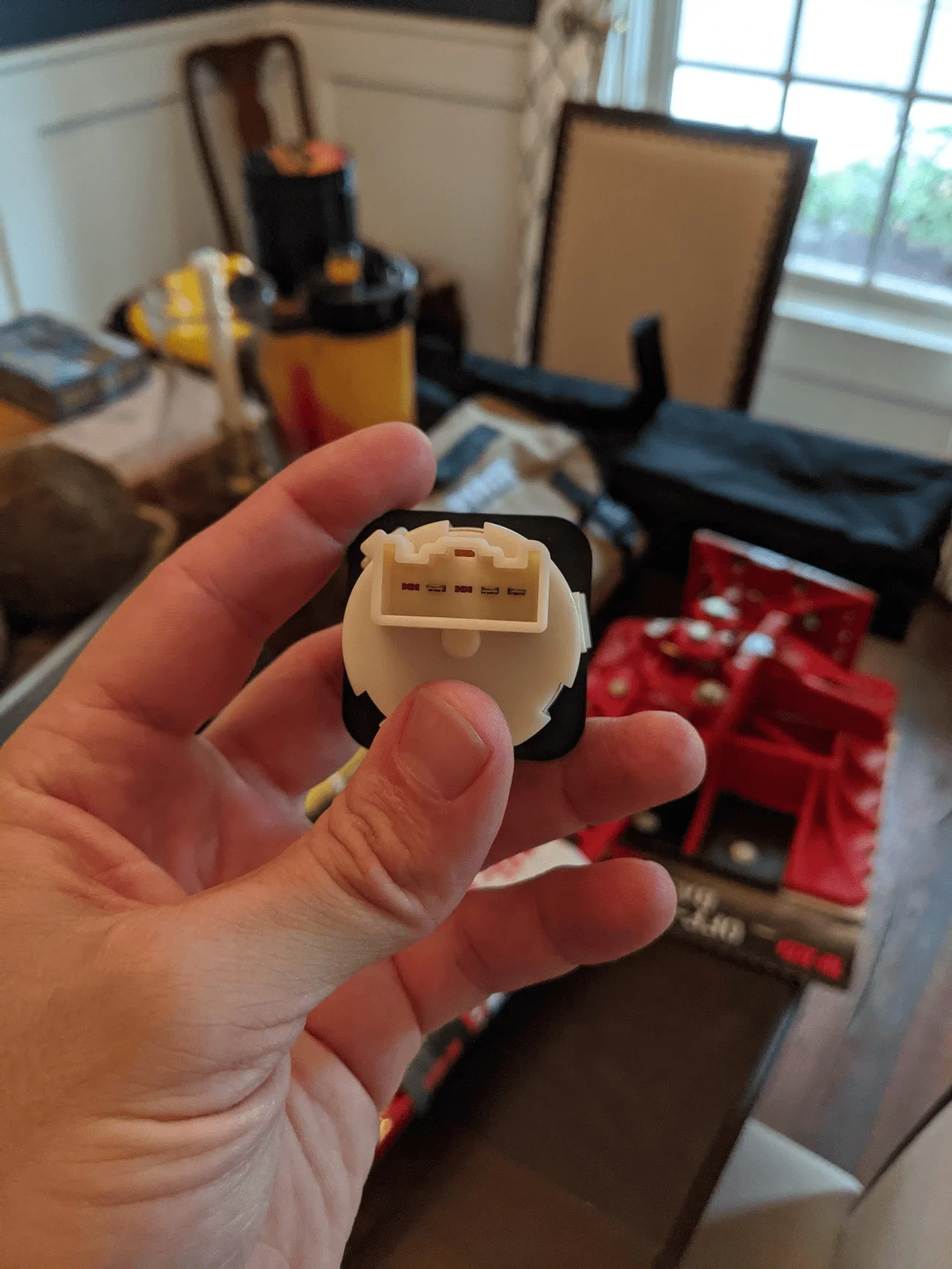

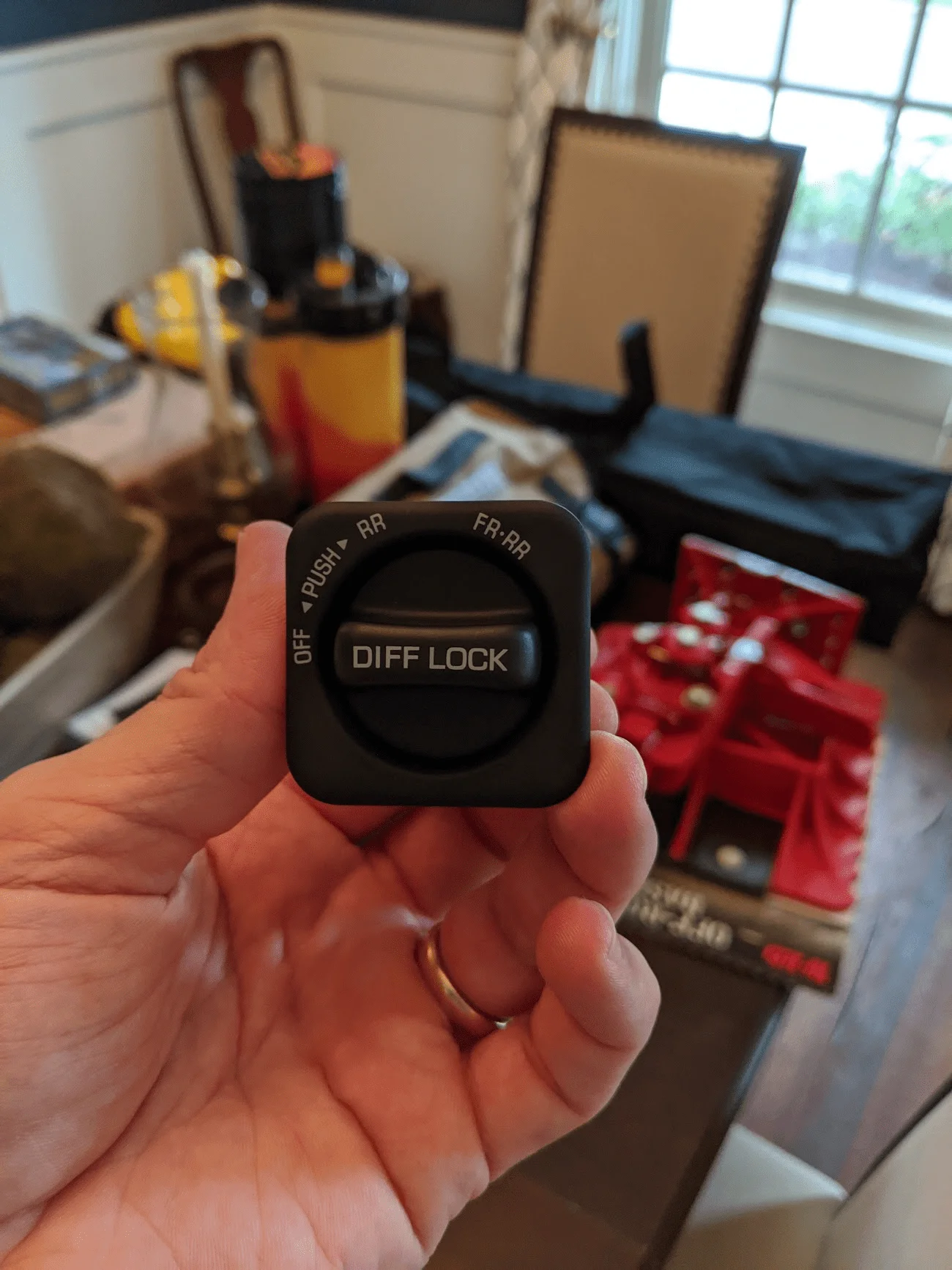

I finally got my rotary diff switch, does anyone know where to find a plug that fits in the back of this? This switch is much smaller than I thought and really high quality, I'm impressed with it.
I may be wrong but IIRC, @NLXTACY has a complete wiring setup with plug for that switch that is basically plug and play.
The OEM switch is awesome.
On my 2005 HDJ100 I reused the plug that goes into the switch as the plug was already in the harness behind the dash from the factory. That sent me on a wild chase if by some chance I also had the locker ECU, but alas it was just the plug. Apparently in Europe there was a super rare post-facelift trim with a rear locker.

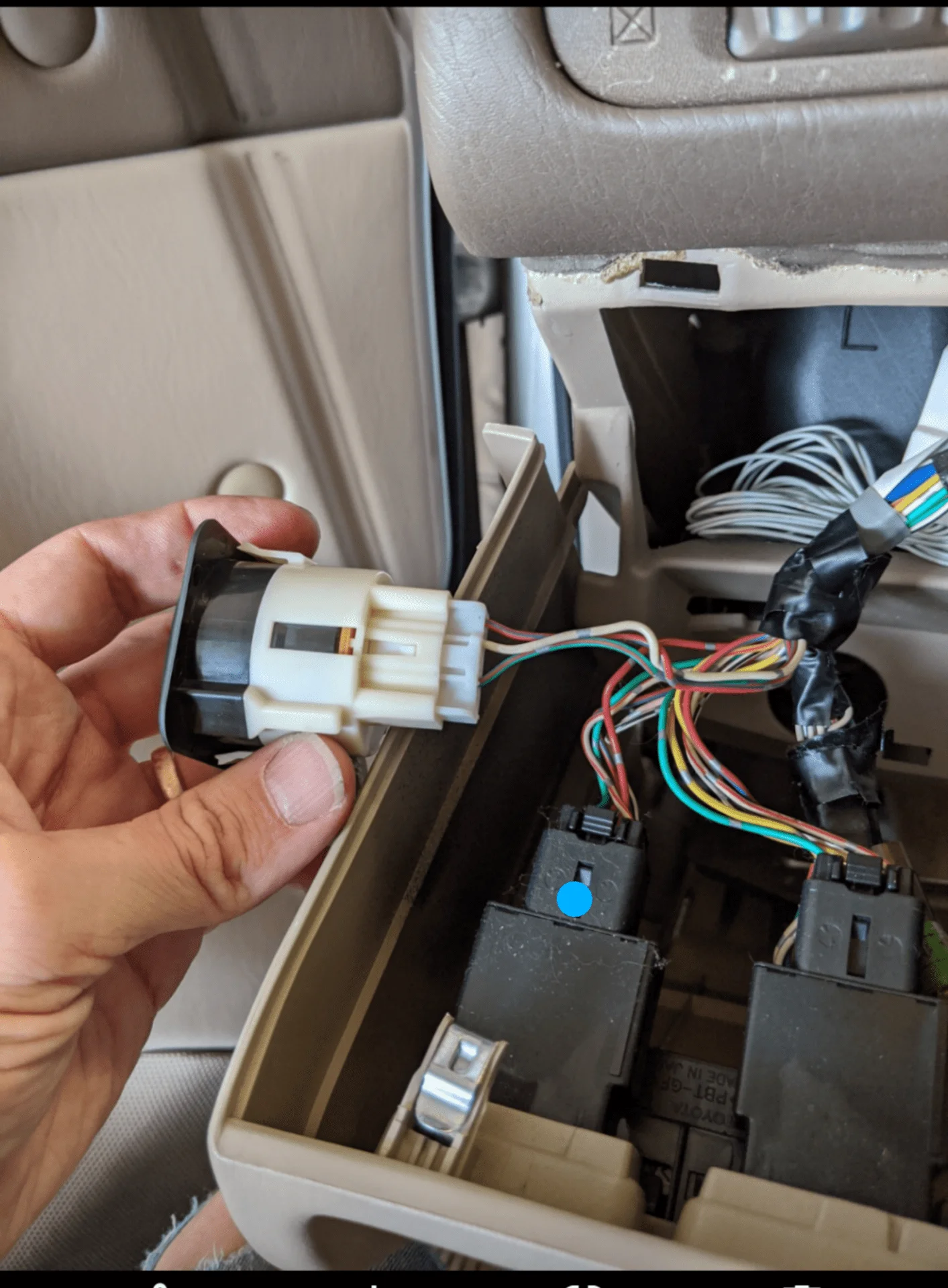

Um so this was unexpected, I removed the dummy panel and found the plug I needed with wiring just hanging out behind it. Question is, where do the wires go to???
Don't know the answer, but the computer/board that controls the locker is in the PS footwell, high and behind the fuse panel there. You may be able to track something down using wire colors from the EWD and see if it's plumbed over there.
To the place for the factory diff computer. As I wrote in the post above yours, the plug is there, the cables are there. The diff computer is located in the glovebox on the other side of the dash. Controls if you are driving at a safe speed to engage the locker, to show the light on the dash, etc. If you do not have a locker and a switch, you do not have the computer. Just the wiring. Cut the plug and reuse it.
Toyota reuses mostly the same wiring harnesses across trims so there are A LOT of unused plugs around the car.
Ok perfect, so leave the power wire and cut the two signal wires bc they don't go anywhere, correct?
