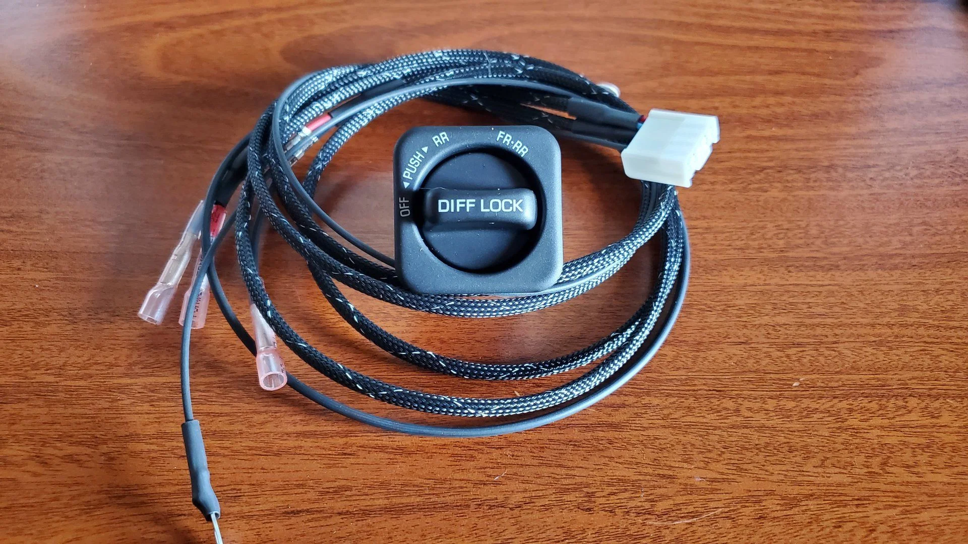

This showed up from Wit's End today. Thanks @NLXTACY!
The wiring harness is all setup for ARB compressor and solenoids which I do not have.
My plan is to use @sleelocker circuit board for the factory rear locker. I want to use the rotary switch to control both front Harrops locker and rear factory locker.

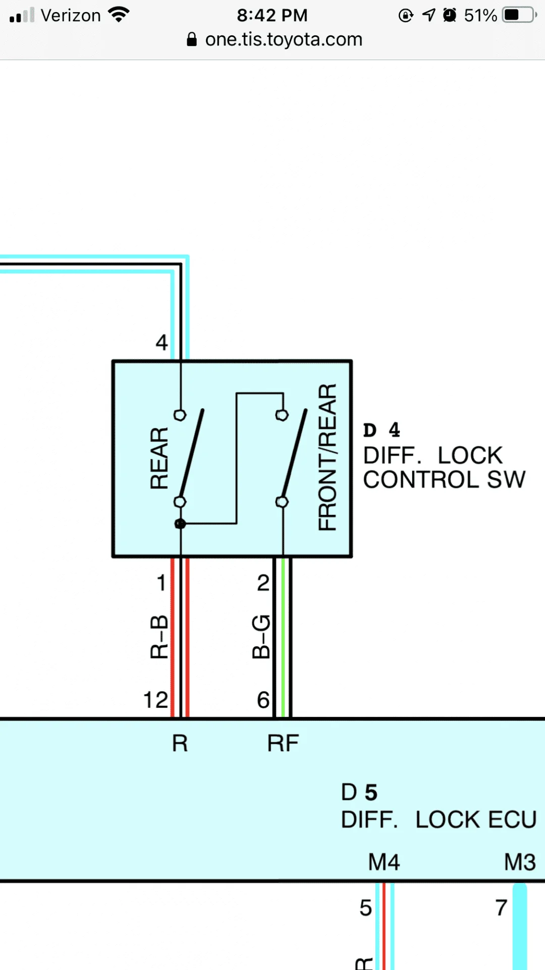

Does any one have pin out diagram for the rotary switch?
@Wermz is this something you have dealt with before?
Haha yeah ive wired that switch in my non factory locker truck, used it with my arb air lockers and 2 100-series with harrop/eaton e-lockers.. hang on, ill grab a screen shot of the wiring diagram..

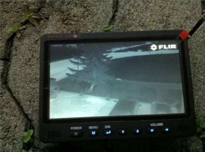

Night Vision was one of my not so important upgrades. Did use sunvisor monitors to made it more usable.
Was lucky to get a military spec flir (real thermal camera) device, which you usually dont get outside of the us.
Was planned for watching animals in africa, and to be able to drive without light at night...
It is pretty scary just driving with termal camera view... :rofl:

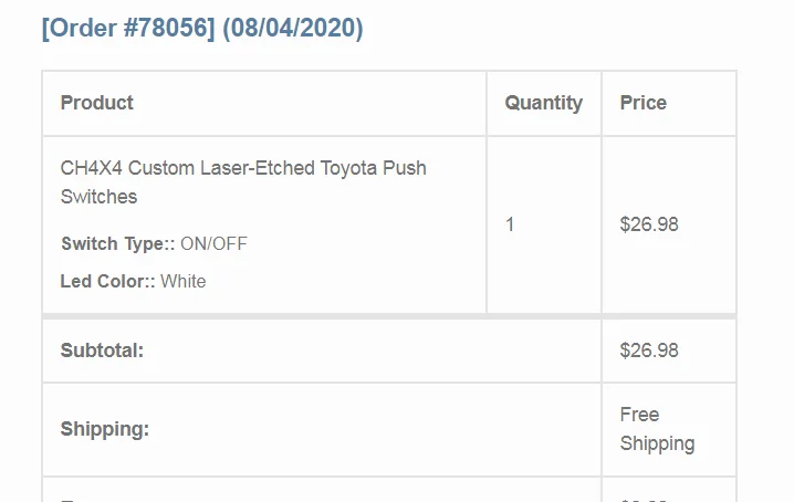

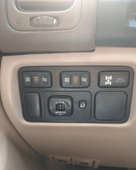

Here's an on off switch that I added. I plan to continue to lock the front independently from the rear.
www.CH4x4.com lets you custom design switch button covers.
Was this front diff lock a template they already had or did you have to find this image somewhere and upload it? I want this exact switch for the front, and I'll use rotary for the rear.
Thanks. I have the same plan with the two position rotary for the rear.
I just made it up from their "design a button" widget at the following link.

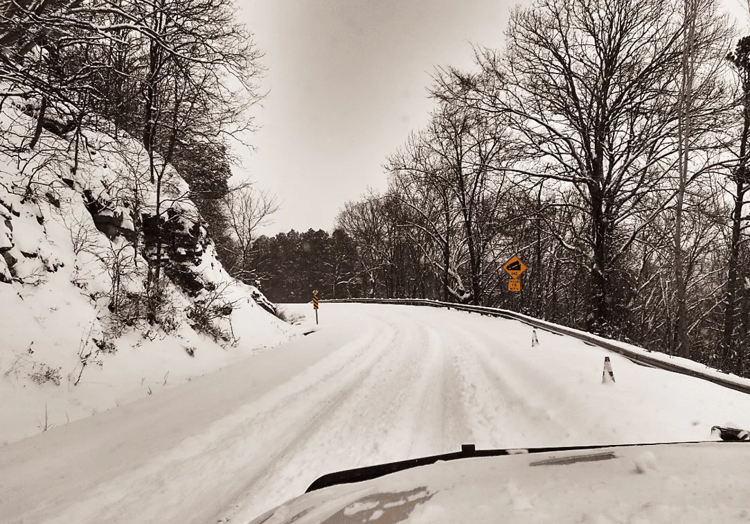

Today is the day when I was really got to use the front Harrop eLocker. It was a game-changer in a couple of situations.
1) I backed into a snowdrift covered hole and found I had one front wheel in the air. The rear wheels (LSD) were swapping traction back and forth and couldn't get enough bite to push the truck out of the hole. I hit the locker switch, then gently applied the accelerator then it pulled me out with the one front wheel that was touching the ground. I'm sure not being in snow would have yielded a different result. This was one of those "oh darn" moments that turned out good. I was really worried about how I would get out of that hole if the locker hadn't worked.
2) When climbing a snow-covered mountain road it performed very well. I could have done it without using the locker. Though it added significant stability, control, and reduced wheel spin. Just aim it at the destination and let it eat.
Here's a picture of the down side of the mountain

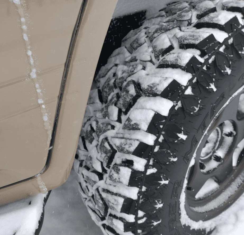

What tires are you running?
