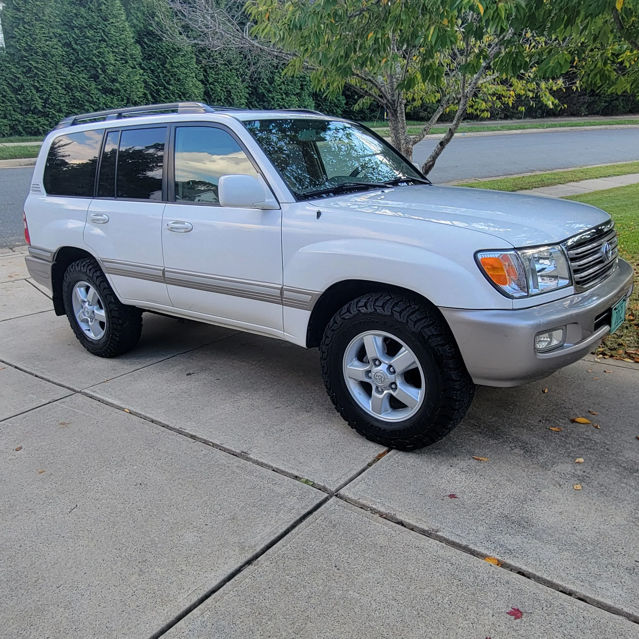

2004 LC100 non AHL with new BFG KO3'S and would like to go offroad at Uwharri in NC. I read a lot about triple lock upgrades. What are they, what do they cost and do I really need them. Any opinions would be appreciated. TIA

Just to put things in proper perspective.
You have a stock road rig on street tires that you want to visit a national forest with.
You are so far from needing lockers that it is hard to explain how far you are from needing lockers without sounding purposely harsh about it.
Enjoy the rig that you have, doing the things you want to do. No need for lockers.
Mark...
That rig is already overly capable for what's required. You're good. Plus it's an '04 so you already have a 4-pinion front differential
(One of the arguments for locker install up front is to shore up/strengthen 2-pinion front diffs in '98-'99) and you have the 5SPD auto
trans (that came in '03 and up). Good looking 100 :beer:

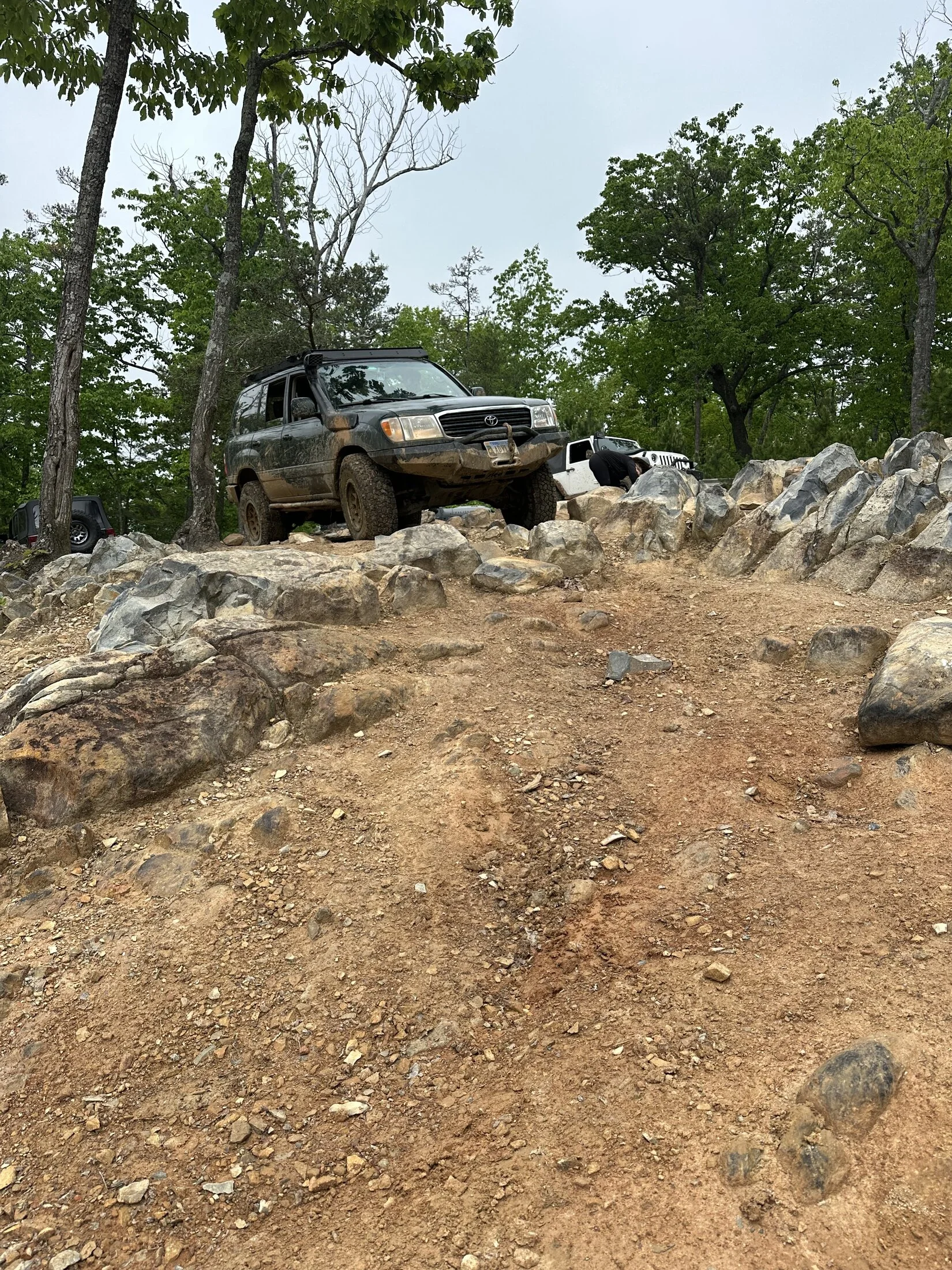

Been there, done that.
A 100 with ATRAC can do most of Uwharrie, except for (IIRC) Daniel and/or Dickie Bell.
The first time I used my lockers was at Uwharrie. The truck did great except for a slick rock section. That's where I learned how ATRAC can be better than a front locker in slippery sections.
You can do any trail at Uhwarrie (except Daniel) with your vehicle as is.
Did all of Daniel with just ATRAC and CDL no winching. Good spotting needed for sure. GX on 33s also made it! @Svensk120
