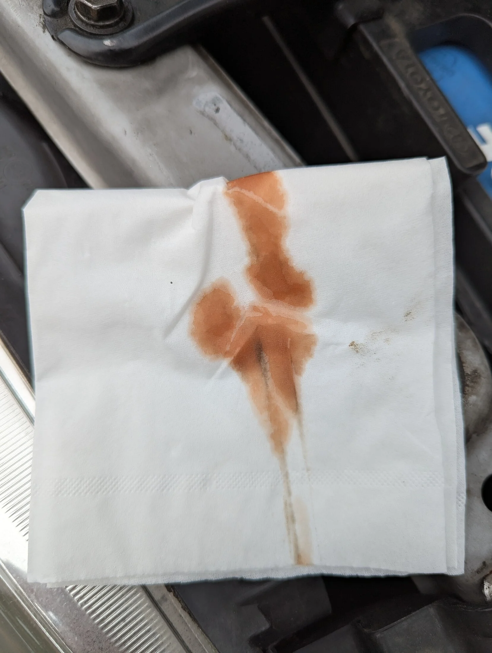

EDIT: I checked my transmission dipstick and the fluid is red. Does that mean I should wait until it turns black or whatever before doing the service?

This is a good sign. NO don't wait until it goes burnt. Service it now and be good for another 30-50k miles. The fact that it's not burnt will alleviate any concern that a fluid change may cause some issues.

There's no right or wrong. If I would be you, oil is red, the feeling between fingers is fine, no smell, no shifting issues, leave it!
