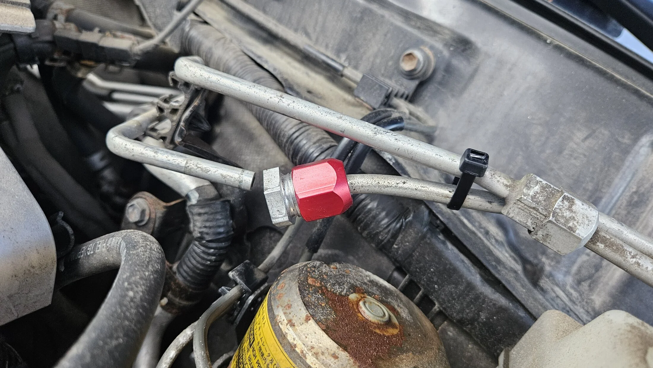

I did some testing tonight to see if I could figure anything out. Still at a roadblock and I am looking for help. :) Heres a few photos and videos I took just to give you a sense. A few things:
-The compressor wrrring isn't something I've recognized. Typically, it puts more load on the engine than it has been doing. My revs used to go from 0.5k to around 1.2k but not its like 0.5k to 0.7k.
-The cap on my high pressure side was never ziptied into place until tonight. Its possible it got the tiniest bit loose?? I want to say that it looks loose but I don't remember what it looked like when I installed it.

High Pressure side cap

Your system is low. You should have 40-50 psi on the low side when the system is running. When the system is off and the the high and low sides have equalized, you should have well over 100psi on both sides (actual pressure dependent on ambient temp). High side should be 250-350 psi when running. There is a low pressure switch on the low side that is set at approximately 38 psi. It is there to prevent the evaporator coil from freezing and to protect the compressor. If the pressure drops below this limit, it will release the compressor clutch until the pressure rises above the limit again. That it why your engine speed only increases slightly for a couple of seconds, then goes back down. Your system is short cycling, due to a low charge. You have a leak. A leak at one of those flared caps would be my first suspect. If you don't have access to leak detection equipment, get a can of 134a with dye and a cheap UV flashlight. That will help you find it. You'll need access to a dark garage for this to work, unless you have a high power UV light, which isn't cheap.
